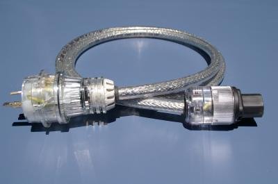

realysm42 Posted January 8, 2020 Posted January 8, 2020 I've got a good quality power lead that I'd like to recycle, to do so I need to remove the Schuko plug that's attached and fit an Australian plug. I don't want to spend millions on one (so the blingy Furutechs are out), can you guys please point me to reasonable alternatives that are better than cheapo generic junk? I'm happy to spend ~$60 maximum on it. Also, is it safe to rewire a plug that had two wires (Schuko) to Australian (three). As you can tell I'm a noob with this so don't know much about it and want to remain safe first and foremost. Thanks for your help in advance.

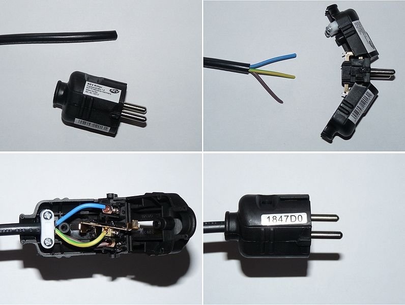

realysm42 Posted January 9, 2020 Author Posted January 9, 2020 In my first post I was trying to be detailed and seemed to have caused more confusion so I apologise for that; I meant a two pin plug (Schuko) to a three pin (Australian) plug. Really all I'm asking is it safe to convert a mains lead that is currently wired as a Schuko to an Australian plug.
Mungbean66 Posted January 9, 2020 Posted January 9, 2020 (edited) 6 hours ago, realysm42 said: Really all I'm asking is it safe to convert a mains lead that is currently wired as a Schuko to an Australian plug. As others have mentioned these are your definitive answers: Is is safe - Probably, as long as it’s done correctly. Is it legal - No You need a electrician to do the cable change for you (eg. replace the cable to the equipment with a 3 pin). You could also get a tech to install a IEC connector into the chassis but even then that is probably pushing the boundaries as it was engineered for what is currently installed. Best to leave as is IMHO. Edited January 9, 2020 by Mungbean66
andyr Posted January 9, 2020 Posted January 9, 2020 7 hours ago, realysm42 said: In my first post I was trying to be detailed and seemed to have caused more confusion so I apologise for that; I meant a two pin plug (Schuko) to a three pin (Australian) plug. Really all I'm asking is it safe to convert a mains lead that is currently wired as a Schuko to an Australian plug. You have explained that the current mains plug (its make is irrelevant) is a 2-pin plug. From this, we have to assume the wire from the present mains plug to the component only has 2 wires. Perhaps you could tell us what component this mains wire is plugged into? Your problem is that: Oz mains plugs normally have 3 pins. this implies they generally use 3-wire cable - the 3rd wire being an earth wire. this 3rd wire is there for a purpose - so if you simply use a 2-wire mains cable with a 3-pin plug ... you are doing without a 'safety earth'. Andy
Hytram Posted January 9, 2020 Posted January 9, 2020 Schuko plugs are Active, Neutral and earth.. 3 wires Therefore an Australian 3 pin plug should be OK as long as your cable contains 3 conductors and the appliance end is a 3 pin plug too.. Wiring it will require knowledge because getting it wrong could not end pretty. Post up some photos of it and measure the diameter of the cable and I might have some recommendations and a cheap legal way of swapping it over.

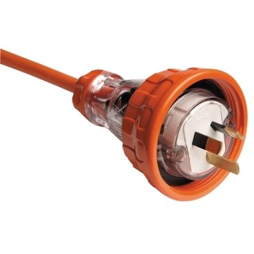

Hytram Posted January 10, 2020 Posted January 10, 2020 (edited) after termination thousands of clipsal and HPM products over the years my money is with clipsal, it just feels better to work with but I have never had a technical or safety reason to choice one over the other.. as for Delta could count the times I have used them on one hand, and plan to keep it that way.. another option is the 56P310 from Clipsal as it will take a larger diameter cable and upto 6mm2 conductors https://www.clipsal.com/products/detail?CatNo=56P310&tab-document-1=0 just remove the captive ring R K Cables use them for their Hifi Power cables http://www.rkcable.com.au/RKCABLE15.htm Edited January 10, 2020 by Hytram 3
ThirdDrawerDown Posted January 10, 2020 Posted January 10, 2020 On 08/01/2020 at 5:50 PM, andyr said: you are legally required to have a licenced electrician do the plug swap Yer, this is one of the things about Australian wiring regs. Hey, I liked this from the R K Cables web site (my bolding of the description of "we took the ring off") Quote All new stock of R.K.CABLE 1.5 will be fitted with the new Clipsal 56p310 , it features a brass earth pin and the body has been refined for easier handling 1 1

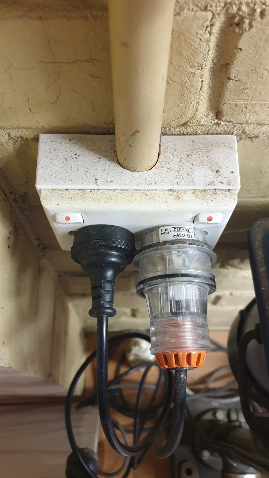

Hytram Posted January 11, 2020 Posted January 11, 2020 Didn't even realise that I had a Clipsal 56P310 in the shed. They are big, you won't get 2 of them next to each other and might be pushing to get anything next to it.. Plug next to it is a standard 3 pin plug off a C13 appliance lead. 1
