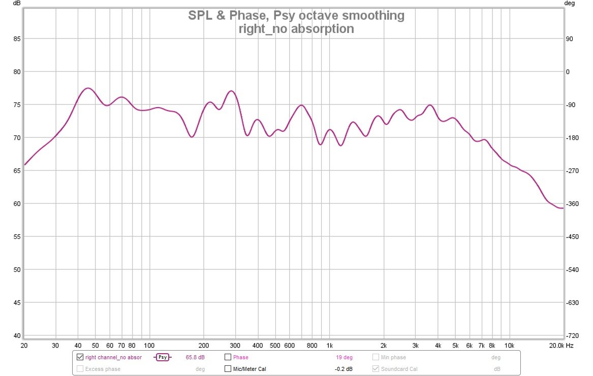

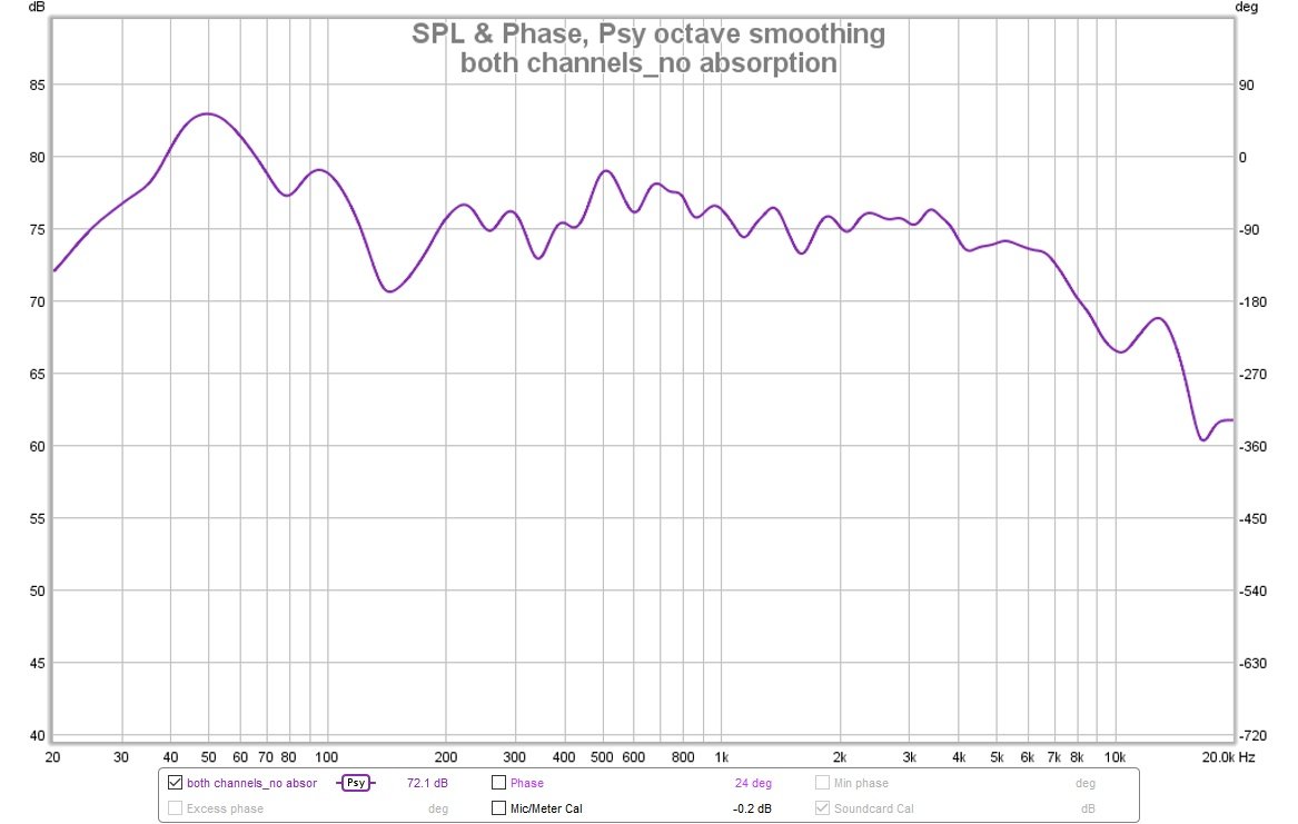

danwilyams Posted February 22, 2019 Posted February 22, 2019 Hi all, Hoping to get your thoughts on the likely reason for my DIY speakers (Zaph SR71 – https://www.stereo.net.au/forums/topic/62086-zaph-sr71-my-first-decent-speakers/) sounding not quite right to me. I am mostly very happy with the speakers and I don’t think this is related to a significant issue such as a miswired crossover, out of phase etc. I think its more likely just a case of the tonal balance not being to my taste. But being a well known and respected design I’m a little surprised that my experience doesn’t seem to match that of others I’ve read online. I’ll attempt to describe what I’m hearing.. It’s a slightly forward or brash sound. I can’t decide whether its related to the midrange or higher frequencies or somewhere in between but there is a slightly fatiguing character to the sound, perhaps best described as the opposite to a laid back sound. It is definitely more pronounced on certain types of music. I don’t really notice it with acoustic and vocal based music or electronic music. But it is very noticeable on rock music, electric guitars etc. I usually listen to a lot of heavy metal but not on these speakers... the tonal balance sounds just wrong, as if a load of low frequency energy is missing. Which seems odd because the speakers certainly put out plenty of bass and the tonal balance of tonally darker acoustic or electronic music sounds fine. I have experimented with absorption material (cushions) behind the speakers to remove reflections, as well as speaker placement. The former helped a bit and the latter helped quite a lot (I ended up placing the speakers closer to the rear wall than recommended by the designer, they are now about 20cm off the wall, which obviously boosted the bass). However, the underlying problem I have with the sound is still there. I have taken some measurements. The below plots are measured from the listening position. I am new to speaker measurement so let me know if different measurements or plots would be more helpful. Could the apparent (slight) increase in SPL around 2-5 khz (most pronounced in the right channel measurement) be a factor in what Im describing? Or the dip around 150-400hz? I am aware of the designer’s options for tweeter level adjustments and think I will try this next, however would be interested in any thoughts on whether there may be something else going on? Two things that have crossed my mind but hopefully you can confirm are unlikely to be the cause..1) I didn’t recess the tweeters quite flush, the tweeter flange sits about 1mm proud of the speaker baffle.. 2) the cabinet is made from 16mm MDF, I had planned to use 18mm but bought the wrong timber. The cabinet is fairly well braced (2 braces side to side and 1 brace front to back) but perhaps the thinner walls are creating a boxy sound? Equipment being used: Aries mini streamer connected to Musical Fidelity MS3i integrated. Cheers Dan
Al.M Posted February 22, 2019 Posted February 22, 2019 (edited) Have you allowed for woofers to run in after about 1-2 weeks. You could play it in a closed door room at moderate levels for a few days to speed up run in. The freq plots looks uneven around some freq like up around 600hz and then tweeter rolls off, which accounts for the tone balance you are hearing. Perhaps increase tweeter response to be more even. Dont think the 1mm recessing issue would do much. Try inverting the tweeter polarity and switching amp cable positive and negative. Edited February 22, 2019 by Al.M
danwilyams Posted February 23, 2019 Author Posted February 23, 2019 Hi AI.M, thanks for the response. I never really took much notice of the peak around 600hz because I thought that part of the range was closer to the low range / bass and therefore not contributing to my forward / brash sound issue. Am I wrong here - is 600hz in the midrange and possibly what I'm hearing? Yeah the speakers are 4 yrs old so well and truly broken in. I had dismissed the idea of a mis wired tweeter because I thiught that would result in a more obvious sound issue like 2 speakers connected with revers phase - but perhaps I need to double check the driver wiring to the crossover. is that high frequency roll off more steep than it should be? I have never thought that I'm missing out on high frequency / treble detail. Thanks
davewantsmoore Posted February 23, 2019 Posted February 23, 2019 On 22/02/2019 at 3:31 PM, danwilyams said: I have taken some measurements. Expand Nicely presented. A lot of what you see in the data is caused by the room, and the measurement technique.... and it is very hard to draw sweeping conclusions from this limited data (this is the first big lesson people get about "measurements", is you have to be very "skeptical" and "critical" of what you see, otherwise they tell you things which aren't really there) For the dip in the 100 to 400 range, you're seeing the room and not the speaker .... You can try moving the speaker and listening position to improve this ... but it's not a problem with the speaker. Over about 5khz is almost certainly caused by the measurement distance .... You can confirm this by taking a measurement on the tw axis, at <1m Use a test track to try to ensure you have the speaker in phase ... and that they are an equal distance from the mic/listening position. If this shows up a problem (or your not sure) then we can look at the data (phase response, impulse response) to try and work it out. While it looks like there is "excess energy" at 3khz .... and everywhere else is "too low". What's actually happening is that the slight peaks (diffraction?!) at around 3khz, are not adding together. You can see this by looking at the L and the R measurments, and knowing that the combined measurement should be 6dB higher. eg. at 1khz, you have 70dB L and 70dB R and 76dB combined. Where at at ~3Kh (the peak) you have 74dB + 74dB = ~76dB (they should add to 80dB). In all, I don't think there is anything big to worry about here. Remember you cannot read too much into this limited data set (you would need to make heaps more measurements, to be sure what is what). Have a play with the tweeter level, and see what you think. 7 hours ago, danwilyams said: Two things that have crossed my mind but hopefully you can confirm are unlikely to be the cause..1) I didn’t recess the tweeters quite flush, the tweeter flange sits about 1mm proud of the speaker baffle.. 2) the cabinet is made from 16mm MDF, I had planned to use 18mm but bought the wrong timber. The cabinet is fairly well braced (2 braces side to side and 1 brace front to back) but perhaps the thinner walls are creating a boxy sound? Expand 1. This can produce a severe wiggle in the response.... but 1mm is pretty small. Don't worry. 2. Not an issue (or at least not causing what you're reporting) 2
davewantsmoore Posted February 23, 2019 Posted February 23, 2019 On 23/02/2019 at 12:11 AM, danwilyams said: is 600hz in the midrange and possibly what I'm hearing? Expand What I think is more likely, is that you don't have "excess energy at 600" .... You have a hole from 100 to 400. This hole is not part of the speaker .... but the room sound (reflections and cancellations). Try moving the speaker and/or the listening position, and taking lots of test measurements to see if it changes/improves, etc. Even if it doesn't improve, how it changes with the different location, can give hints as to the true root cause. With your listening distance (can you tell us also how large the room is, and where in the room things are located - looking for how close walls are the speakers/mic) you will have very low resolution in this frequency range .... even to the point where the data might be better "ignored" completely. 41 minutes ago, danwilyams said: because I thiught that would result in a more obvious sound issue like 2 speakers connected with revers phase Expand It should be quite obvious. Fire up a "phase test track" where it plays "in phase" which should be in the middle, and "out phase" which should sound very wide/diffuse. 41 minutes ago, danwilyams said: is that high frequency roll off more steep than it should be? Expand Take a quick measurement (of one speaker only) with the mic on the tw axis and less than 1m. 2

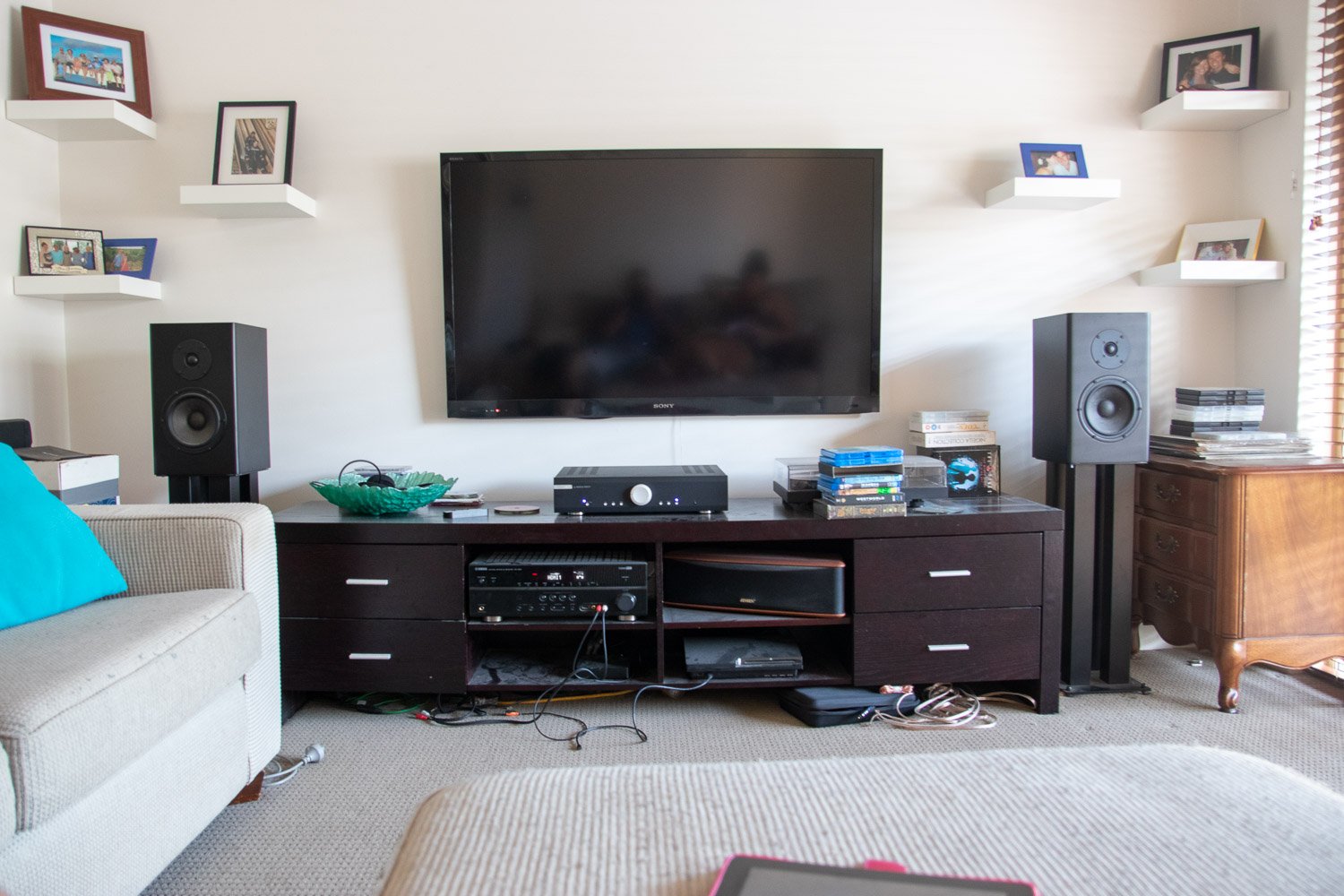

danwilyams Posted February 24, 2019 Author Posted February 24, 2019 On 24/02/2019 at 4:29 AM, acg said: it seems like something is closer to the left speaker than the right speaker, or vice versa, which is affecting how sound spreads into the room. An asymmetry, like a wall perhaps, or a partition Expand I've attached a photo which shows the room setup.. as you can see there is quite a bit going on around the speakers. the left speaker has a couch sticking out in front of it from the sidewall. The right speaker also has a piece of furniture temporarily stored beside it. behind the listening position is another ~1.5m to the back wall and there is a lot going on there also... an opening to a hallway and an opening to another room on the left hand side and a small hallway/front door opening on the right hand side. I've always suspected that the asymmetrical room setup (and particulalry interferance from the couch in front of the left speaker) could be contributing to poor room acoustics. Is it possible that placing the speakers on the TV cabinet, further away from the side walls and other sources of interference, would help? I will include this scenario when i next do some test measurements. On 24/02/2019 at 5:59 AM, davewantsmoore said: 's hard to know more without understanding what time window (if any) is applied to the data ... and so, what is th frequency resolution we're looking at. ie. is there a data point every 20Hz ... or every 200Hz ?! Expand sorry for all the questions but would you mind clarifying what you mean here? I will be taking some more measurements so want to make sure I understand these things (e.g. time window and frequency) whether they are measurement or display settings? Cheers
hollowboy Posted February 24, 2019 Posted February 24, 2019 On 22/02/2019 at 3:31 PM, danwilyams said: I am mostly very happy with the speakers and I don’t think this is related to a significant issue such as a miswired crossover, out of phase etc. [...] It’s a slightly forward or brash sound. I can’t decide whether its related to the midrange or higher frequencies or somewhere in between but there is a slightly fatiguing character to the sound, perhaps best described as the opposite to a laid back sound. It is definitely more pronounced on certain types of music. I don’t really notice it with acoustic and vocal based music or electronic music. But it is very noticeable on rock music, electric guitars etc. I usually listen to a lot of heavy metal but not on these speakers... the tonal balance sounds just wrong, as if a load of low frequency energy is missing. Which seems odd because the speakers certainly put out plenty of bass and the tonal balance of tonally darker acoustic or electronic music sounds fine. I have experimented with absorption material (cushions) behind the speakers to remove reflections, as well as speaker placement. The former helped a bit and the latter helped quite a lot (I ended up placing the speakers closer to the rear wall than recommended by the designer, they are now about 20cm off the wall, which obviously boosted the bass). However, the underlying problem I have with the sound is still there. Expand The woofer has a break up peak at ~4.5kHz The crossover is "Electrically, on the woofer we have a simple two component 2nd order network" ...this crossover should knock 15dB of f the peak, relative to the main signal level, but there may be enough left to disturb your listening experience. The peak seems to be visible in your (R) speaker plot. Could you try a sharp notch filter there to see if that solves the "fatiguing" character? The free/easy ways I know to do add a sharp filter (if you don't already have EQ ability) is to use a PC / laptop as the source, and download: Equaliser APO (free download) - adds layer of digital processing to all the audio, very customisable Foobar (free download) - music player to which you can add a 31 band eq. Not as flexible as Equaliser APO, but may be easier to use.
acg Posted February 24, 2019 Posted February 24, 2019 On 24/02/2019 at 10:10 AM, danwilyams said: Is it possible that placing the speakers on the TV cabinet, further away from the side walls and other sources of interference, would help? I will include this scenario when i next do some test measurements. Expand There is a lot happening near the speakers in terms of early reflections which would certainly be contributing to the spl response at the listening chair. If this was me, I would temporarily bring the speakers out into the middle of the room so they are still a couple of metres separated but do not have anything "in their face"......create symmetry...perhaps shift that couch some other nearby furniture out of the room for a little while. Toe the speakers in a little, sit at about 85% away from the speakers that they are separated (not quite isosceles triangle) and listen to them. The idea is to try to attenuate the speaker room and furniture interactions a little to see if they still sound brash. Take some more measurements. If they sound ok when you are getting a more direct sound then you've just found your problem and can work on a realistic solution. If they still sound brash after trialling a few different positions then it is likely that the speakers are the issue and perhaps look at what @hollowboyhas suggested above. Maybe even just try toeing the speakers in where they are may improve things a little. It is trial and error for a while I'm afraid. Of course, pack it all up and bring the furniture back in when you are finished, or there may be trouble...haha. 2
aechmea Posted February 25, 2019 Posted February 25, 2019 Pretty much what everyone else has said, but I will add my comments in support ... The L and R are so different that the room must be (almost) all of the problem. The combined response has a broad shallow dip from 120 to 450Hz. There is a lot of info in this range. Think voices, both male and female, left hand of the piano and probably stuff like cello ... You are missing the richness but as a consequence you are still hearing the brash bits at higher frequencies. The dip is very prominent in the L channel compounded by the lump at 50 and another at 500. If you can fix the L then you might be getting close. Trial and error is required. Lift them, twist them, move them, get the lounge out of the way (at least temporarily). At the moment both L and R are pointing straight ahead. You are actually listening off-axis. Not many speakers are "good" off-axis. Like others have rightly said, rotate them to point roughly at the listening chair. This also changes the reflection angles off the front and side walls which could be of benefit. Positioning is a powerful tool and even though an in-room response will never look perfect, it could be all that you need. When you have exhausted "positioning" improvements then a few dollops of EQ (done with a gentle hand) to lop off the remaining peaks and boost the shallow wide troughs will help a bit more. [I reckon that it's the lounge that did it! Blunt instrument trauma.]
davewantsmoore Posted February 25, 2019 Posted February 25, 2019 On 24/02/2019 at 10:10 AM, danwilyams said: Is it possible that placing the speakers on the TV cabinet, further away from the side walls and other sources of interference, would help? Expand Maybe. First, try turning the speakers. Start with pointing the speakers directly at the listener position. Then experiment with turning them further, so they fire at a point 1m in front of you. 14 hours ago, danwilyams said: I will include this scenario when i next do some test measurements. sorry for all the questions but would you mind clarifying what you mean here? Expand Yes. In short, measuring your speakers in a room has some big problems which conspire to make the types of charts you posted "unlikely the be the whole story" The "time window" refers to "how long the microphone listens".... and it's a massive trade off, because there are issues no matter what you do. In either extreme: 1. If the microphone listens a really short time: Data below a certain frequency is completely invalid (incorrect) The spacing between data-points is very long (eg. 1 data point every 200 Hz) The microhone stops listening before the sound reflected from the room arrives - meaning the data shows "just the speaker" 2. If the microphone listens a really long time Data is correct down to low frequencies The spacing between data points is short (eg. 1 data point every 5 Hz) The microphone hears the speaker, and all the sound reflected off the room - meaning the data shows speaker+ room. The problem with this, is that speaker+room, is different at every single point in space (if you move the mic/ears 10cm, you'll see a different result. REW is "room EQ wizard". By default it is configured to listen a very long time, so it captures all the reflected sound from your room..... and tell you about what's happening below ~300 hz (where the room dominates). So .... assuming you haven't adjusted the default setting (and your mic listened a long time) ..... when you "see a problem" in your measurement ..... You cannot say that it simply because of the speaker.... and we cannot immediately say that "fix the speaker design" (eg. modify the crossover, or EQ, etc.) is the solution. ie. anyone speculating to "fill in the hole", or "cut off the peak" using EQ (or a change to the crossover, etc.) is likely fairly misguided. In short, these "room" or "placement" problems are difficult to measure.... using EQ to fix them isn't simple, and usually isn't very effective. ----- That was a very long response, to something I don't think you should worry about too much. "Reading the tea-leaves" on your data ..... I think you should try two things. Aim the speakers at you at minimum.... or cross them in front of you. To experiment, you could turn them in 5 degree increments, and take a (2x) measurement (seperate L and R data) at each increment .... until they are crossing well in front of you. Overlay the charts and see what the trend it (and have a listen at each increment of course). Move the speakers away from the back wall, if you can. If you are up for it, I would recommend you try them out from the wall, even in positions which wouldn't be acceptable long term..... Just to see what they do to your measurements. Note: If you are taking more measurements ..... that you want to compare with the data you already have .... it's important to: Keep the microphone in exactly the same location Typically don't measure both speakers playing together. We almost always want to see the L and R speaker data separately - playing the speakers together is only useful for very specific things. 1
