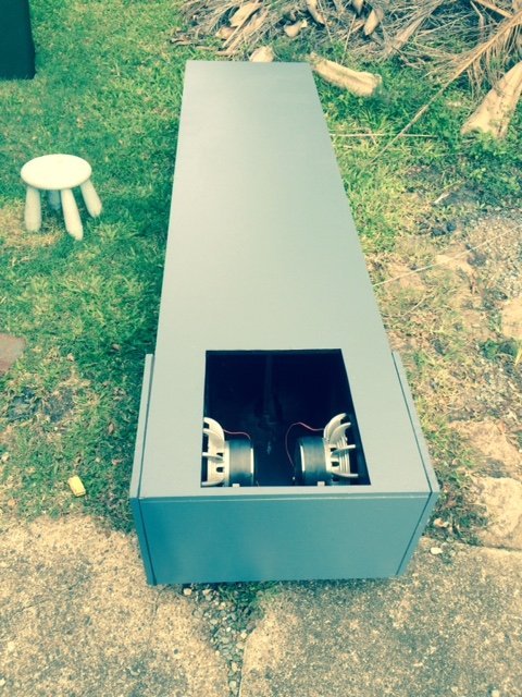

....like this is a "small" sub - my Redspade designed T20 sub (2400x400x300) after it was just finished and dragged outdoors to do some measurements
I pulled a muscle getting it outside on my own to make the measurements and had to call for help to get it back into the room.?
All humour aside, actually a design philosophy not too different to the "small" satellites in the OP's thread - achieve ~20Hz  bass with small (12") sub drivers and moderate power (370W per driver), yet provide decent SPL with reasonable headroom (excursion and amp power) to allow dynamics.
...Hoffman's iron rule for bass speakers at play - choose any 2 of 3:
  • low bass
  • high efficiency
  • small box
Clearly this sub design chooses low bass and high efficiency - I just had to build a big box (the easy bit).
In my small room, the T20 is barely ticking over even at elevated volumes (including movies) - it just adds that extended "weight" to the room bass response.
At the start I was paranoid about needing a high pass on it given it's a tapped horn (same as ported subs - very large excursion below tuning).
I took off the high pass and ran some measurements at decent SPL and kept an eye (and a finger) on driver excursion.
With no high pass filter, without excessive excursion, it was pretty flat to 15Hz at decent SPL.
I don't bother with a high pass now.
A colleague reckoned it was enough sub for a small commercial cinema - not likely, but 2 of them would cope easily.
I've thought about running the drivers as 2 sealed subs, but the effortlessness of the T20 to hit low bass makes my lazy DIY gene kick in - it's already in the room after all.
cheers
Mike

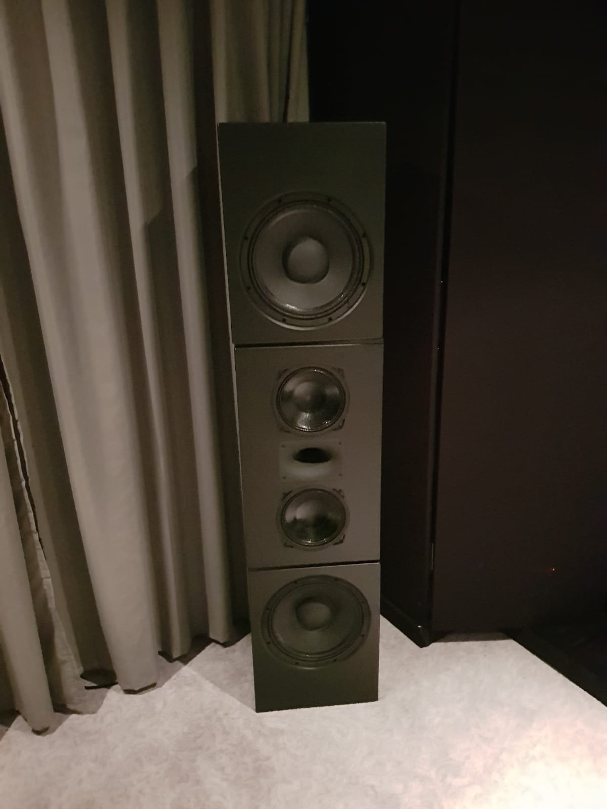

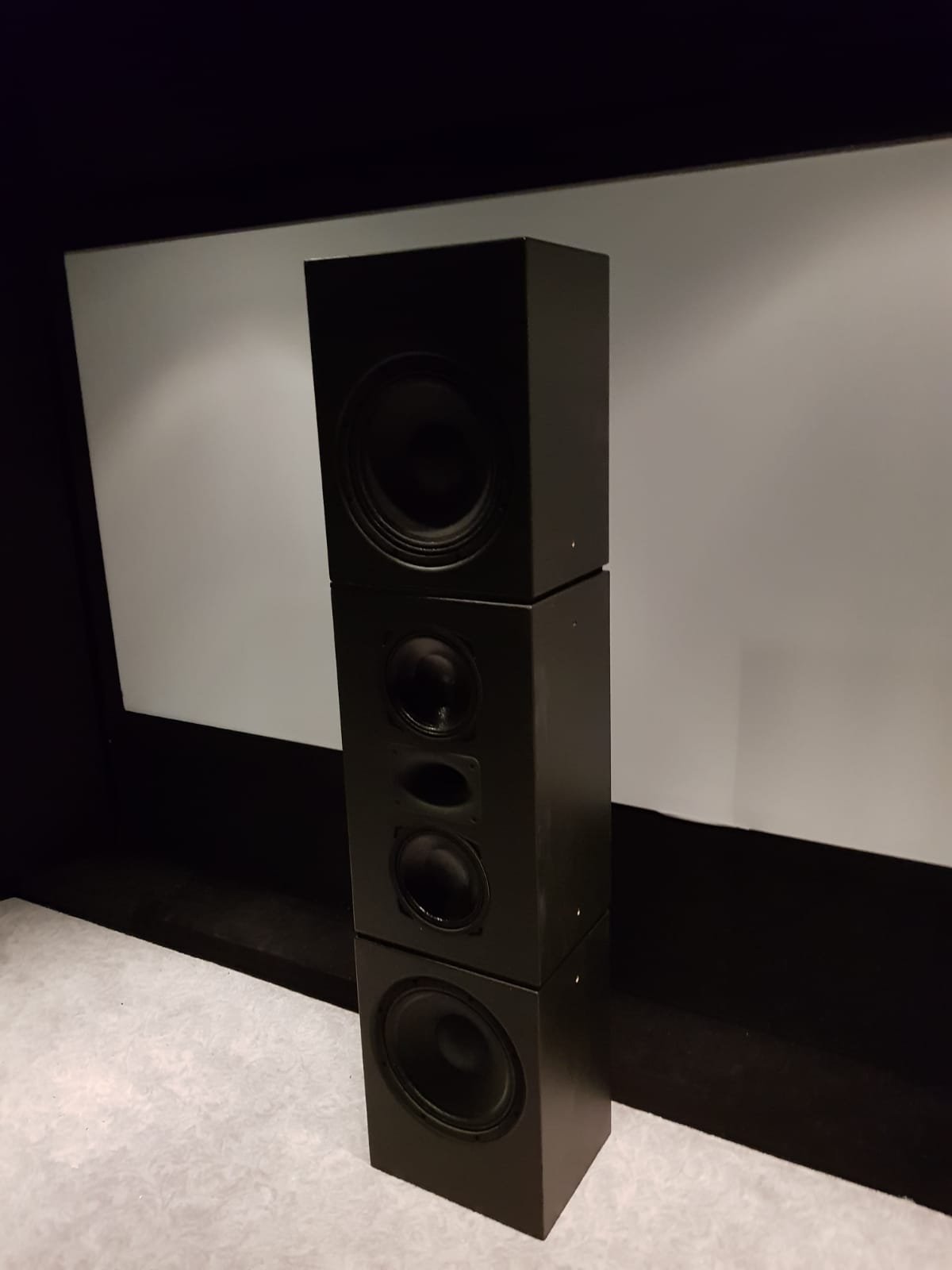

    All cabs finished:
  • superaaaa
    superaaaa
    Some pics of the finished product.
  • One of the design requests was modularity, hence all the boxes. Main reason was to keep the weight down, and make it easier for me to move.    Even still, each cabinet is still quite heavy -
  • Author

What is the weight of them...  The cat 12's are heavy enough, I was surprised how lite the amp was.
  • Author
It was about 300Kg for all 3.
The middle cabinet weighs the most at a bit over 40kgs. The two woofer cabinets are a little under 30Kgs each.
One of my design criteria to Paul was to make the speaker modular - mainly to make it easier to move around. Despite that, I think I'll need to do a few push ups before these arrive.....
Yeah they Amps don't weigh too much on the CATS. I don't even think the drivers weight a lot. Its the construction of the cabinet. I think the CATs are around 60kgs each.

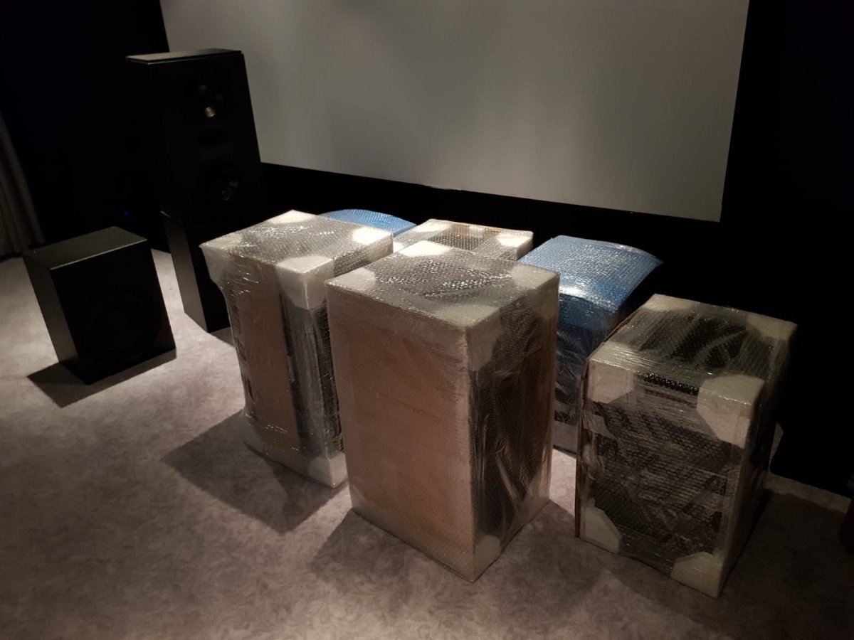

Look what arrived..
  • Author
The packaging done by Paul was insane. Took my awhile to unbox it all.
  • Author
Even still, each cabinet is still quite heavy - especially the middle cabinet with the amp.

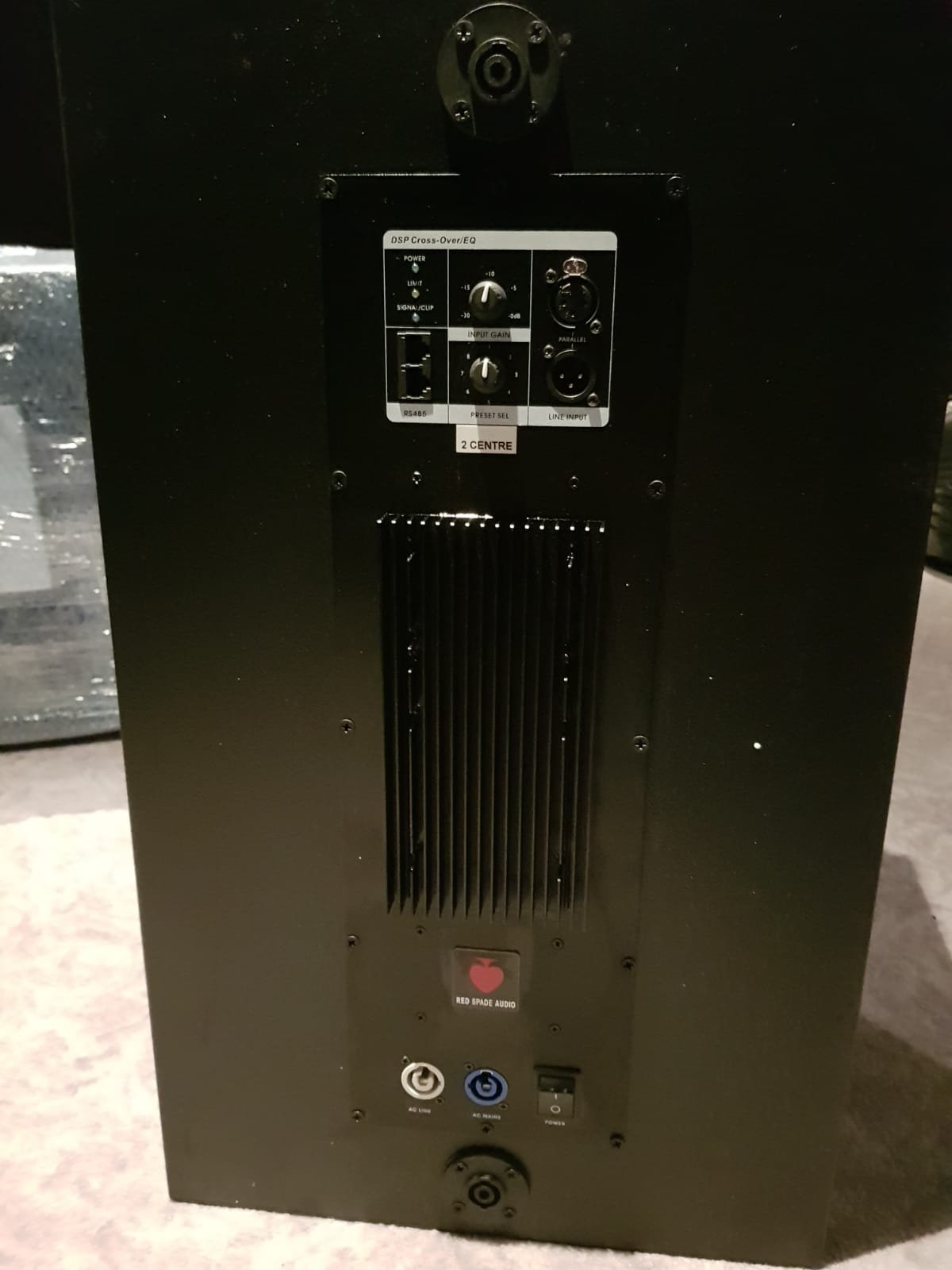

People were asking about the amp with built in DSP, here is a photo. Wont help identify it though.
What are the amps rated at.  Any thing like the Cats.    D class?  I was surprised how lite the Cat amps were.
  • Author
250/500/500W class d.
The crossover for Pauls speaker is 3 way active.
The seatons are 2 way active (woofer to mid/tweeter). The mid/tweeter crossover is passive.

Didn't realise that they do resemble the Triad Platinums.  Both are a WMTMW design.
But the triads use soft dome tweeters, where as these are compression drivers.
