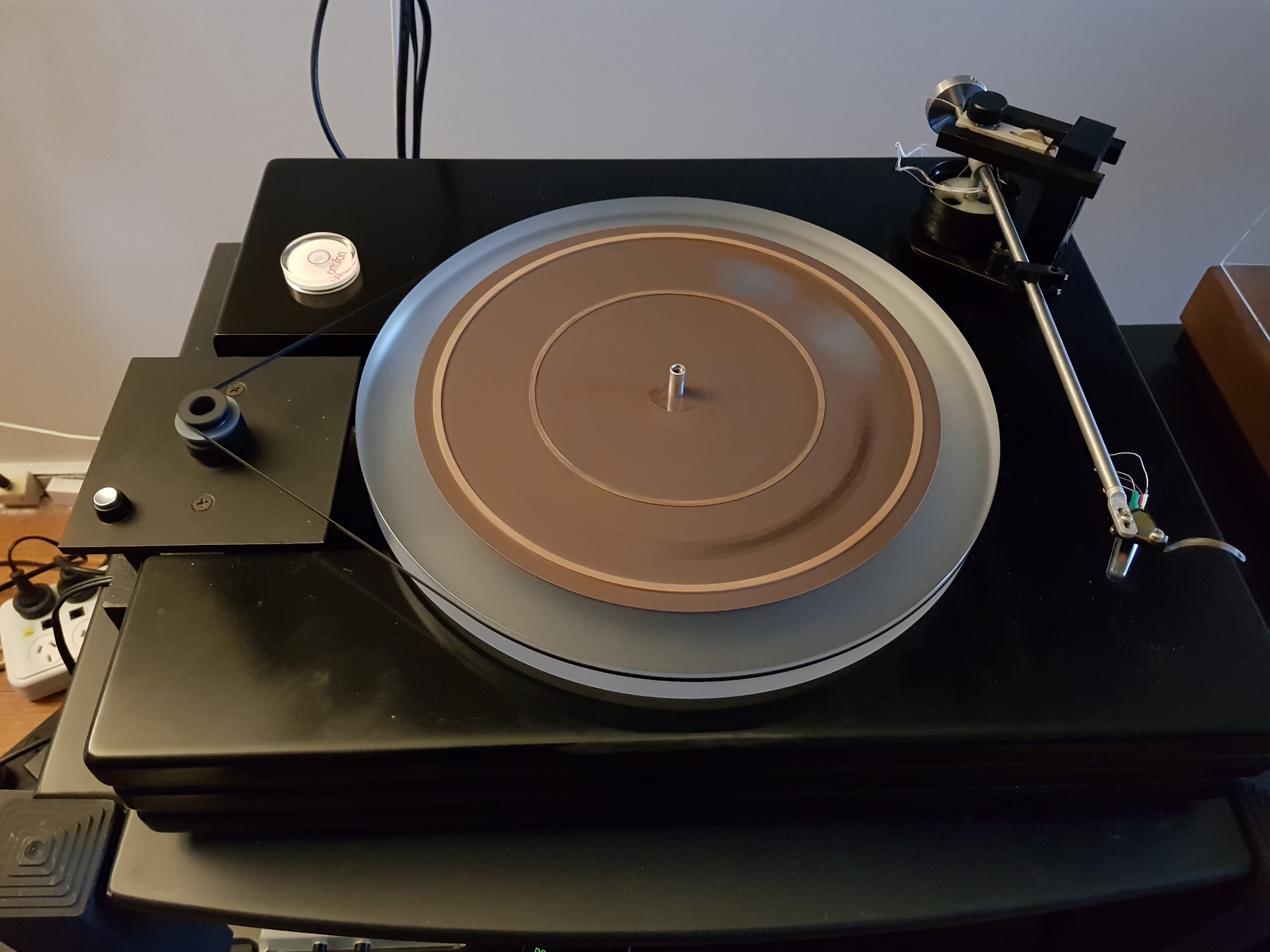

mloutfie Posted July 23, 2017 Share Posted July 23, 2017 @TOPSHELF how's your belt tension? It appears to be really important because of how the bearing is designed to have the right tension to keep the platter from wobbling. Mine is supposed to be newly replaced but doesn't seem to have enough tension. I have to distance the motor from the table quite a bit like this photo to get the right tension. I use 40w motor oil for the bearing well and the level is just enough to cover the top plastic bearing point. Link to comment Share on other sites More sharing options...
TOPSHELF Posted July 23, 2017 Author Share Posted July 23, 2017 Hi@mloutfie that belt looks stetched i am able to sit my motor slightly inside of flush to the plinth. I changed my belt about 4 months ago and bought it off ebay for a very reasonable price. They also recommend to have a twist in the belt either side of the pulley leading to the plinth.Sent from my SM-G930F using Tapatalk 1 Link to comment Share on other sites More sharing options...
mloutfie Posted July 23, 2017 Share Posted July 23, 2017 34 minutes ago, TOPSHELF said: Hi@mloutfie that belt looks stetched i am able to sit my motor slightly inside of flush to the plinth. I changed my belt about 4 months ago and bought it off ebay for a very reasonable price. They also recommend to have a twist in the belt either side of the pulley leading to the plinth. Sent from my SM-G930F using Tapatalk Yeah I stretch it to get platter stability. Looks like actually I used 15w-40 oil and the recommendation seems to be 5w. What kind of oil do you use? Might try different oil. Mind taking pictures of the twist? Link to comment Share on other sites More sharing options...
TOPSHELF Posted July 23, 2017 Author Share Posted July 23, 2017 Yes i will take some pics tomorrow. When you say platter stability what do you mean? If i remove the belt the platter will happily sit level until i touch it and then it always tips down to the right. When i completely dismantled the deck including the bearing i accidentally put the female part back in the wrong orientation. From memory there are two grub screws on the shaft that can be screwed in and out one is higher than the other. These sit at 90 degrees to each other and i have mine located at 8 o'clock and 11 o'clock as you are stood facing the tt from the front the one at 11 o'clock is the higher one. I adjusted these grub screws so the spindle sits perfectly perpendicular in the hole when the platter is removed. It also means i put sideways pressure on the platter towards the 9 o'clock position when tightening the puck on a record. I'm not sure what the oil is but it seems thin. There is also another larger grub screw at the base of the same female housing which i replaced the ptfe tape on. This stops the oil from leaking and tightening the grub screw lifts the male spindle that fits within thus lifting the platter. When you remove the platter what does the spindle do? I think maybe the grub screws need adjusting to make it sit perfectly plumb within the female housing? Also what is the orientation of your grub screws? If you gently roll the spindle around in the housing 360 degrees you will feel where there is play and where it holds firm. Is the spindle perfectly vertical when it holds? I'll have a look for that spare belt as there was nothing wrong with it more i wanted to have everything new after the re-build. I'm happy to post it. Hope this helps.Sent from my SM-G930F using Tapatalk Link to comment Share on other sites More sharing options...
mloutfie Posted July 23, 2017 Share Posted July 23, 2017 53 minutes ago, TOPSHELF said: When you say platter stability what do you mean? If i remove the belt the platter will happily sit level until i touch it and then it always tips down to the right. Well it's will sit flat with no belt like yours but when the platter is spinning (by the motor) I just notice it today because I put it in the rack so the platter is on my eye level. It actually wobble to the right when spinning, back and forth from my experiment moving the motor around it seems the belt doesn't have enough tension to hold the platter still. That's why on the picture if I put the motor further away thus tensioning the belt more then the platter became stable while spinning. 1 hour ago, TOPSHELF said: These sit at 90 degrees to each other and i have mine located at 8 o'clock and 11 o'clock as you are stood facing the tt from the front the one at 11 o'clock is the higher one. I adjusted these grub screws so the spindle sits perfectly perpendicular in the hole when the platter is removed. It also means i put sideways pressure on the platter towards the 9 o'clock position when tightening the puck on a record. The Grub location sounds about right but how do you adjust the screw? do you take of the bearing housing? But I think as it stand pretty sure the spindle can stand in the hole perfectly without the platter. 1 hour ago, TOPSHELF said: Also what is the orientation of your grub screws? If you gently roll the spindle around in the housing 360 degrees you will feel where there is play and where it holds firm. Is the spindle perfectly vertical when it holds? It's the same at 8/11 o clock spindle also perfectly flat with platter on and without the belt put on so it looks all good stationary. My feeling keeps points to belt tension considering the platter is stable when I put the motor further away. which ebay store did you get your belt from? Thanks a lot for all the info Link to comment Share on other sites More sharing options...

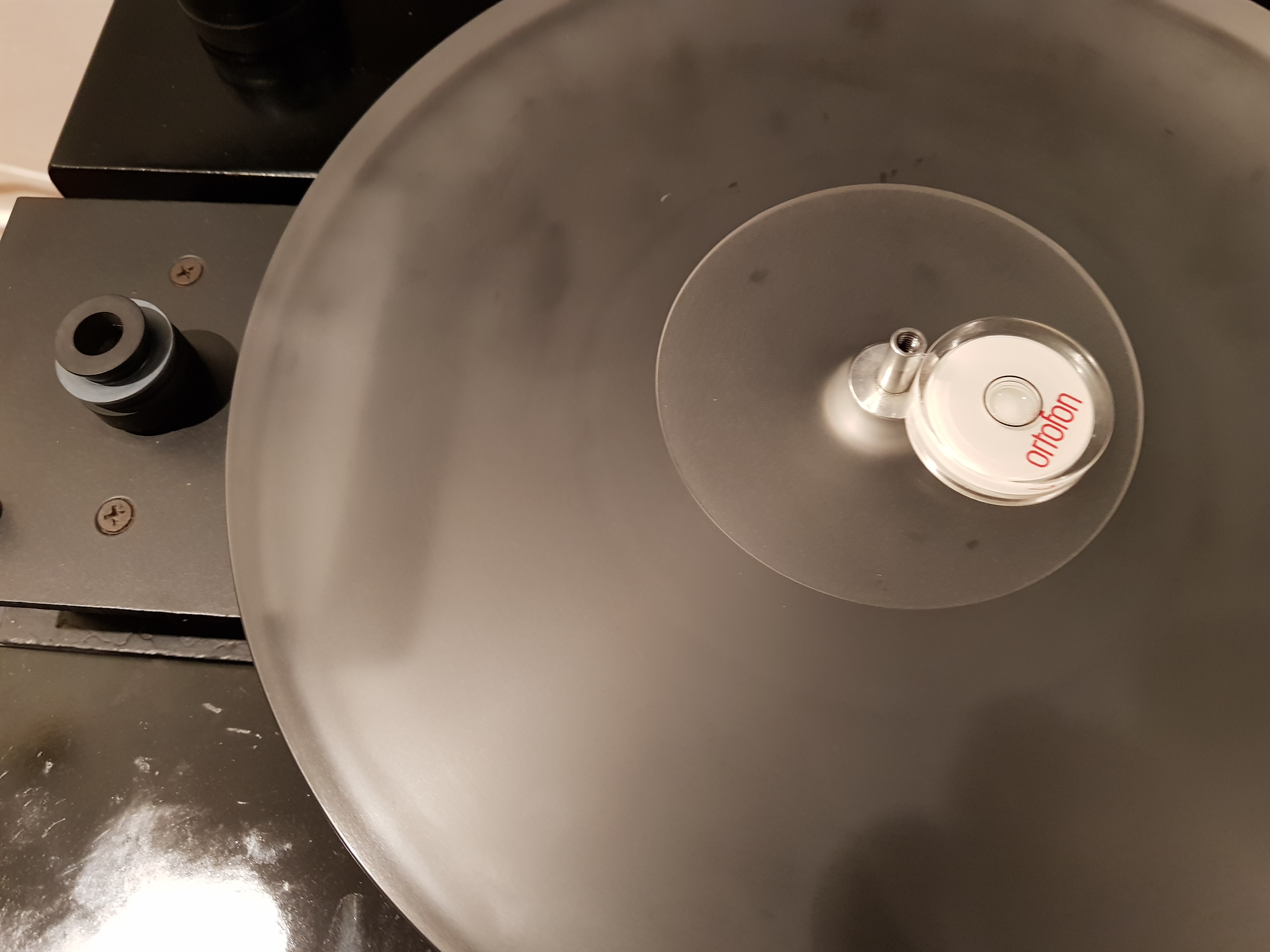

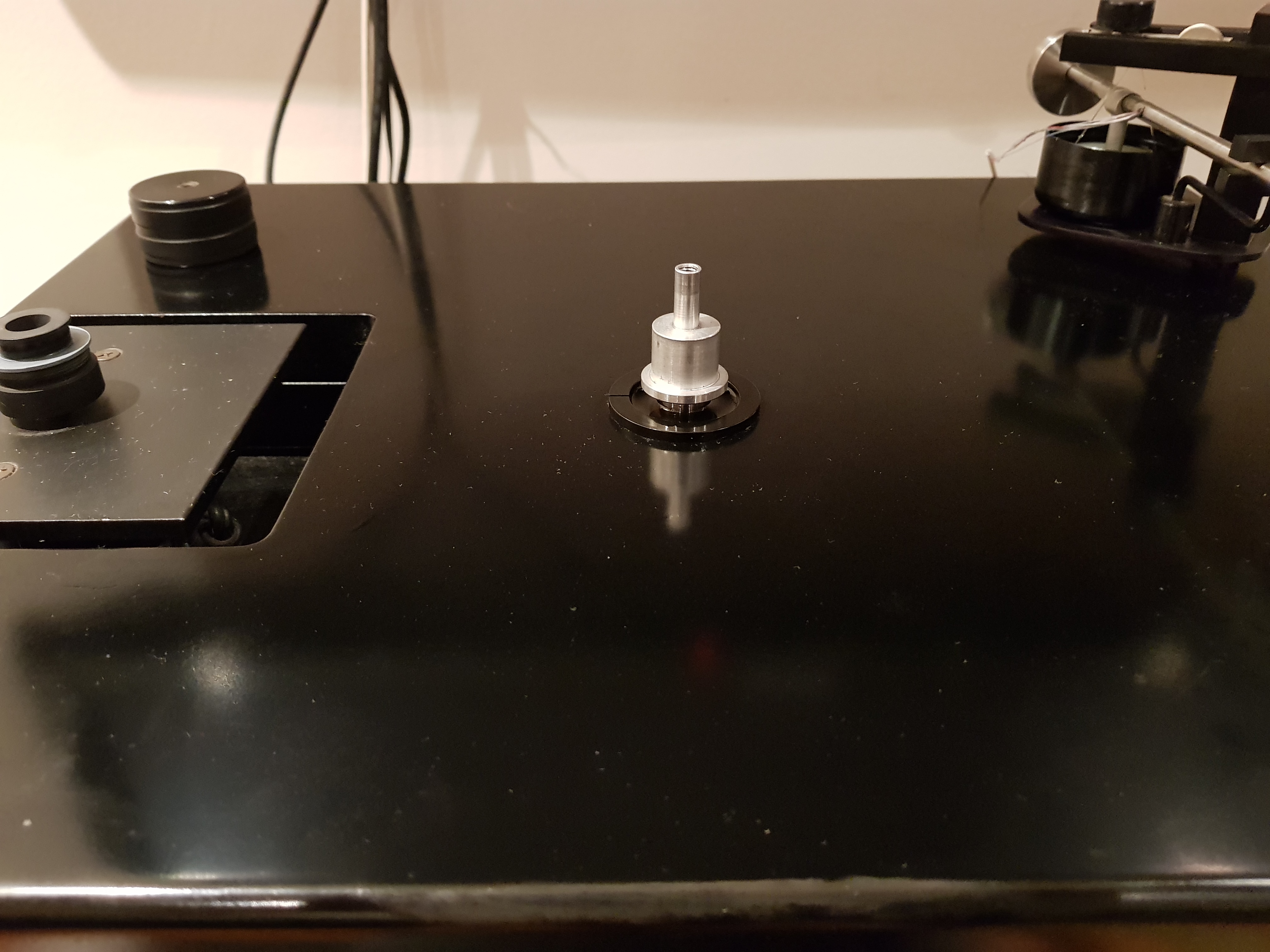

mloutfie Posted July 23, 2017 Share Posted July 23, 2017 Here's some pics of the spindle and platter without belt attached Link to comment Share on other sites More sharing options...

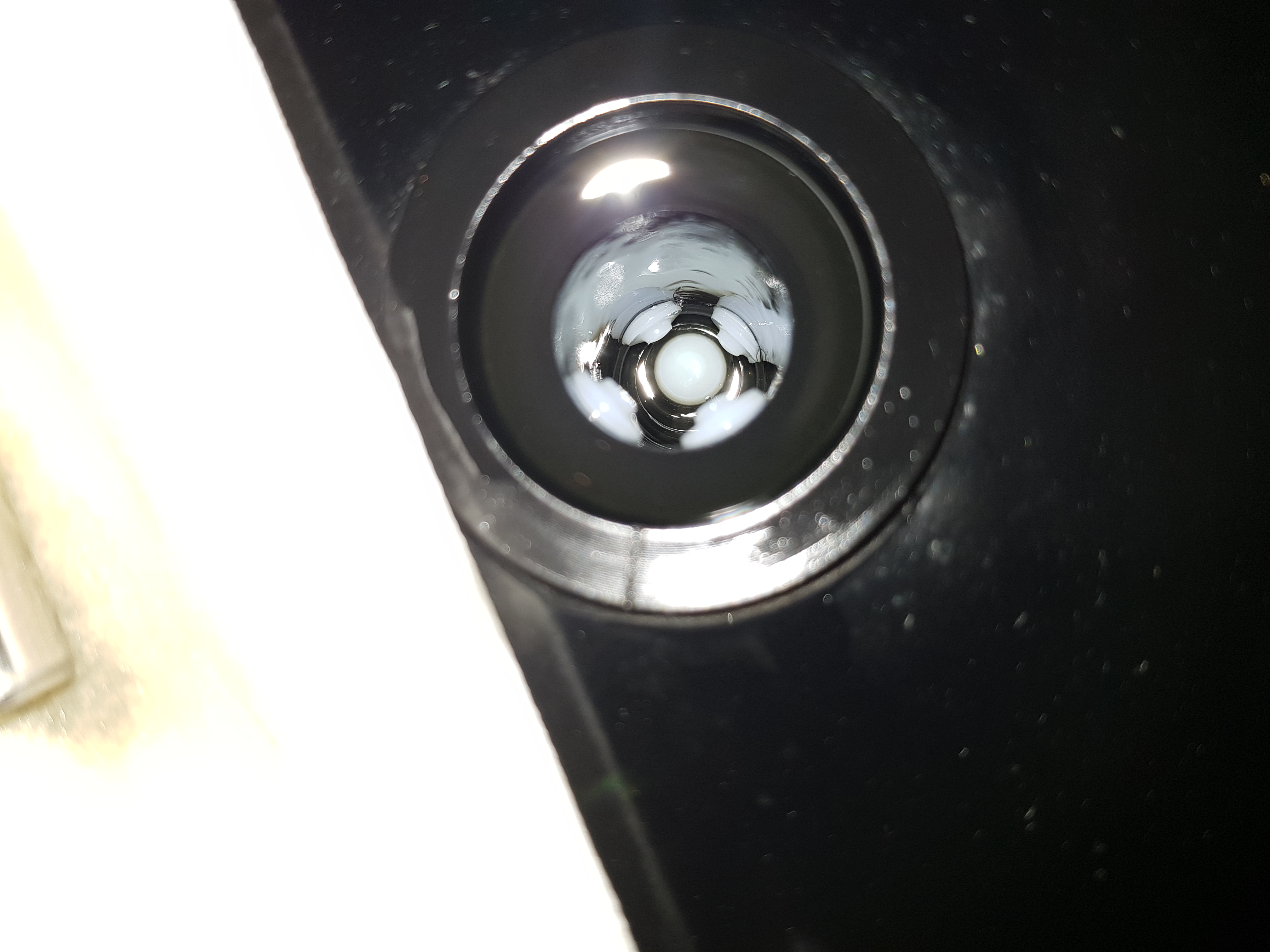

mloutfie Posted July 24, 2017 Share Posted July 24, 2017 Emptied the bearing well and checked the 5 bearing points looks good. Also took a video of the platter wobble. Was trying to find 5w oil on the way back home but couldn't find any. But my gut feel is still the belt. Here's the video https://ufile.io/qxu53 Link to comment Share on other sites More sharing options...

TOPSHELF Posted July 25, 2017 Author Share Posted July 25, 2017 I've just had a look at the video and if you watch your spindle it doesn't move at all. I think the platter is warped? I have the same opaque platter and it is slightly concave if you put a straight edge across the whole thing you will see a gap that becomes greater towards the spindle. This dishes the vinyl when you tighten the puck and is meant to be like this. Do you own a set square? If you square off the edge of the platter and across the centre hole i bet there will be a height difference at the two edges at some point if you rotate the square through 360 deg. Your pics look like you have the twist correct. Sent from my SM-G930F using Tapatalk Link to comment Share on other sites More sharing options...
mloutfie Posted July 26, 2017 Share Posted July 26, 2017 13 hours ago, TOPSHELF said: I've just had a look at the video and if you watch your spindle it doesn't move at all. I think the platter is warped? I have the same opaque platter and it is slightly concave if you put a straight edge across the whole thing you will see a gap that becomes greater towards the spindle. This dishes the vinyl when you tighten the puck and is meant to be like this. Do you own a set square? If you square off the edge of the platter and across the centre hole i bet there will be a height difference at the two edges at some point if you rotate the square through 360 deg. Your pics look like you have the twist correct. Sent from my SM-G930F using Tapatalk If would take a considerable amount of force to warp an acrylic that thick so doubt it. Also if it's warped it would still wobble if I tension the belt by putting the motor far away. Which it doesn't wobble if I do that. I still think it's the belt we'll see how the replacement goes Link to comment Share on other sites More sharing options...

Guest Runaway Posted July 26, 2017 Share Posted July 26, 2017 Managed to download the video. The whole platter is wobbling which does suggest that either the spindle is not aligned properly or the belt is at fault. I had a VPI Scout where the belt was slipping and the instruction from VPI was to boil the belt for 30 sec (which apparently tightens the belt), dry and dust with talcum powder - which I did and it worked. I do not suggest that for the WT belt unless you feel you have nothing to lose by it. Again, happy to drop by with my WT belt to see if that makes a difference if you are not too far away. Link to comment Share on other sites More sharing options...
AKY Posted July 26, 2017 Share Posted July 26, 2017 Three things to try. 1) Clean the belt with a bit of dish soap and rinse thoroughly or use a bit of isopropyl alcohol. It is easy to get some of the silicon fluid on the belt and it will slip. 2) Check the level of the bearing cup. I had to bang my out and shim the edge. 3) Make sure the platter is seated properly. Link to comment Share on other sites More sharing options...
