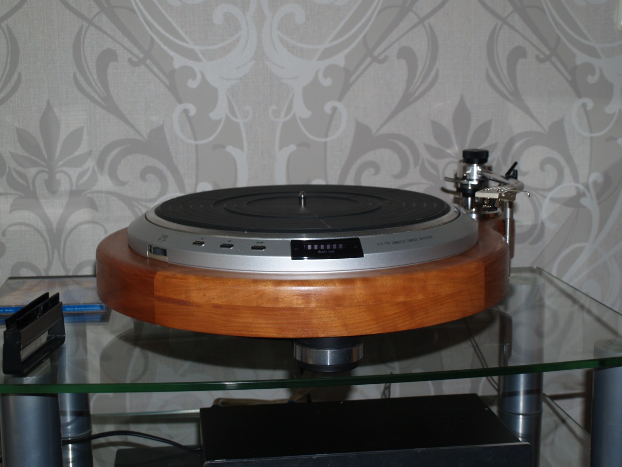

MattyW Posted February 22, 2017 Posted February 22, 2017 Mmmm, hoping to have Duc do a lovely plinth in another two years or so for my JVC QL7. I have my Fidelity Research FR54 tonearm for MC's though also a Mayware Formula 4 for high compliance carts. With two arms on a table I'll have the best of both worlds Have some work to be done on the home first though. Sent from my Redmi Pro using Tapatalk 1

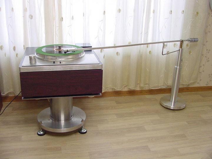

Tasebass Posted February 22, 2017 Posted February 22, 2017 45 minutes ago, Zaphod Beeblebrox said: It's VERY complicated. Which is why most turntables come with tone arms. A lot can go wrong. Naaa!!...dead easy... Nothing to worry about...no Baerwald ..no Lofgren..no overhang..no bias..no SRA....( VTA..maybe VTA )... Tase 7
audiofeline Posted February 23, 2017 Posted February 23, 2017 3 hours ago, Tasebass said: Naaa!!...dead easy... Nothing to worry about...no Baerwald ..no Lofgren..no overhang..no bias..no SRA....( VTA..maybe VTA )... Tase As Maxwell Smart (secret agent 86 for Control) would say - "That's the second-longest tonearm I've ever seen"!
Wimbo Posted February 24, 2017 Posted February 24, 2017 (edited) On 23/02/2017 at 8:14 AM, MattyW said: Mmmm, hoping to have Duc do a lovely plinth in another two years or so for my JVC QL7. I have my Fidelity Research FR54 tonearm for MC's though also a Mayware Formula 4 for high compliance carts. With two arms on a table I'll have the best of both worlds Have some work to be done on the home first though. Sent from my Redmi Pro using Tapatalk This looks good Matty. Edited February 24, 2017 by Wimbo mistake 1
