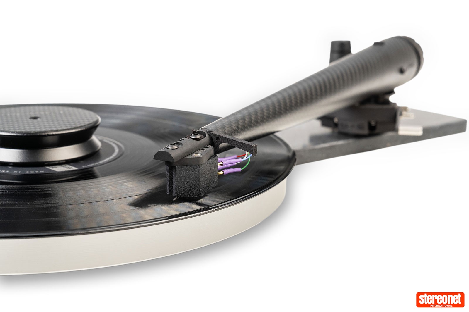

The new model follows the 10-inch Dark-Light tonearm shown at Munich High End 2025 and is set to make its European show debut at Vienna High End 2026. For Australian vinyl enthusiasts, Wand founder and designer Simon Brown has also confirmed the brand will appear at the StereoNET Melbourne Hi-Fi & AV Show, where it will be demonstrated.
Wand Analogue Products is part of a New Zealand company, Design Build Listen established by Designer, Simon Brown, which has built a following among vinyl listeners who like their engineering served with a with a solid dose of independent thinking. The original Wand Tonearm launched in 2011, making its name with a large-diameter carbon-fibre arm tube designed to be significantly stiffer than more traditional tonearm designs.

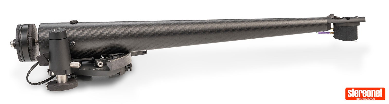

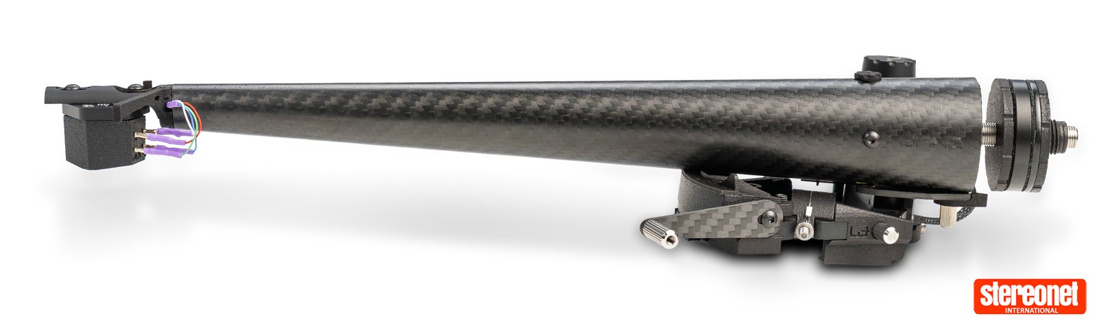

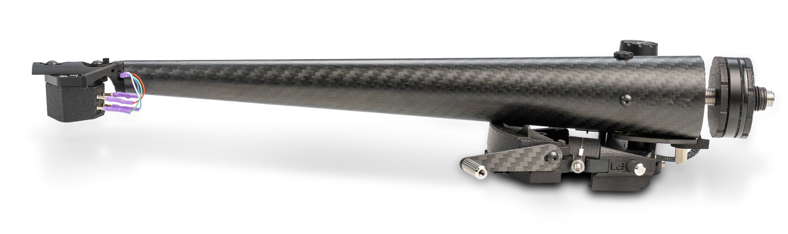

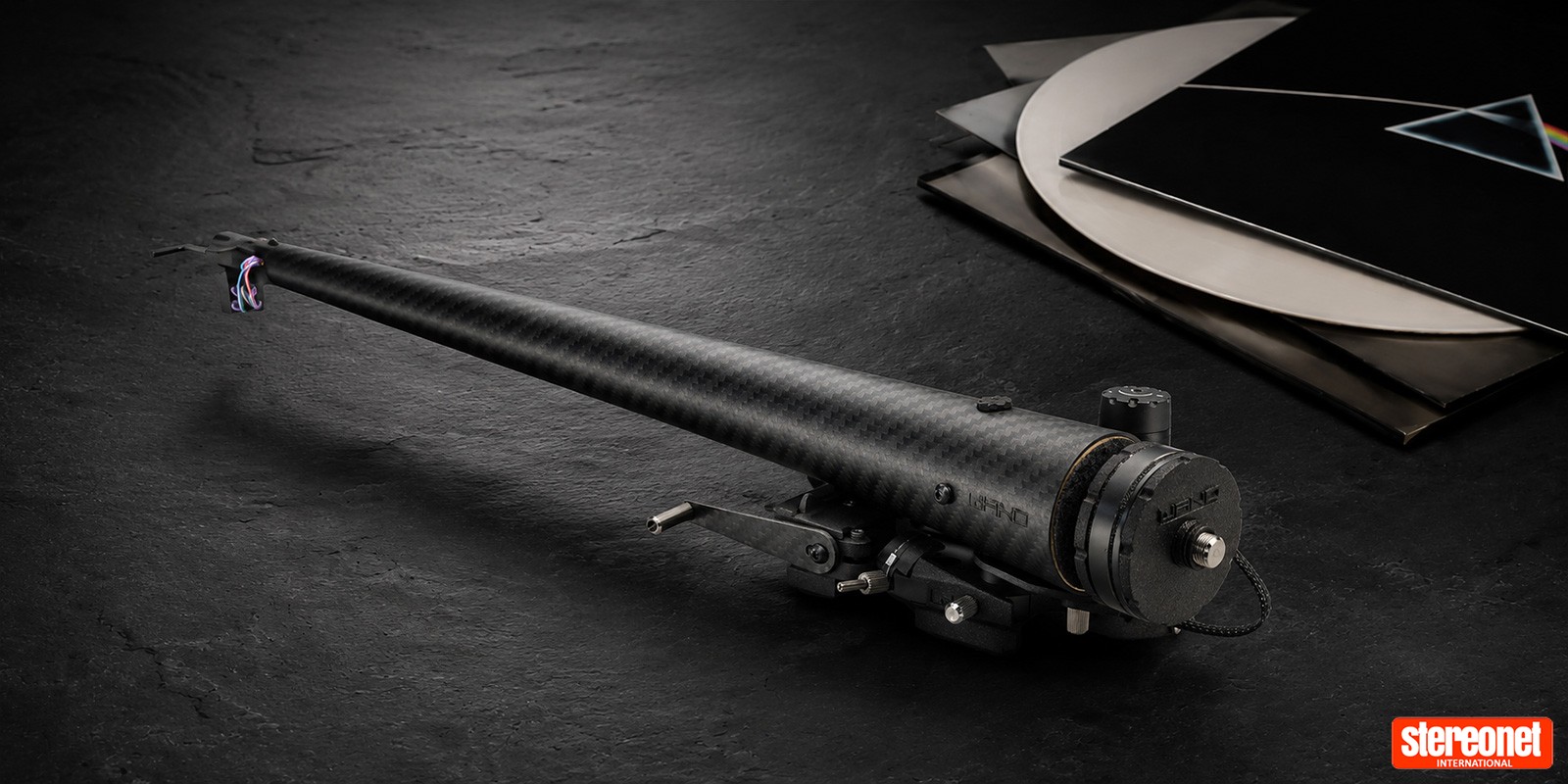

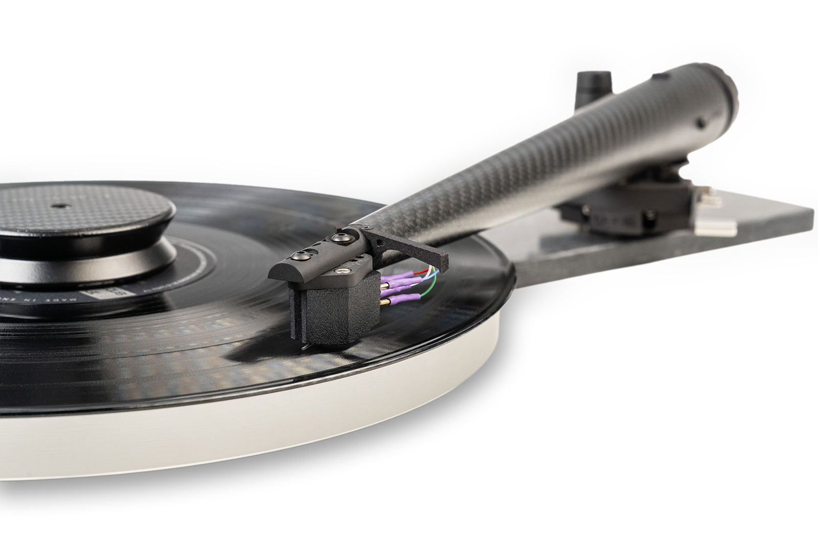

The 12-inch Dark-Light takes that thinking further, as a longer tonearm is often favoured for lower tracking distortion. It’s not without challenges, mind, as the extra length can also introduce flex, resonance and mechanical stability. Wand’s argument is that simply making a tonearm longer is not enough; the structure has to become more stable as the arm grows.

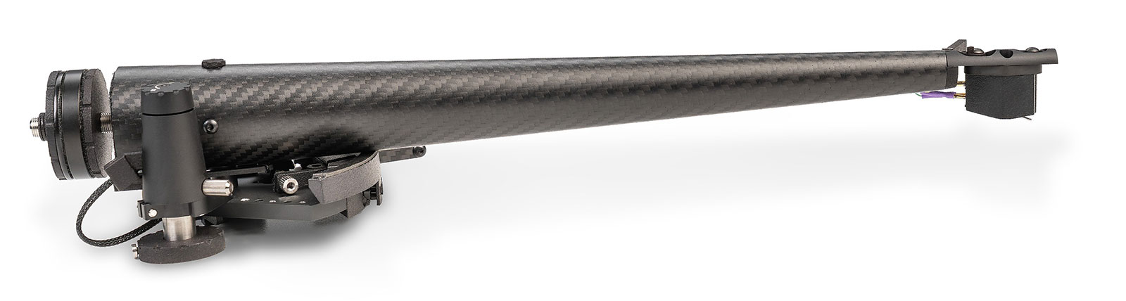

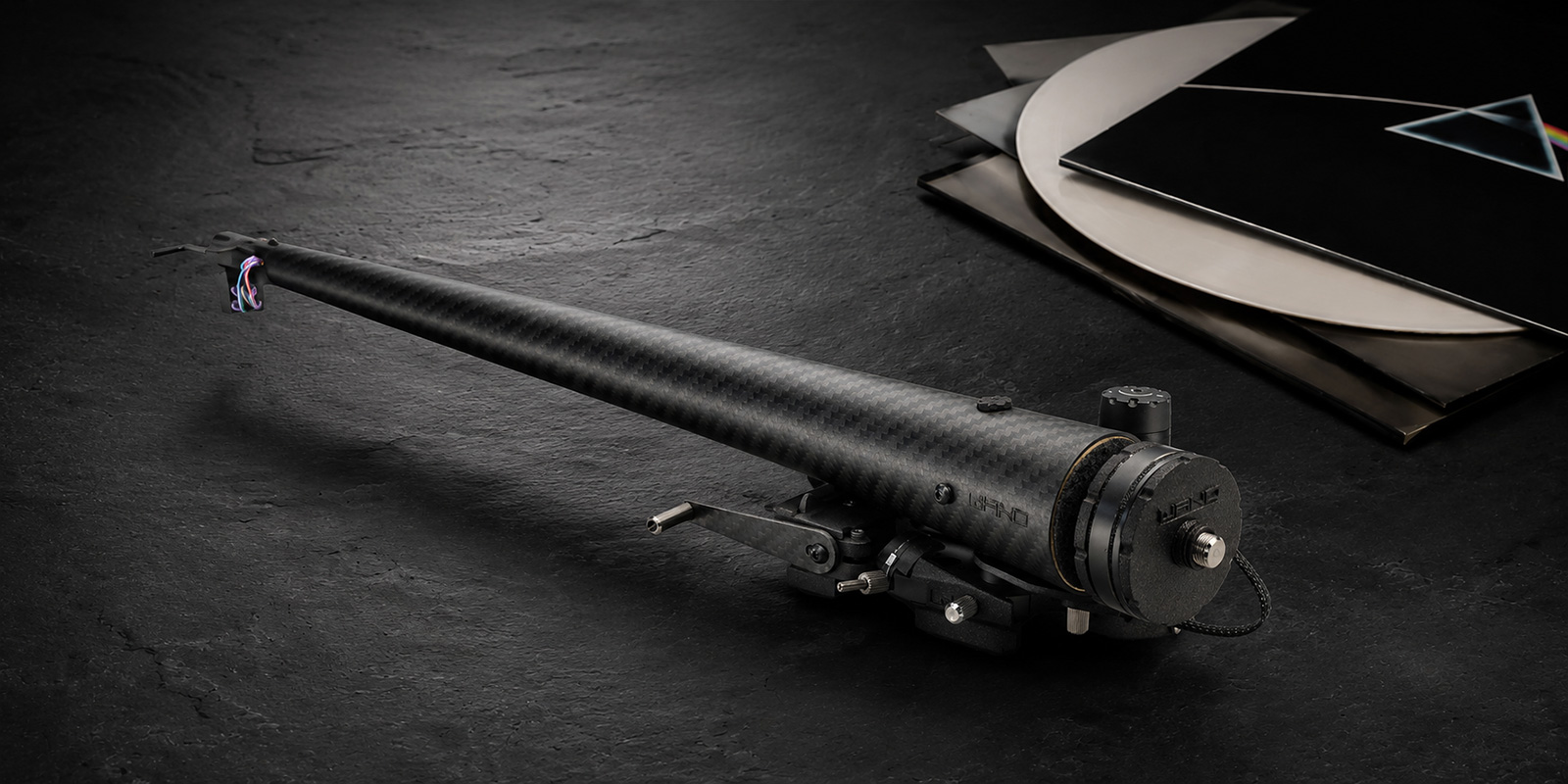

Wand’s solution is its Musical Taper design. As the arm length increases, the tube diameter also increases towards the pivot, with the aim of improving stiffness rather than sacrificing it. Inside the larger rear section is a greater brass mass, designed to lower the centre of gravity and help terminate vibrational energy travelling through the arm. Brown jokingly calls this “BLOB technology”, short for Big Lump Of Brass, but the idea is grounded in serious engineering: give unwanted energy somewhere controlled to go, rather than letting it reflect back through the arm structure.
The 12-inch Dark-Light also uses Wand’s ZeroPoint bearing, described as a diamond-on-carbide interface designed to maintain consistent contact under load. The company says the natural drag of the stylus creates a force vector that biases the bearing contact point, broadly aligning it with the stylus cantilever. In simpler terms, the aim is to reduce microscopic instability while improving detail retrieval, bass clarity and the arm’s ability to track freely.
A Side-Glide bearing provides gentle lateral stabilisation without adding unwanted friction. It is the sort of engineering story that can easily drift into analogue mysticism, but Wand’s broader point is easy enough to understand: at vinyl playback scale, very small mechanical behaviours matter.
The supplied specifications list an effective arm length of 308.8mm, a mounting distance of 295.6mm, an effective mass of 17g, and a total weight of 700g. The mounting hole is listed as a nominal 25mm / 1 inch, with adjustment from 19mm to 46mm.
The 10-inch Dark-Light has already drawn strong overseas attention, including a recent review in The Ear, which described the tonearm as a highly engaging and complete performer. The new 12-inch version appears to be less a replacement than an extension of the same design language, aimed at users with turntables able to accommodate the larger geometry.
The Wand 12-inch Dark-Light tonearm is available now, priced at NZ$11,800. European pricing is listed at €8,900. Australian buyers can contact Wand directly, with local retail or distribution arrangements yet to be confirmed. Parties interested in Australian distribution or retail opportunities are also encouraged to contact Wand directly.
