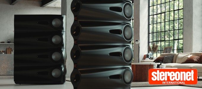

Dubbed the Moya M1, the resulting design is a five-way, thirteen-driver design including eight side-firing, proprietary bass drivers. Each C225-100H woofer sports a 22.5cm alloy diaphragm with a 10cm voice coil in a 45 mm gap rare-earth radial magnet system. Set up in horizontally opposed pairs, their magnets are united by a substantial steel tie-bar to eliminate cabinet vibration and minimise any turbulent effects that may limit low-end linearity. Furthermore, these drivers sit within four extensively braced bass enclosures, each with aerodynamically optimised reaction-cancelling ports.
Vivid Moya M10
Meanwhile, the mids are presented via two front-firing 17.5cm carbon fibre-reinforced mid/bass drivers, above which sits a single 10 cm carbon fibre-reinforced mid-range driver. Finally, two Diamond-Like Coated (DLC) aluminium alloy modules – a 50mm upper midrange dome and a 26mm tweeter round off things on the uppermost band. Of course, the Dickie-signature tapered tube loading is present here. This design feature prevents sound waves at the back of the drivers from distorting the audio, as introduced in the now legendary-but-still-in-production Naitulus, and remains contemporary in every Vivid Audio speaker.
Vivid Moya M10
We are told that "the contrasting properties between the DLC and the aluminium substrate heightens shear losses and significantly dampens the ‘Q’ of the break-up".
Every driver has been developed (and optimised) from the South African-based brand's existing signature carbon-reinforced sandwich composite. Moreover, they're hand-manufactured in-house, too. Also built in-house are the computer-optimised, passive, hard-wired filters promising remarkable accuracy and phase matching.
Vivid Moya M10
The Moya M1 use a passive, five-way, fourth-order Linkwitz-Riley crossover in three parts, with the mid and upper sections placed well away from the bass ones.
