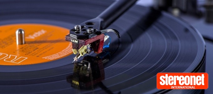

The new Colibri XGW Signature Stradivarius is crafted from cross-grained Brazilian Pau wood. The high-density wood offers excellent sonic properties and so is often used in the bows of stringed instruments. However, in the cartridge, its the strong internal damping limiting vibrations travelling between cartridge and tonearm that's employed.
van den Hul Colibr iXCW Strad
The nod to the famous violin-maker is due to the ‘Stradivarius formula' lacquer coating the Colibri's body.
Naturally, van den Hul is not giving anything away in regards to the formula's composition, but its inspiration comes from Antonio Stradivari's iconic violins. van den Hul applies three separate layers of the lacquer, and each layer takes several weeks to fully cure and harden. This gives an insight into the months of work undertaken before any further construction can even begin.
van den Hul told StereoNET:
The advantage is that the harder outer coating destroys the standing waves inside the softer body, reducing unwanted resonance.
The Colibri XGW Signature Stradivarius has an extremely high (for an MC model) output of 1.10mV. That particular performance comes by way of a magnet with double the strength of that found in the regular Colibri. Additionally, there is a coil assembly with matched, six-layer, 24-karat gold coils that has three times the output of the standard two-layer coils.
Together, this incredibly efficient generator assembly endows the cartridge with quite incredible dynamic range and accurate retrieval. The cantilever is solid boron and uses the proprietary van den Hul type 1s, 2x85µm stylus.
Each individual cartridge is hand-built to order by A.J. van den Hul himself and can be tailored according to the customer's hi-fi system, musical preferences and other sonic tastes. What's more, van den Hul offers a 200-hour service check-up free of charge to the original owner.
