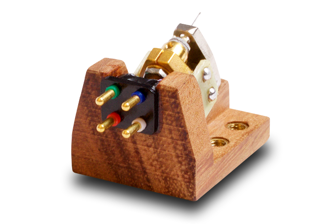

Not just Italy per se, but musical instrument genius, Stradivarius provided the way forward to a new edition of the Crimson.
A.J’s latest version uses several layers of lacquer mixed to the formula Stradivarius employed on his unsurpassed wooden bodies, wind instruments that are now legendary for their sublime sound.
Three layers are applied to the new Crimson and these according to a conversation we recently had with A.J. eliminates any standing waves inside the cartridge’s softer body.

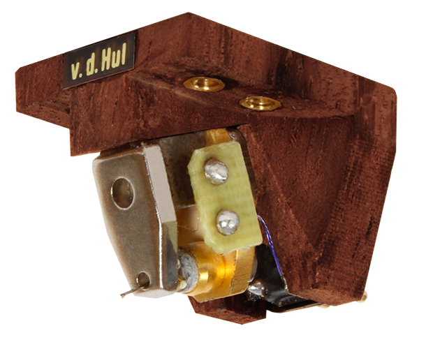

The difference with the standard version is the application of a copy of the lacquer used by Mr Stradivarius,
This lacquer dries very slowly and I apply even three layers. This takes about half year before I can use the body to build a system like I did recently for the U.K.
Each of the layers takes two months to dry.
van den hul Crimson Stradivarius

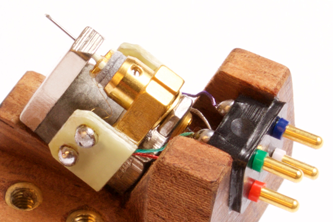

Elsewhere inside the new Crimson are significant changes.
Also I apply a thinner suspension wire to have a better control of the armature movement. With the standard wire, the armature, despite good damping, acts still a bit as a mechanical resonator,
Not really much but each little bit is still too much. The inner damper is also changed to get even, smooth sound.
A.J. points out the new Crimson has three dampers that respond quickly to a change in position in relation to the damper. This avoids spurious resonances in the armature platform direction.
According to A.J, the armature should just rotate around a fixed point in the centre. Otherwise there is rotation combined with shifting.
This shifting is mostly ignored by designers because an armature creates an electrical signal that makes anyone at first listening already happy.
The real quality comes from pure rotating around the centre of the armature. A shorter suspension wire (not stiff and therefore thinner) is the solution. The quality of the inner damper does the rest.
