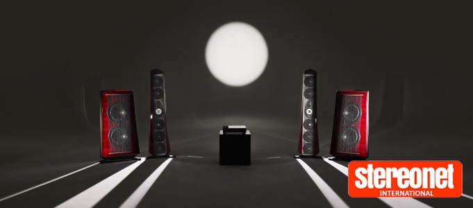

The Italian brand stunned CES 2024 visitors with its Suprema system, which consists of two main speakers, two subwoofers, and an electronic crossover.

SUPREMA TOWERS
The Suprema's 1905 x 650 x 880mm (HxWxD) tower speakers sport the Sonus faber trademark lute shape, celebrating the first Guarneri violins of the Cremona region near which the brand is based. Multi-layered wood is used for the side panels with the illusion of 'wings' created by a unique 3D bending shape. This is completed by a leather front panel created in collaboration with renowned luxury furniture brand Poltrona Frau, whose Impact Less leather, a chromium-free tanning process leather, was launched in 2022.

SUPREMA SUBS
Sonus faber Suprema Speaker System
Meanwhile, the 1451 x 850 x 525 mm (HxWxD) subwoofers feature an elliptical shape in honour of the Stradivari violin, as echoed by the aforementioned Sonus faber Stradivari. This design enables them to accommodate two 38cm transducers. These utilise carbon fibre membranes and a neodymium magnet motor system for undistorted pressures while covering its 16 to 30/80 Hz (variable based on the setting of the electronic crossover) frequency range. Furthermore, the speakers are decoupled from the ground using a mechanism produced in partnership with isolation specialists IsoAcoustics.
SUPREMA CROSSOVER
Finally, the electronic crossover is housed in a rectangular chassis that, like the rest of the Suprema system, comes in your choice of red, graphite or walnut finishes. This handles the integration between the speakers and subwoofers and is a dual mono, fully balanced design with all phase cutting and control circuits remaining purely analogue and created using selected discrete components. Sonus faber tells us that the Suprema's configuration system "aims to extend beyond the conventional limits of the frequency band coverage" and that the crossover filters that are partially visible on the sides of the main column use the best electroacoustic configurations experienced by the R&D team in the last decade.
