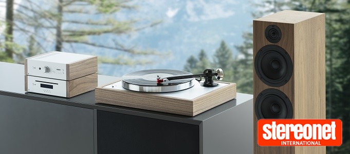

The Classic turntable was launched as part of Pro-Ject Audio Systems' 25th-anniversary celebrations in 2016. Since then, The Classic has become a core part of the Pro-Ject turntable range, but it's time for an EVOlutionary update.
As part of Pro-Ject's long-awaited simplification of ranges, The Classic and The Classic SB SuperPack are now merging into one product offering: The Classic Evo.
Pro-Ject The Classic Evo
The Austrian company states that the Classic Evo utilises a simple and elegant frame design, which bears a notable resemblance to some of the most famous turntables of the 1950s, '60s and '70s - there's no argument from us on that point.
That said, Pro-Ject has brought that design up-to-date with an improved two-plinth design. Instead of the traditional spring-loaded chassis approach, The Classic Evo utilises Thermoplastic Elastomers (TPE) to isolate the metal-finished inner-chassis.
The Classic Evo
The idea of reduced resonance transference in The Classic Evo carries through to the platter configuration. Machined from a special aluminium alloy the substantial platter is lined with TPE damping. Additionally, the new sub-platter is diamond-cut from the same metal for absolute accuracy and reliability in production. Furthermore, when mounted in the steel/bronze main bearing with Teflon lining, the result, we are told, is an ultra-silent, stable playback platform with minimal bearing noise.
The platter system is belt-driven by a premium AC drive motor, which is powered by a DC/AC generator board for minimal noise and interference from unclean power supplies. For added convenience, there is also a simple speed control switch on the top surface of the inner plinth for quick and easy switching between 33 and 45 RPM.
