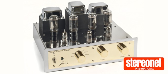

Jadis Diapason Luxe
We are told that the Diapason was designed from the ground up to be the most affordable integrated valve amp from the French company. However, the new Luxe version adds premium touches, such as the non-magnetic stainless steel frame with 24-carat gold plating on the front panel.
Jadis Diapason Luxe integrated valve amp
The amp incorporates seven valves in its Class AB, semi-automatic bias design, which are said to have been specially selected by Jadis for the Diapason. The lineup includes one Electro Harmonix ECC82 and two Tung-Sol EC83s for the input/preamp stage, plus four Tung-Sol 6L6s (two per channel) in a push-pull configuration for the output stage. The 6L6s are mounted on a vibration-damping ceramic support.
While simplified compared to designs higher up the Jadis ladder, the three hand-wound transformers maintain the same fundamental attributes, right down to the vibration-damping resin, and are still made in Jadis' factory in Villedubert alongside those loftier models.
The result is a 12kg, 15W per channel integrated amplifier with a 4 to 8 ohm load impendence and 20Hz to 25kHz @-3dB quoted frequency range.
The Diapason Luxe sports six line-level RCA analogue inputs, one of which can be optionally converted to a USB digital input.
