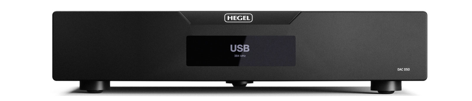

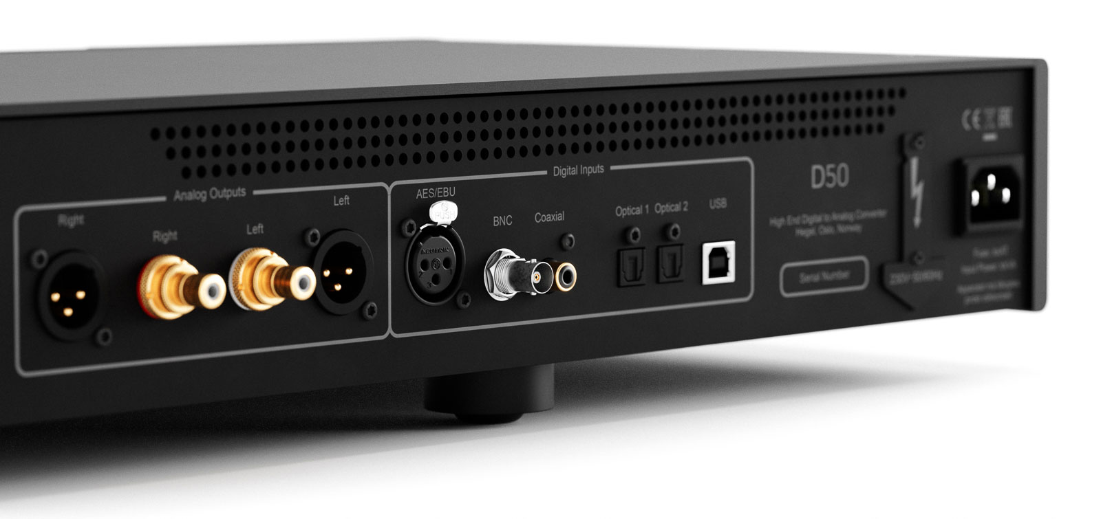

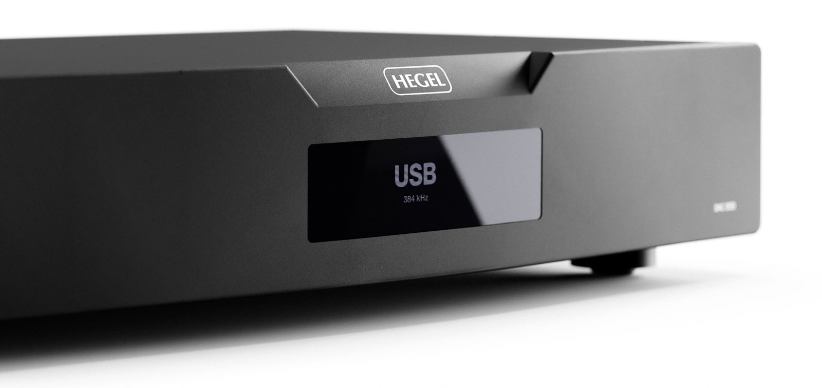

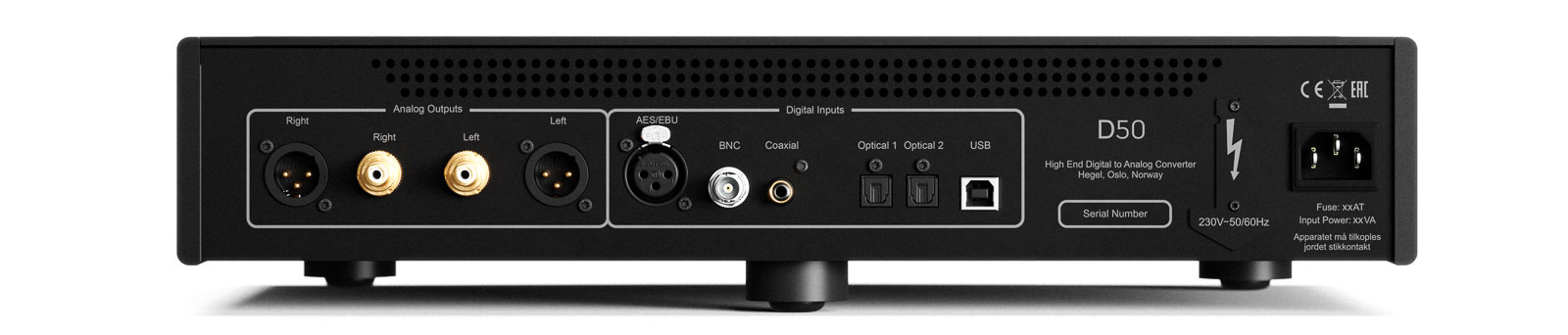

The D50's chassis is constructed from aluminium, with a thick, milled front plate that conceals physical buttons for a clean, minimalist aesthetic. The display is bright yet discreet, with a dimming option for distraction-free listening. Hegel has also integrated auto signal sensing, meaning the unit can automatically wake up and switch inputs based on the detected signal. Connectivity is broad, with USB, optical, coaxial RCA, coaxial BNC, and AES/EBU inputs, while analogue output options include both balanced XLR and unbalanced RCA. However, as a pure DAC, there are no variable outputs or preamplifier functionality—it’s strictly a source device designed to feed an external preamp or integrated amplifier.
