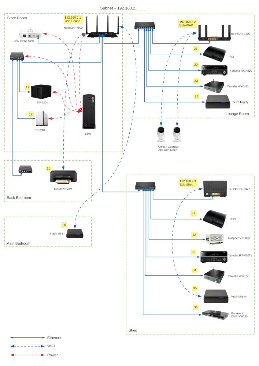

I'm looking at upgrading my NBN to FTTP. My Netgear X4S AC2600 Modem/Router is a bit long in the tooth and needs an upgrade.
Our usage is pretty light, with little streaming, and no major sized file transfers. But something with good range would be desired to try and simplify my current setup which currently uses two WAPs
I have included a pic of my current setup, or close enough to how it is now.
What are the brands and models others are using for FTTP, and what do you like or dislike about them?
Pros, cons specs etc...
