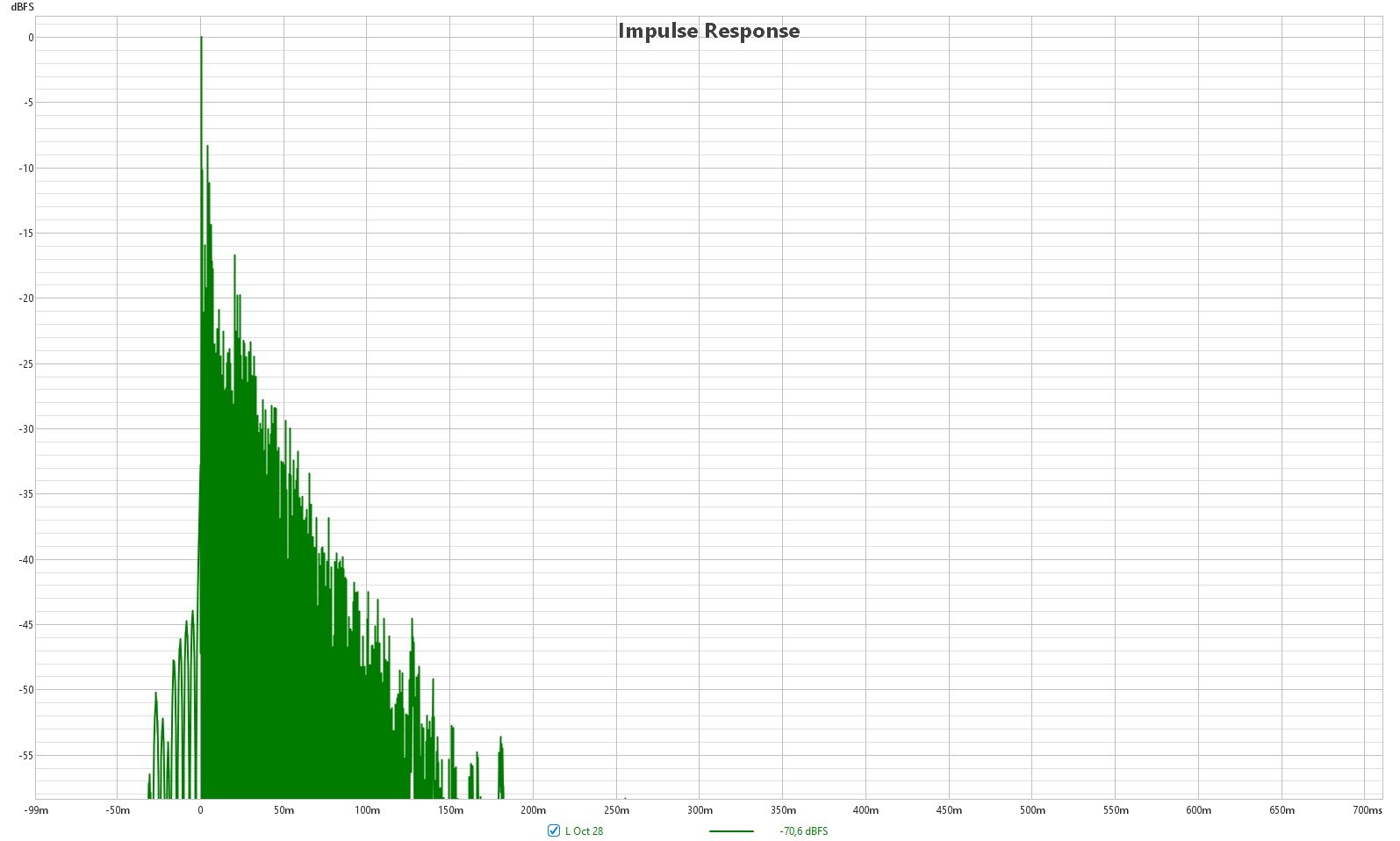

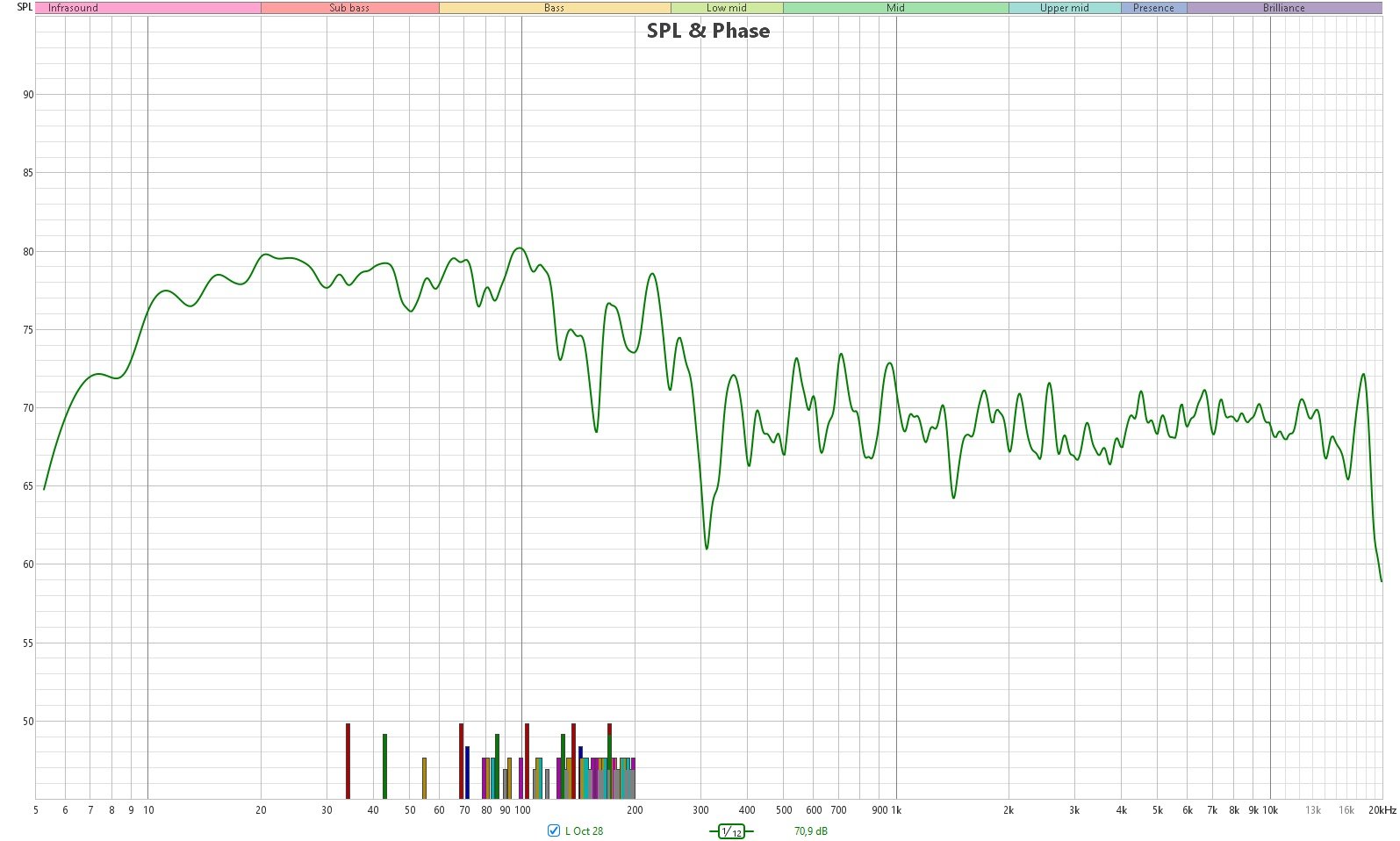

Have been playing around with REW for some time, in the Impulse Response graph i think the noticeable peaks are ceiling and back wall.
Room sound is kinda dry i think (in a positive way) so no more absorption in the upper range, it's about 50/50 music/home theatre.

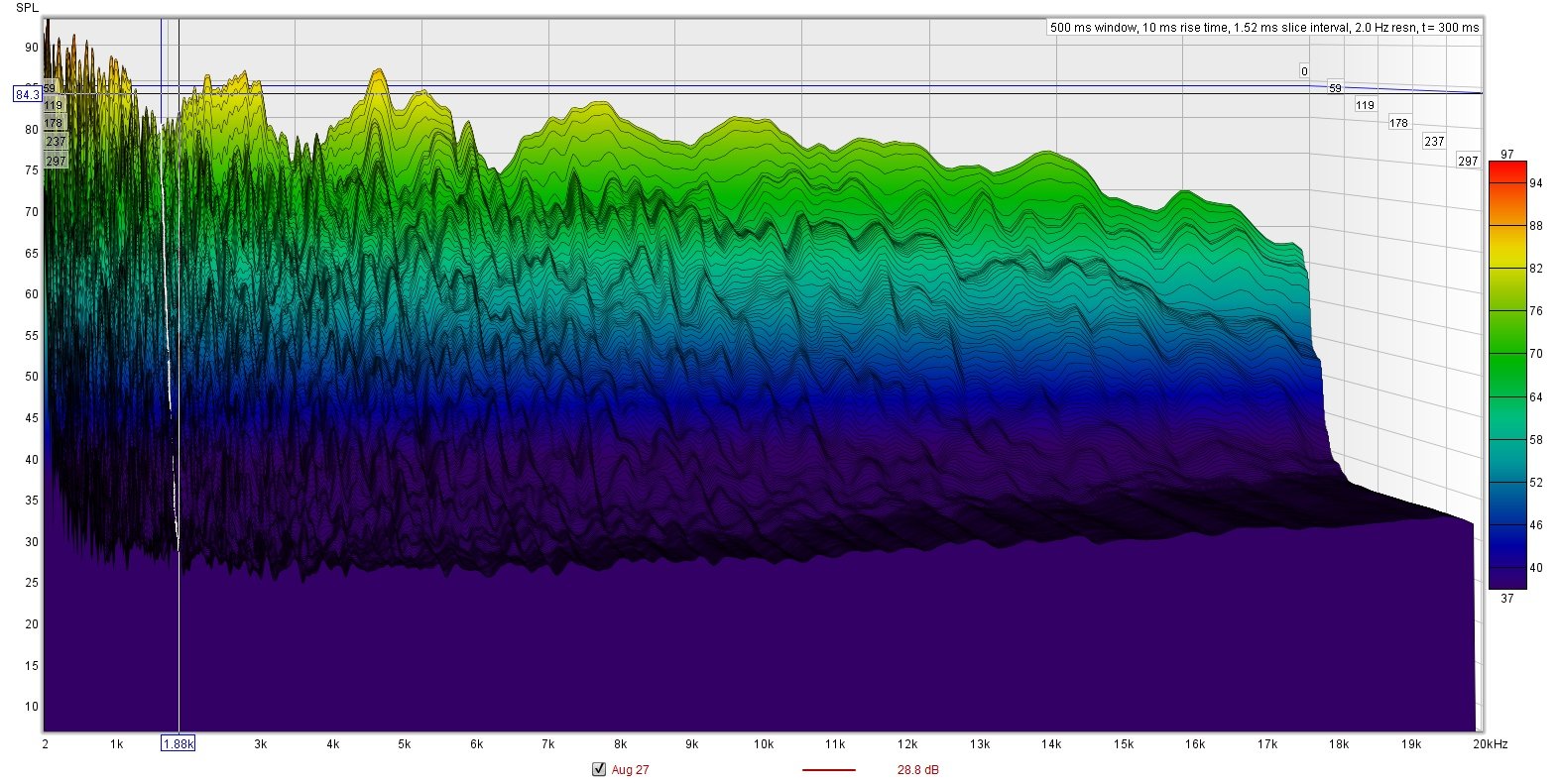

I had a good long look at the response Waterfall graph with a really quite reasonable fundamental response.
Tried to emulate a graph of my own "space" with similar settings to yours. Didn't go all that well with the scale, but readable.

Talking ceiling absorption and looking at the 1200Hz and above decay times between both of the graphs, they are not far apart, 2.4m ceilings is hard to work with.
Absorption in this range tend to not dry out the reproduction but actually perceivably open up the space to seem larger.
However treatments through the 100 to 1200Hz does tend to "dry" this most interlegible, to a human, component of reproduction.
I've never been a big fan of diffusion as while it can have good effect in some applications, it does not tend to absorb decay, it mostly breaks up flat surfaces into smaller parts, good for first reflection points to subdue the combing effect but not great at absorbing the decay.
Of note the 2 graphs, seems t show a smoother high frequency decay time, without drying out the reproduction with the effect, simply put, more interlegible and defined very high frequency response.

Personally looking at the 2 response graphs, your graph has a better fundamental response, but,  it still has decay lumpyness in the 1200 and up frequency range in comparison and might show improvement with ceiling absorb, rather than diffusion, in addition to the other trapping you have installed.
Sonically the lounge I'm in has a dry tonally correct, uncoloured bass response to the ear (preferable personally), but is balanced out with the layering into the upper frequency ranges.
Try a good hard clap in your lounge and listen for the result, if it rings, there is room for improvement

Your scale is linear in your graphs, mine is logarithmic.
Yea, wondered what went on there. Thanks for that, worked it out. Slice interval is out a little but the graph is better.
An old measurement of a basic test rig no EQ or TD, fundamental is all over the place. showing a fairly short reverb time through 1200Hz and above. Attributed to the thinner 40mm surface treatments. I like to have the noise floor present in the graphs.
