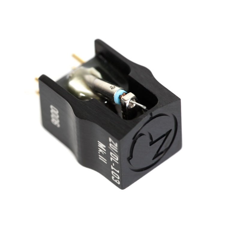

The Mk.II update is significant, both in performance and handling usage. The body is machined from 6061-T6 and hard anodized to aid in the matching of tonearm-mount properties and further reduce pickup stored energy. The shape of the housing has also been refined to reduce resonance and stress risers resulting in a much stronger design that better supports the motor assembly. We have also changed the epoxy matrix formulation that binds the assembly further reducing mechanical noise and positions increased stability to the stylus. In short we have been able to keep the great tone of the original Zu/DL-103 but give significantly improved transparency. Handling usage has also been considered and improved, with design elements to help safeguard the stylus from accidental damage—stylus guard being the most obvious feature.
WARNING: ZU/DL-103 Mk.II pickups are semi-naked with exposed motor, only clean the stylus with a short nap stylus brush. Using a brush with a tall nap (hair length that’s long enough to enter the coil) can break the internal leads. Warranty does not cover broken leads.
