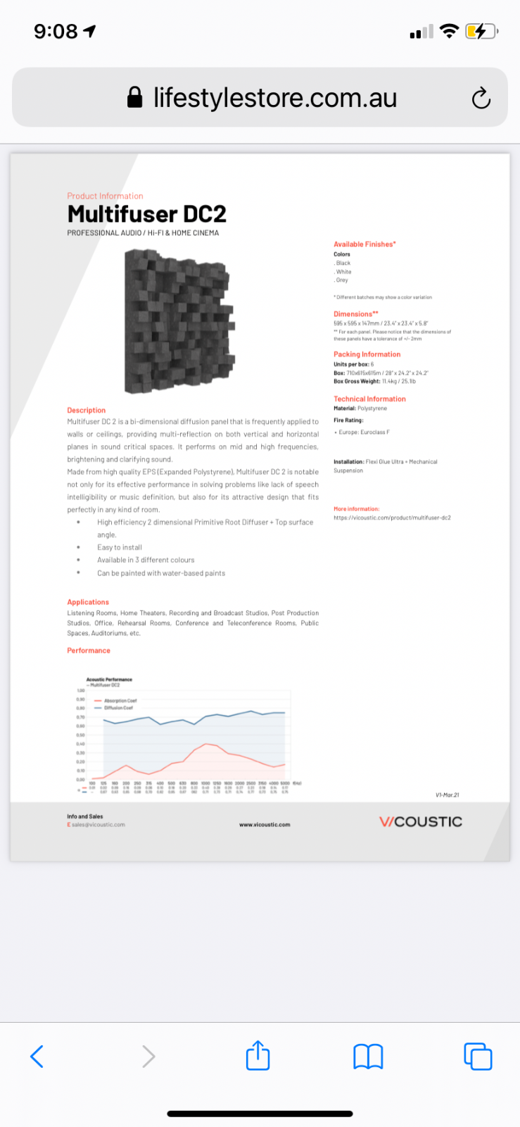

So far I have found the Vicoustic Multifuser DC2 https://lifestylestore.com.au/product/vicoustic-multifuser-dc2-box-of-6-diffusion/

From the pictures I can find of either of the examples - neither are based on a prime number - which is required for Quadratic Residue Diffusers (QRDs).
The Sonitas appears to be 12 x 12 - at best this in an N3 diffuser (3 being the highest prime multiple of 12)
The pictures of the Vicoustic product aren't clear enough to determine more than 1 axis which is 14 wells - assuming it's 14 x 14 wells, again not prime, but possibly N7 (7 being the highest prime multiple of 14).
Without any other data I would expect the Vicoustic product to provide more diffusion than the Sonitas product.
