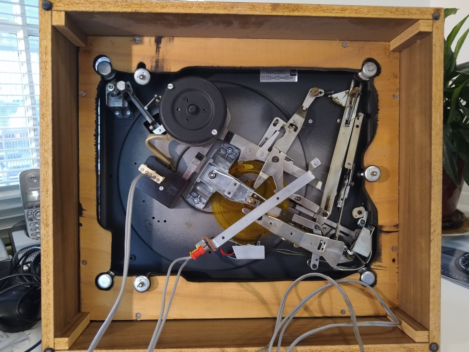

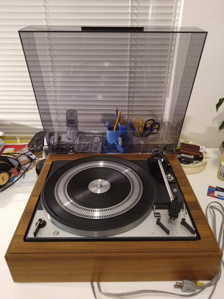

Robertoh Posted November 2, 2020 Posted November 2, 2020 (edited) Hi all I'm a newbie here so pls be nice. Also I'm aware of some discussion of Dual idler drives elsewhere in this forum, so forgive me if I should be posting there, or linking there to here, or whatever... OK, getting to the point: I acquired a one-owner 1219 a few months ago from a deceased estate. I am a bit of a sucker for mechanical complexity from the late '60s - early '70s (I owned and adored a Citroen GS from that era for 8 years) but I am mechanically/electrically inept, so I would be very grateful for some advice from those who run 1219s and similar Duals, please. My new/old 1219 hasn't been used for about 30 years and is looking quite gummed-up underneath, but otherwise appears in very good condition with what I think is probably the original Shure (V15?) catridge/stylus. It looks in very good physical condition, and has the original pastic dustcover lid as well, and the original tonearm. It doesn't have the record-stacking spindle, unfortunately. I understand thease beasties require some careful and thorough rejuvenation and periodic servicing to give their best, and that I musn't force anything that feels stuck. I think it's stuck on the 45rpm setting. (The LiquidAudio blog from Perth has a great piece on restoring a 1219 but I'm in Melbourne and can't get mine to Perth easily.) Does anyone have a trusted turntable technician they can recommend in Melbourne who could service this properly for me, please? I don't want to risk its lovely mechanics on someone who doesn't know what they're doing. It's been sitting unused because we went into COVID lockdown soon after I bought it so I haven't been able to take it out to someone who can give it the right attention. Also, do you have any suggestions, please on: 1. An affordable quality replacement cartdrige/stylus, if I need one (not sure yet because I haven't used it yet) 2. Any tips for mounting it to minimise extraneous noise / vibration etc. 3. Does it need any kind of earthing/grounding to eliminate hum inteference to amp/speaker wires? (This seems to be an issue with my wife's simpler belt-drive '70s AGS turntable, that she's carried around for decades, and so she seems not to notice the hum, but I do ....) The amps to be used with this are '70s period Rotels: a tiny little RA-210 my wife has carted around for decades and an RX-402 that I acquired more recently. Thanks very much Rob Edited November 2, 2020 by Robertoh
Guest Old Man Rubber Posted November 2, 2020 Posted November 2, 2020 The 1219 has springs that hold the table clear from the plinth. Being an idler drive they will always rumble a bit more than a belt but if its really noticeable something is worn out. If you end up with an earth hum, a decent tech can add back the grounding wire, it should have one or at least the stub of one visible. Is your 1219 in a plinth already? This thread at vinylengine has a discussion on potential cartridges https://www.vinylengine.com/turntable_forum/viewtopic.php?t=91395

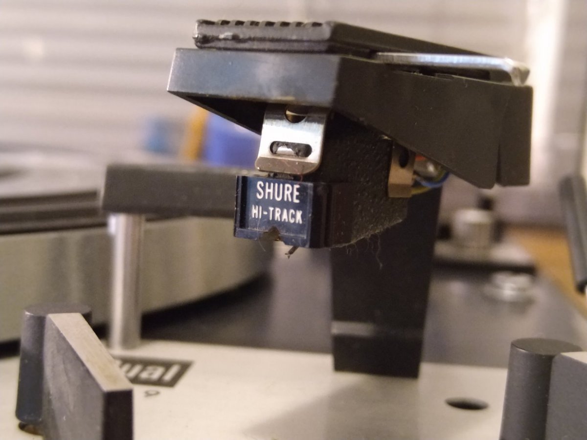

muon* Posted January 11, 2021 Posted January 11, 2021 That original cart was maybe a Shure M91ED, a decent cart. 1
audiofeline Posted January 11, 2021 Posted January 11, 2021 1 hour ago, muon* said: That original cart was maybe a Shure M91ED, a decent cart. Yes, and there are probably 3rd-party replacement styli available that won't break the bank. 1 1
