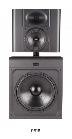

The closest I've heard to what I want in a demo/domestic environment is a ProAudio tech system driven by a Trinnov processor (and calibrated by someone who was flown from overseas).  I was looking at purchasing it, but the pricing on the ProAudio tech is crazy.
The speakers Paul built me are modelled on the ProAudio tech I heard.
