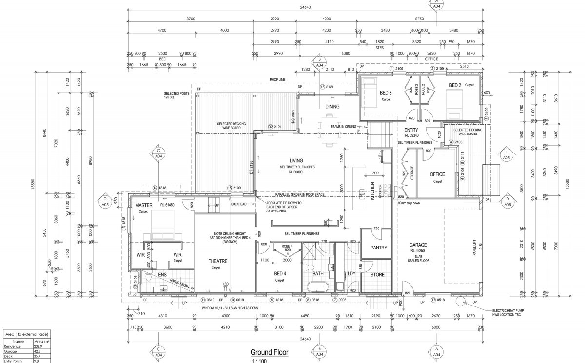

Hi folks, thought I would start sharing some pics and some updates.
Firstly, here's the house plan. The house is split-level, with the front area on a slab. The 2nd tier living area and kitchen etc is all on bearers/joists. The theatre is on the same tier, however it is on a slab. Finally our master bedroom is on a higher tier, but also on a slab. Ceilings are 8.5ft nominal, and 9.3ft in the theatre.

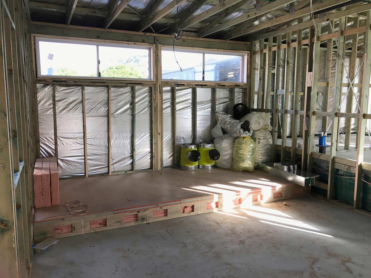

  • Author
Looking back at the rear-riser. The windows will be covered with blackout rollers or similar:
The left and right surrounds will be sitting on top of the riser, just at the front ledge of it, against the side walls. The surround backs will be 3 noggins in from the corners along the back wall. Still undecided on what method I'll use to lift these 4 speakers a little higher off the ground. They are floor standing 70cm tall speakers, but that won't be high enough. Thinking of having my builder add in some framed stands for them to sit on, and have the skirting boards go around them - so they feel like a fixture in the room.

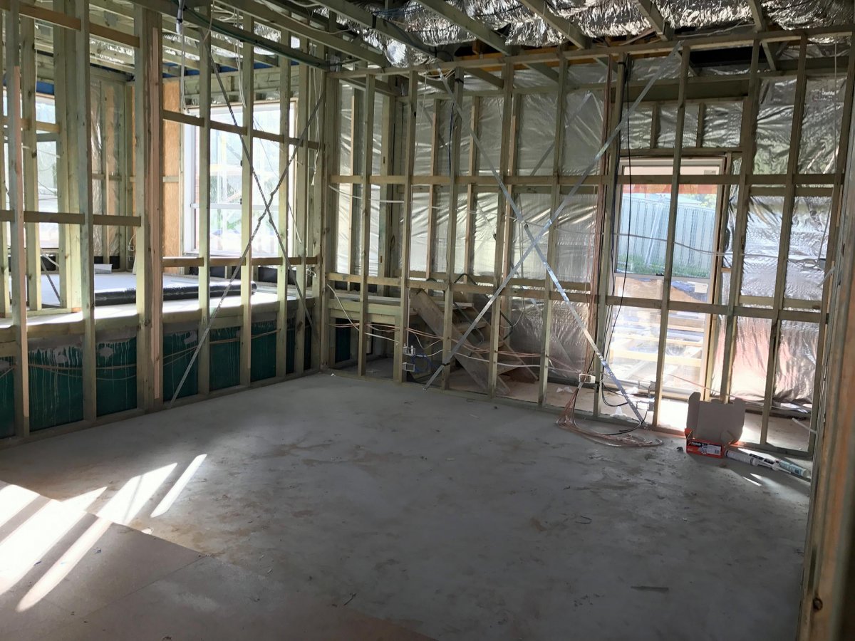

Here's a shot looking towards the front of the room from the rear riser. You can see all speaker cables, HDMI and ethernet are all in place. Walls will be filled with acoustic treatment insulation:

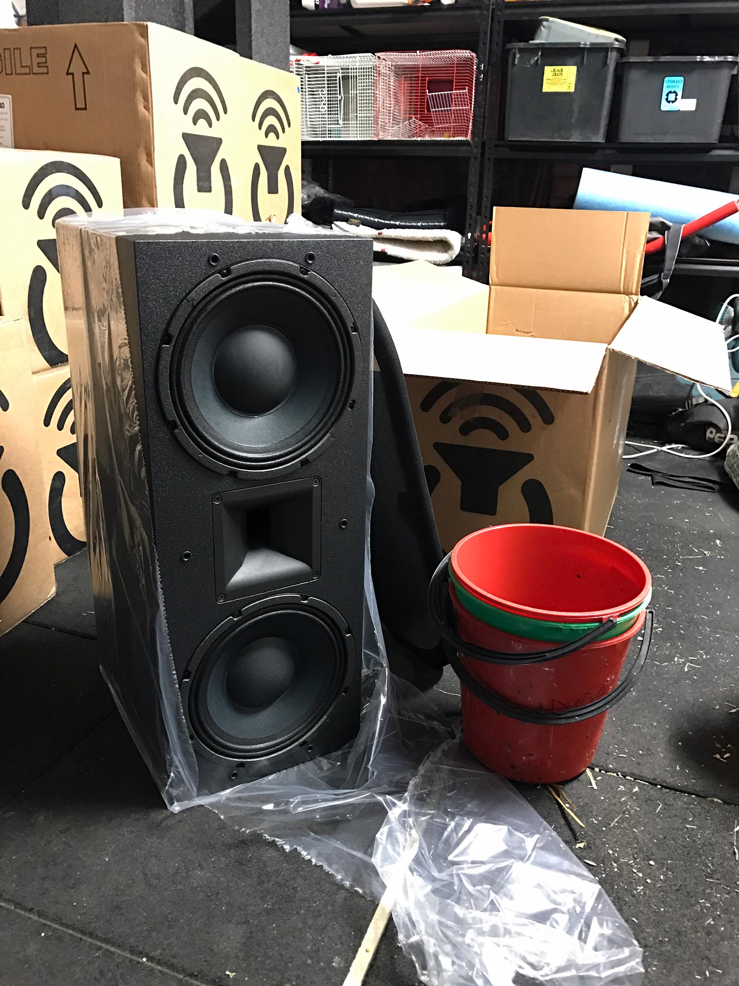

So 10 of my 12 speakers arrived today! I'm decking the theatre out with a full Power Sound Audio setup. Here's 7 main channels and 3 of my atmos / surrounds. My sub and 4th surround got re-routed by mistake to Mudgee instead of Ulladulla! Whoops. Big thanks to Peter at Deep HZ Audio for his customer service and recommendations. Was a pleasure to deal with.
PS - these things are quite big. The 7 main channels all feature dual 10" mid/bass drivers coupled to a horn tweeter. (see next pic)
  • Author
And here's one of the MTM-210's unboxed and grill removed. Hopefully I have a moment to hook a pair up to my temporary (borrowed) old Sony receiver over the next few days so I can take a listen. These are super heavy too. Very solid, utilitarian design:
Placed some buckets in the shot to get a sense of scale ;)
That's coming together very nicely! :)
How are you placing the LCR ?  Is the center a 210c. Do you know where the sub will sit. 2x18" pretty impressive
All 7 main channels are identical speakers, all 210's. Not the 210c. So they will all be vertically aligned, most likely will build some custom short stands for them to sit on. Sub is likely going to start its life between the front left and centre speaker along the front wall. I'm super excited to hear how the sub sounds, and to see if it's enough displacement for my room to achieve what I'm after - I'm almost certain it will be ;)
