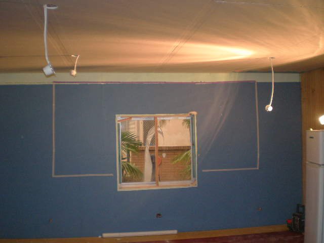

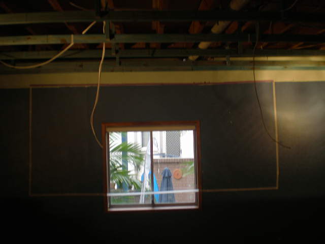

Bryce1963 Posted February 26, 2011 Author Posted February 26, 2011 Have finally got an opportunity to mock up the screen (will post some shots today). I've decided to go with the Klipsch Ref 52's as per previous but this now means that as per Simon's (i think) comment re acoustically transparent screens that i have had to raise the height of the bottom of the screen by an additional 140mm. I was originally planning on running with the 130" scope screen with the bottom of the frame at 800mm from the floor. I now need to raise it to around 950mm or so due to the speaker heights. I could potentially place the speakers outside the screen but most opinion seems to state that they should be within the 1.78 dimensions. Hopefully the pics will help but would be interested in your thoughts, first row seating at 3.5m approx and second at around 5ish, projector (Panasonic AE4000U) at 14'7" throw Will the screen be too high from a viewing comfort perspective ? Seems ok from the mocked up seating position but until i get the chance to get the projector up and play around with it am not so sure. Power and plaster in tomorrow so that will help but would value your thoughts. Thanks guys Bryce
Quark Posted February 26, 2011 Posted February 26, 2011 Have finally got an opportunity to mock up the screen (will post some shots today). I've decided to go with the Klipsch Ref 52's as per previous but this now means that as per Simon's (i think) comment re acoustically transparent screens that i have had to raise the height of the bottom of the screen by an additional 140mm. I was originally planning on running with the 130" scope screen with the bottom of the frame at 800mm from the floor. I now need to raise it to around 950mm or so due to the speaker heights. I could potentially place the speakers outside the screen but most opinion seems to state that they should be within the 1.78 dimensions.Hopefully the pics will help but would be interested in your thoughts, first row seating at 3.5m approx and second at around 5ish, projector (Panasonic AE4000U) at 14'7" throw Will the screen be too high from a viewing comfort perspective ? Seems ok from the mocked up seating position but until i get the chance to get the projector up and play around with it am not so sure. Power and plaster in tomorrow so that will help but would value your thoughts. Thanks guys Bryce Bryce, I'm running my 130" scope screen so the bottom is ~870mm from the floor and sit just under 4m - this works fine, but is probably close to our comfort limit for prolonged viewing. I'd suggest you go with your 950mm height, but trial the front seats before you sort out floor coverings. If need be, you can get the builder to add in a riser for the first row of seats, and lift up the second row riser.
Bryce1963 Posted February 26, 2011 Author Posted February 26, 2011 Bryce, I'm running my 130" scope screen so the bottom is ~870mm from the floor and sit just under 4m - this works fine, but is probably close to our comfort limit for prolonged viewing.I'd suggest you go with your 950mm height, but trial the front seats before you sort out floor coverings. If need be, you can get the builder to add in a riser for the first row of seats, and lift up the second row riser. Thanks Quark, I was definitely going with a riser for the second row but hadn't considered it for the first. Makes good sense. I've managed to get a few pics of the mocked up screen, apologies for the poor lighting but am using portafloods as the old lighting came out on Fri in readiness for new lights. Have got all my cabling runs completed light, power and sound/HDMI. Hopefully these cover the scene adequately. Ceiling height is 2500. Cheers Bryce

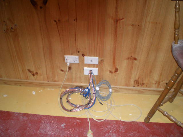

Bryce1963 Posted February 28, 2011 Author Posted February 28, 2011 I know how you feel. Scary isnt it !! Even scarier when the bride finds out what this is really going to cost and i haven't mentioned recliners yet ! Plasterer and sparky back today, walls and ceiling done, cornices etc go in tomorrow and the window will also then be boarded up. Architrave came off it today. Have posted some pics, probably not great quality as i'm still on floodlights for illumination. Not sure if it looks like much has happened from the pics but in standing in the room it is really coming along, the droppers from the ceiling are all flush down lights dimmer controlled Just need to push the button on the flush mount for the projector now.
Bryce1963 Posted March 5, 2011 Author Posted March 5, 2011 Plastering, wiring and lighting all completed. Now that window is gone i'm seriously reconsidering my plan for the 130' scope screen, i think i may be able to get a 140 into the space i have. Time will tell once i get the projector mounted. Painting will now be next and Rich's update on the forum re the black paint was very timely as the front wall and ceiling will be black. Not too far to go to get it either. I have one brick column which you may be able to just see in some of the pics which will be cement rendered and then painted the same color as the rest of the walls. (I love the look of the burgundy but may have to flip a coin as a deep blue also looks good). Am off OS tonight for a couple of weeks so things will grind to a halt. A few days up my sleeve once i get back and will probably have a paint brush in my hand i think. Minister for War and Finance actually interested now and wanting to provide all sorts of input usually after a decision has been made or work completed. Hopefully her interest extends to lots of toys to fill it with... Cheers Bryce

Bryce1963 Posted March 5, 2011 Author Posted March 5, 2011 Nice work Bryce it's really coming together.Did you wire for 5.1 or 7.1? Have a great trip! Simon Hi Simon, All wired up for 7.1. I have a Klipsch 5.1 set up currently (quintets) I will be using these as surrounds and am adding a pair of Reference series fronts and a matching centre channel. I have data in the room as well which will be relocated to the current points and plugs so that i can add a computer / media centre for streaming etc. I'm not the worlds greatest photographer as you can probably tell. Hopefully the pics tell the story adequately. More excited about the room than the trip, terrible isnt it... Talk soon. Bryce
