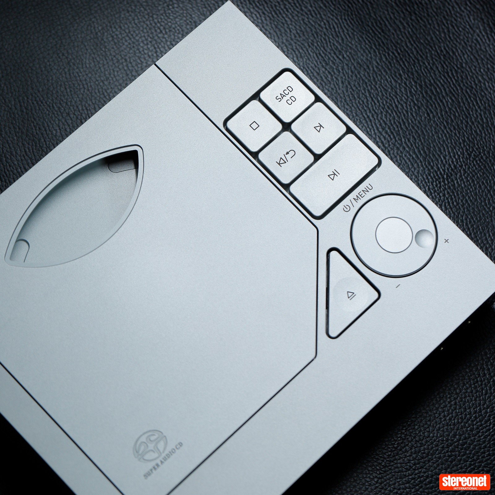

Lift the hood of the Design One, you’ll find an SACD mechanism built around the proven HD850 laser and MT1389EE system, promising accurate playback of CDs and both single‑ and multi‑layer SACDs. Meanwhile, the top‑loading design uses a custom magnetic disc clamp developed specifically for this model.

The chassis features a 2.79‑inch display (428 × 142) and is controlled via hardware buttons and customisable mechanical switches.
