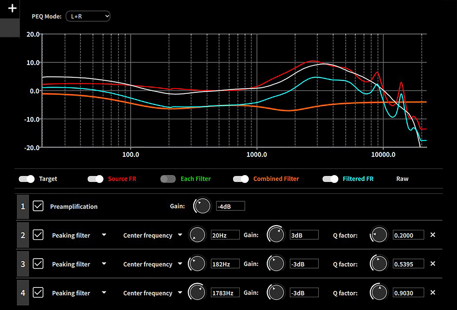

There’s room to tailor the sound, too, with a 10-band parametric EQ and selectable crossfeed, including a BS2B-based mode to ease long listening sessions. The industrial design makes the point visually. A glass top reveals the circuitry beneath, softly lit, with twin displays and a configurable UI completing a more considered, premium finish.
