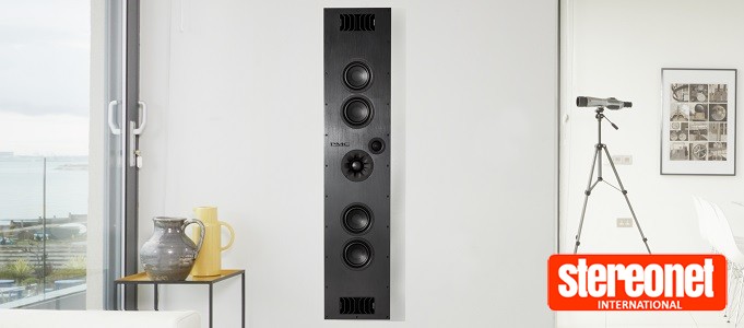

The first two models of PMC's all-new custom installation loudspeakers will be unveiled at the CEDIA Expo and so bring its technology and Hollywood studio audio quality to the installation sector.
The first two models, the ci140 and ci140sub, will be launched at CEDIA 2019, with the ci30, ci45, ci90slim and ci65 following in Q1 2020.
Designed from the ground up, the ci Series incorporates the proprietary PMC technologies and audio quality from its multi-award-winning audiophile speakers and studio monitors.

The drive units are developed from PMC's in-depth knowledge and comprise the LT woofer and the longer throw and higher power handling version, the LTx. The speakers are kitted out with 130mm (5.25-inch) natural fibre cones, the 50mm (2-inch) dome midrange and a 27mm (1.1-inch) dome tweeter.
The cabinets all feature PMC's respected Advanced Transmission Line (ATL) bass loading technology and Laminair vents, as well as a sophisticated, hand-built, precision crossover.
The LT & LTx long-throw woofers have a doped natural fibre dished cone and inverted dust cap that reduces unwanted high-frequency reflections from the cone surface. The high-power voice coils are mounted in a low-profile basket to fit in the shallow cabinets.

The four smaller models in the range are two-way designs, the flagship ci140 is a three-way design with four bass drivers.
BB5 mid-range tech
PMC has long been known for its dome midrange driver designs, which were first seen in the world's leading studio monitor speakers, the BB5. The ci140 is the latest to benefit from that technology being honed and trickled down into other PMC models.
The all-new 50mm (2-inch) dome features n-compass technology - a new dispersion flange for a flat frequency response and "phenomenal off-axis performance". Attributes that make it suited to either horizontal or vertical placement, as in a cinema LCR system.
Around the edge of the dome are two distinct geometric forms, one exponential and one hyperbolic. The designs form a complex profile to improve diffusion and uniformity over a wider area. Moreover, they produce better low-frequency dispersion and sensitivity as well as a smoother high-frequency dispersion without edge diffraction. The upshot of all that is an identical immersive audio experience from all listening positions.

The ci140 is complemented by the ci140sub, with the same four bass drive units operating within the ATL to reproduce additional low-frequency energy.
All speakers are supplied in a black finish, with square perforated bezel-less metal grilles in black or white.
