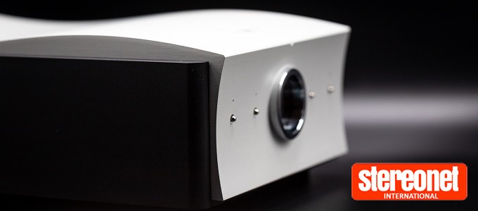

Mola-Mola Tambaqui
The Tambaqui's converter comprises a two board stack. Firstly, the incoming digital audio is upsampled to 3.125MHz/32 bits and converted to a noise-shaped PWM signal and then fed to twin mono DACs on the second board. Here, their discrete 32-stage Finite-Impulse-Response (FIR) output stages combined with 4th order filtering I/V converters turn the PWM into analogue with an awe-inspiring 130dB SNR. The company states that, uniquely, distortion remains below the noise floor even for full-scale signals.
The Mola-Mola Tambaqui also boasts a lossless digital volume control, Roon Ready functionality and headphone outputs. So, basically, you could use the Tambaqui as the control hub of a minimalist digital audio set-up.
