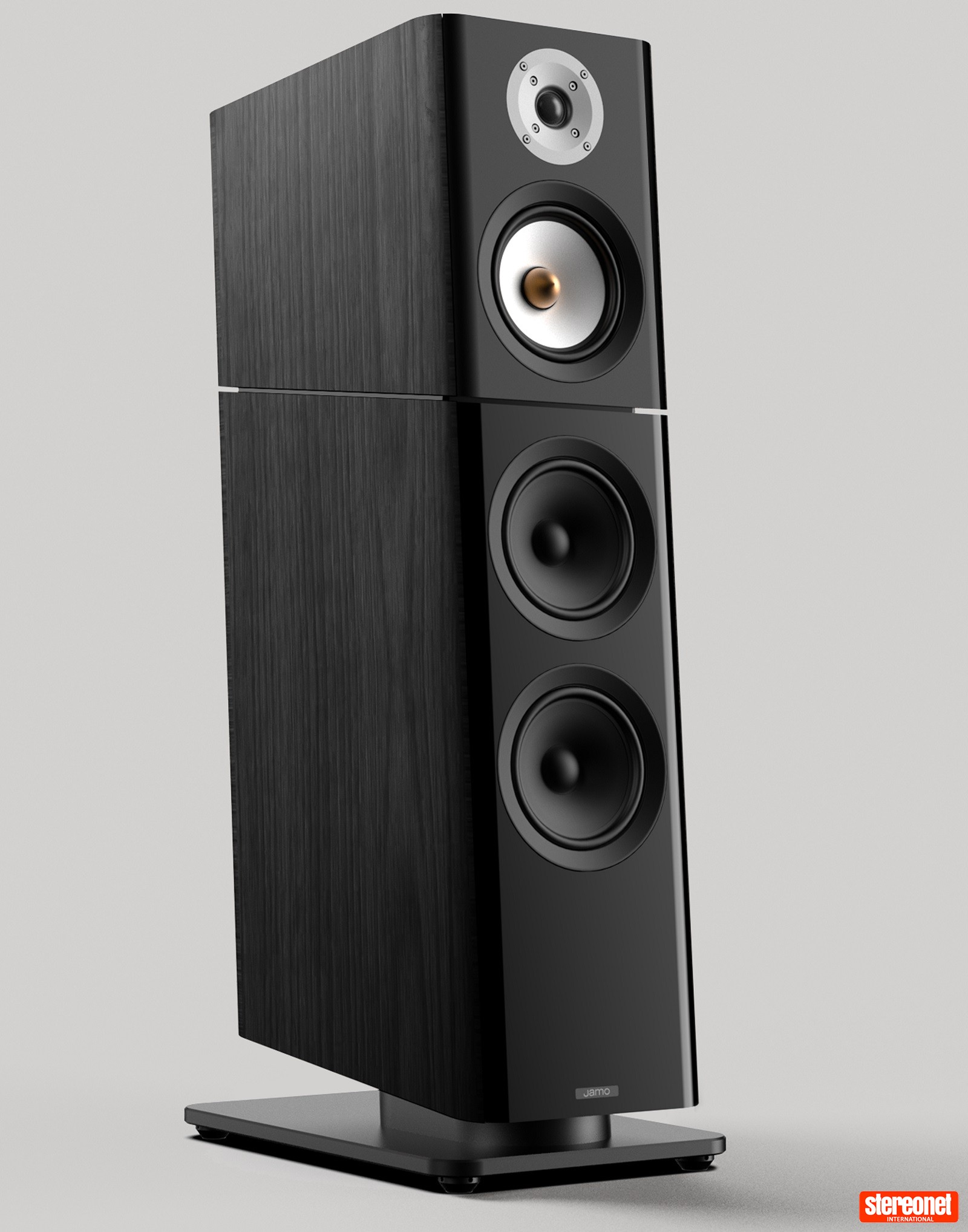

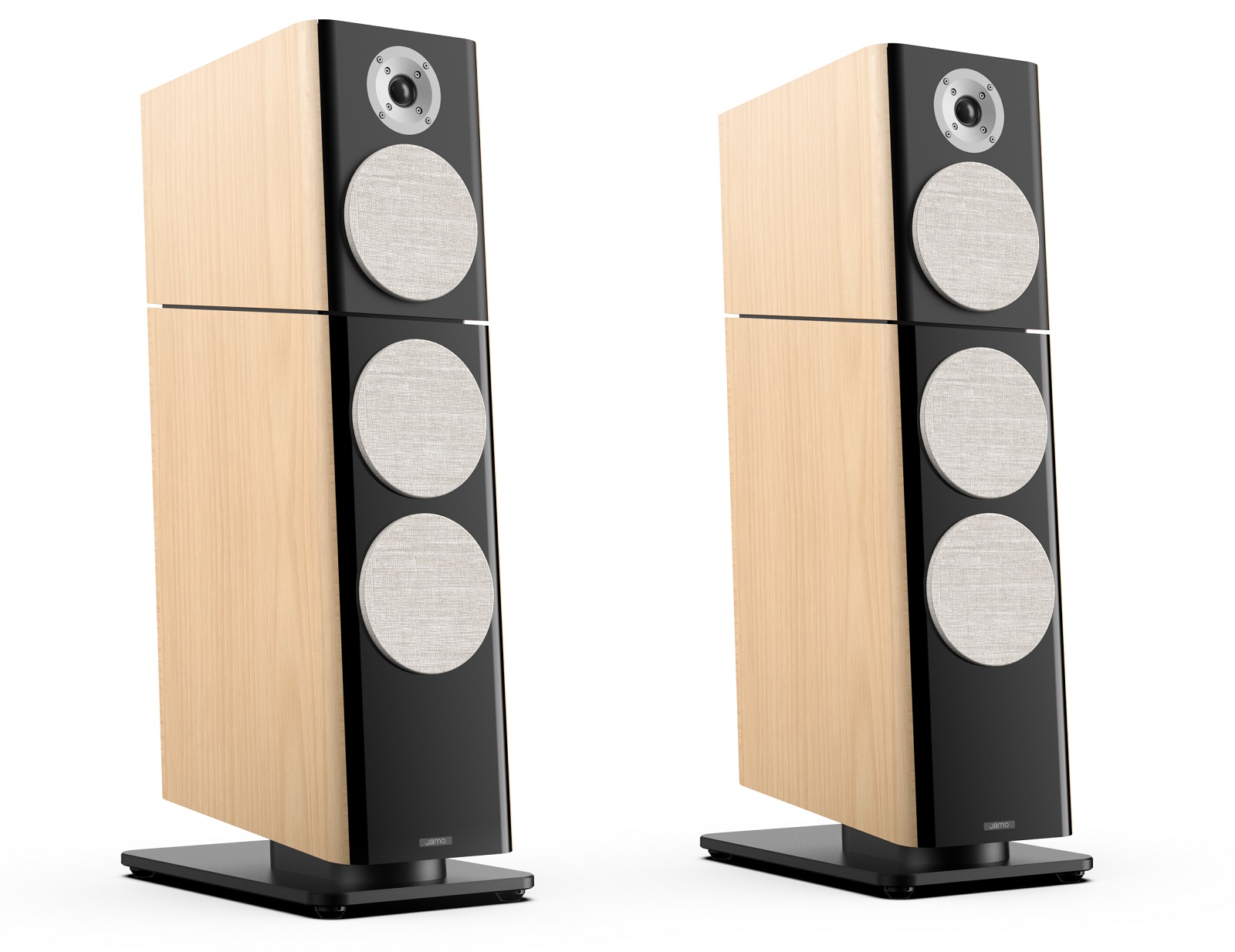

Concert Legacy 11
The Concert Legacy 11 is the range's flagship, presented as a 3-way bass-reflex floorstander.
Armed with three 165mm Scan-Speak woofers, a 165mm SEAS aluminium/magnesium midrange, and a 25mm Scan-Speak soft-dome tweeter up top. DualCore keeps the mid/tweeter in a sealed upper chamber, mechanically decoupled from bass pressure.
On paper, it’s 94dB sensitive into 4 ohms, with a quoted 32Hz–21kHz response (and a low-frequency cut-off number listed as 26Hz). Crossover points sit at 250Hz and 3kHz. Jamo recommends 50–250W of amplification.
Each speaker is a hefty 47.5 x 12.1 x 18.9 inches and 88.2lb.

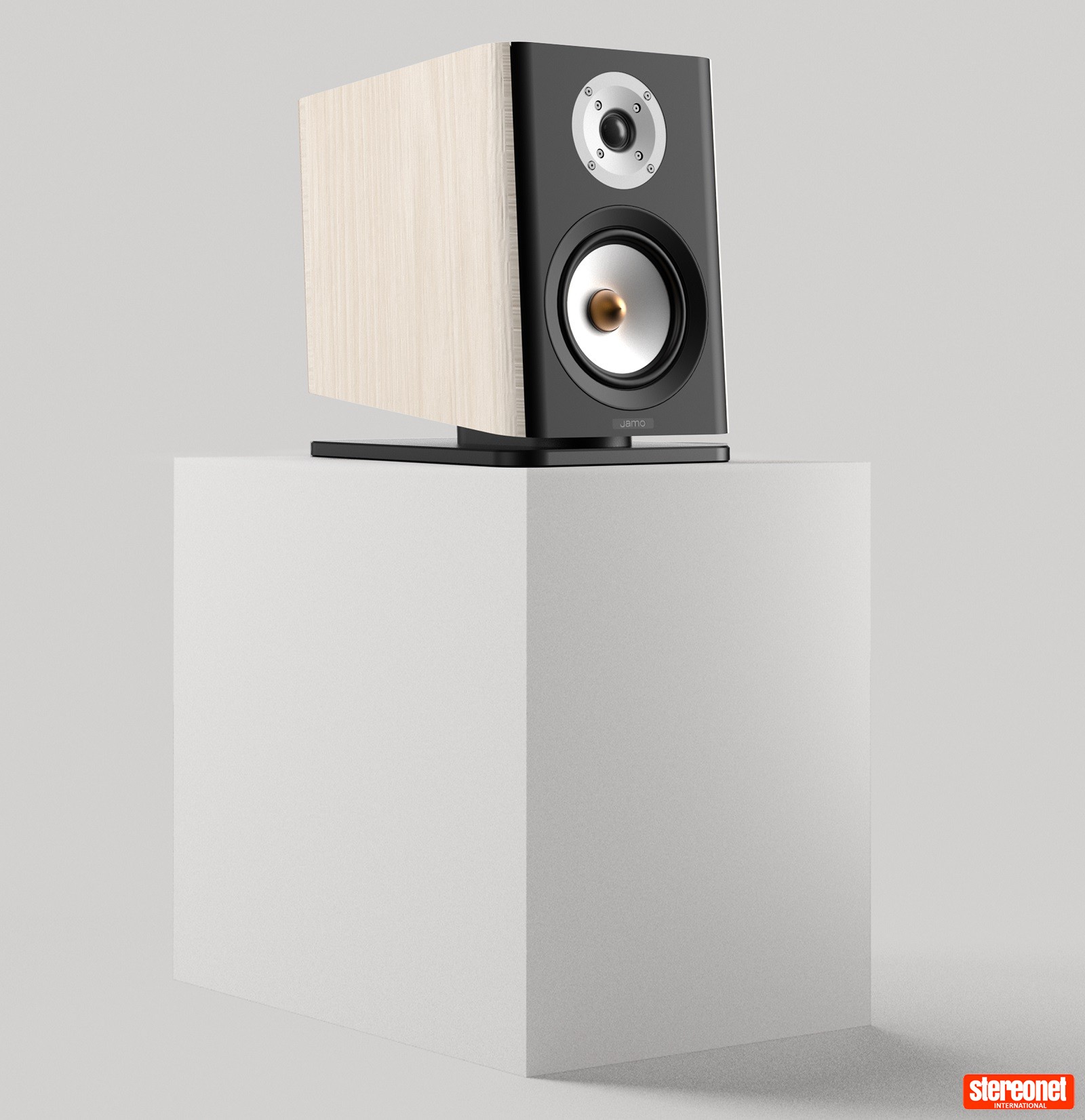

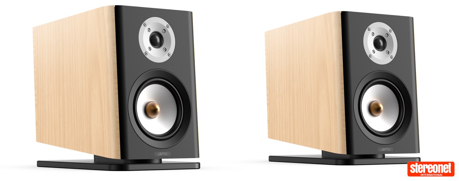

Concert Legacy 8
The Concert Legacy 8 is the standmount option: a 165mm SEAS aluminium/magnesium midwoofer plus a 25mm Scan-Speak soft dome.
Jamo highlights real oak veneer, a 40mm front baffle, bi-wire terminals, and a down-firing port to take some of the drama out of placement.
It’s quoted at 87dB into 4 ohms, with a stated 34Hz–21kHz response (and low-frequency cut-off listed as 28Hz). Crossover is listed at 3kHz, with 40–200W recommended.
Dimensions are 14.4 x 9.9 x 14.6 inches, and the weight is 26.5lb each.

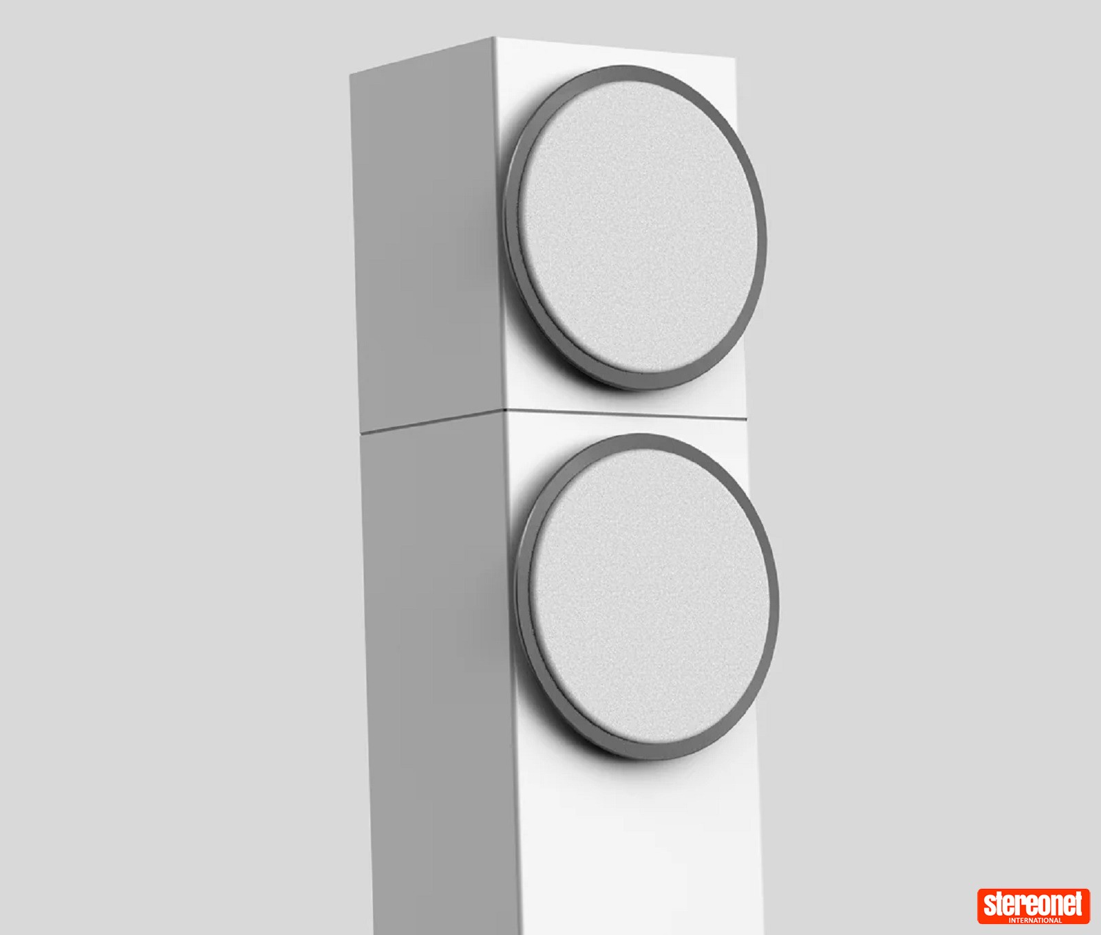

Jamo Concert Element
Concert Element is the more lifestyle-leaning side of the launch, created with Copenhagen design house HarritSørensen. Jamo calls it “circle over rectangle”: a bold, round driver pod pushing out from a slim cabinet. Like Legacy, these are passive speakers with down-firing ports.
Drivers are sourced from SB Acoustics and tuned for each model. The line-up includes the Element 50 (bookshelf), Element 70 (compact floorstander), Element 90 (larger floorstander), and the matching Element SW10 sub. Finishes offered are Onyx and Northern Frost, with magnetic grilles provided in dark grey and light grey.

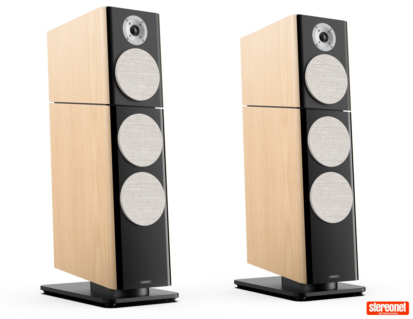

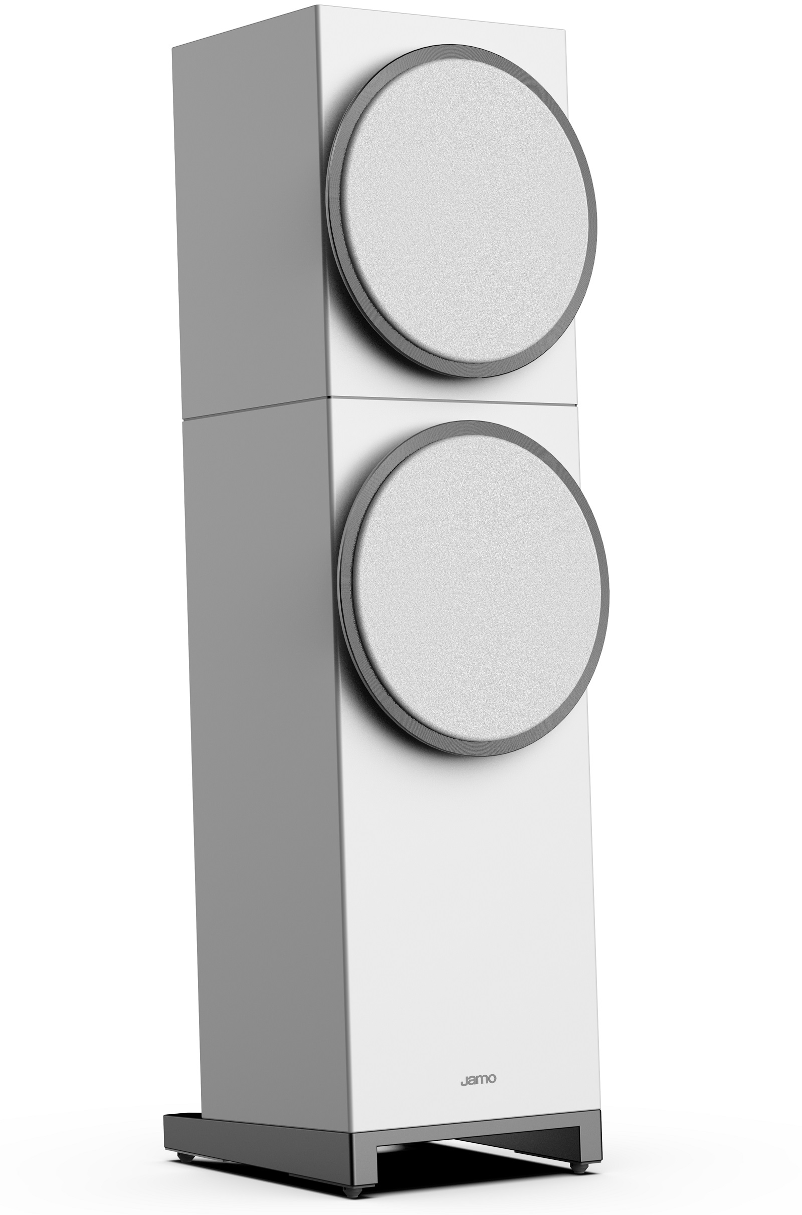

Concert Element 90
Element 90 is the big one: a 3-way bass-reflex floorstander with a 250mm woofer, a 165mm midrange, and a 25mm soft-dome tweeter.
Jamo claims Scandinavian nettle fibre cones for the woofer and mid, plus a dual-chamber cabinet (ported bass, sealed mid) and a down-firing port for easier positioning.
It’s quoted at 87dB into 4 ohms, with a 35Hz–22kHz (±3dB) bandwidth and a low-frequency cut-off of 30Hz (–6dB). Power-wise, Jamo suggests 60–250W.
Each speaker measures 43.8 x 12.6 x 14 inches and weighs 73.2lb.

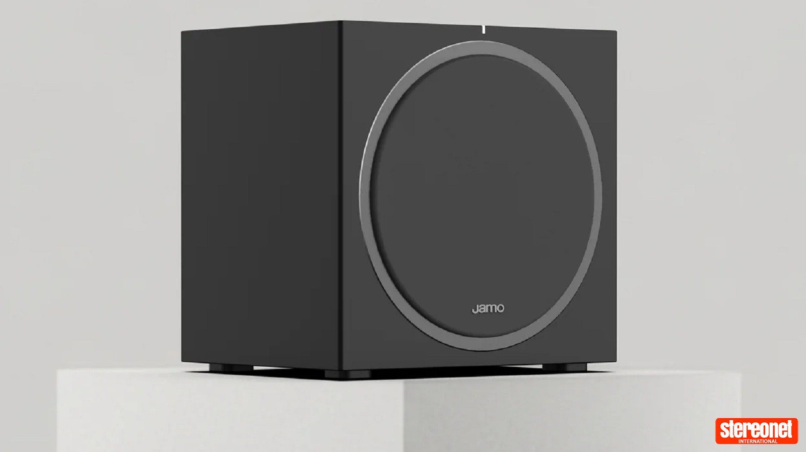

Concert Element SW10 Subwoofer
The Element SW10 is the matching subwoofer, built around a 250mm long-throw driver and Class D amplification rated at 150W RMS (300W max). You also get a variable low-pass filter (40–140Hz), phase adjustment (0–180°), and dual RCA/LFE inputs.
One spec needs clearing up, though: the feature blurb calls it sealed, while the technical sheet lists it as active bass reflex.
Jamo lists a 150W Class D amp (with a 300W max figure) and quotes a 30Hz–250Hz (±3dB) bandwidth, with a low-frequency cut-off at 20Hz (–6dB).
Controls cover a 40–140Hz low-pass filter, 0–180° phase, and an EQ boost at 55Hz. Connectivity is dual RCA plus LFE, with Auto/On modes.
It measures 14.2 x 14.4 x 11.6 inches and weighs 26lb.
