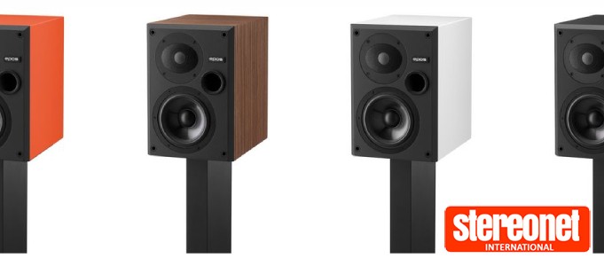

That said, we were told at The Bristol Hi-Fi Show 2024 that the "baby Epos" (29 x 20 x 27cm (HxWxD)) has been predominantly designed to work well sat inside a bookshelf or close to a wall without compromising the sound.
Enabling this feat is a neat switch on the rear, allowing you to select the correct crossover filter and choose between two versions of tonal balance to best suit the speaker's position. Flick the switch upwards if it is sat 30-50cm away from a wall, and nudge the switch to the down position if it's going against a wall or sitting on a bookshelf. For those of you considering placing the Epos ES-7N on stands, you're recommended to use one 70cm tall.
Epos ES-7N
Beyond the trick crossover, the asymmetrical ES-7N is a two-way design featuring a hybrid ceramic/aluminium tweeter with a 28mm voice coil as used in the ES-14N. This is partnered with a low-hysteresis 5-inch mid/bass driver made of a new mica-loaded polypropylene material developed for ES-14N's 18cm woofer cone.
Epos ES-7N
Meanwhile, the cabinet uses 2x8mm MDF panels with a high-loss damping layer in between to control unwanted resonances of the box itself. We're told that an additional wooden block on the top helps to optimise the stereo image. Additionally, only a single brace was necessary to make the cabinet quiet. The cabinet is finished with a double front baffle with chambered edges to reduce diffraction errors.
Epos ES-7N
The front port tube was apparently a challenge as it sits on the side of the cabinet – not ideal when you want to minimise the tube output of the standing wave modes inside the cabinet. The solution is a bent port ending centrally between the two side panels. It features selective damped ventilation holes in the middle to control the output in the critical mid-band.
