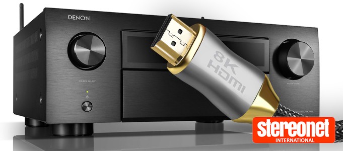

The latest glitch in the matrix has come from the new AV receivers of usually rock-solid brands Denon and Marantz. Both brands recently launched, to great fanfare, their first AV amps and receivers equipped with 'full bore' HDMI 2.1 ports capable of, so we were told, handling everything the latest HDMI standard could throw at them.
Now that sources capable of outputting such cutting-edge video formats have appeared, it's turned out that they come a serious cropper with 4K/120Hz sources.
If you try to feed a 4K/120Hz signal through the HDMI 2.1 ports on these new receivers, you get a blank screen on your display. According to German magazine c't, the source of the upset is the Panasonic Solutions HDMI 2.1 chipset that all the receivers use that renders them unable to handle HDMI 2.1's Fixed Rate Link (FRL) feature correctly - a feature that the Xbox Series X console and new Nvidia RTX 30 graphics cards use for their 4K/120Hz delivery.

The models affected are the Marantz SR5015, SR6015, SR7015 and SR8015, and the Denon AVR-X2700H, AVC-X3700H, AVC-X4700H, and AVC-X6700H.
As if the HDMI 2.1 issues weren't bad enough already, it's currently looking like they can't be fixed by a mere firmware update. In other words, a hardware replacement will be required—either of the entire AVR or the affected HDMI input board.
