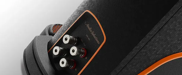

As well as the WBT Nextgen bi-wiring binding posts the Virtuoso is offered in seven different standard finishes, including a greyish colour which easily integrates into any environment. There are five saturated colours including a "mind-blowing Metallic effect" and a unique Flame Chameleon colour that changes from cold grey and cool blue up to warm red — a real eyecatcher.
