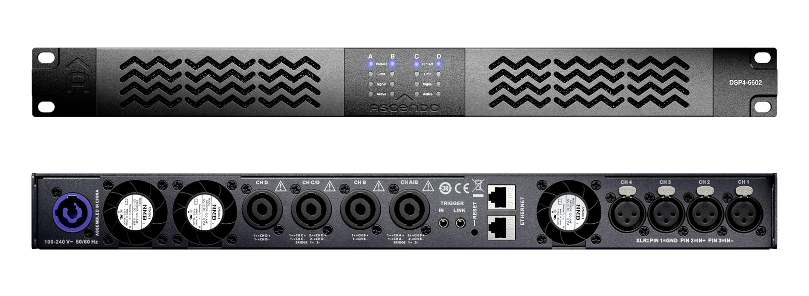

The DSP4-6602 is ASCENDO’s answer to that problem: a compact 1RU amplifier promising up to 6600 watts RMS of amplification capability. Yes, 6600 watts. It also claims sustained low-frequency output down to 5Hz, 2-ohm stability and bridgeable operation into 4-ohm loads.
If you look past the headline wattage numbers, the DSP4-6602’s purpose is clear. This is not a casual multi-room amplifier or a neat little cinema add-on, but a high-current workhorse built for ASCENDO’s larger infrasonic and high-output subwoofer systems, where control, extension and reliability all need to hold up through demanding low-frequency effects and room-shaking cinema dynamics.

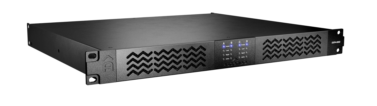

ASCENDO says the amplifier’s frequency response is typically ±1.0dB from 5Hz to 20kHz at 10 per cent rated power into 8 ohms. Rated output is listed at 4 x 650W into 8 ohms, 4 x 1150W into 4 ohms, and 4 x 1650W into 2 ohms. In bridged mode, the DSP4-6602 is rated at 2 x 2200W into 8 ohms or 2 x 3330W into 4 ohms.

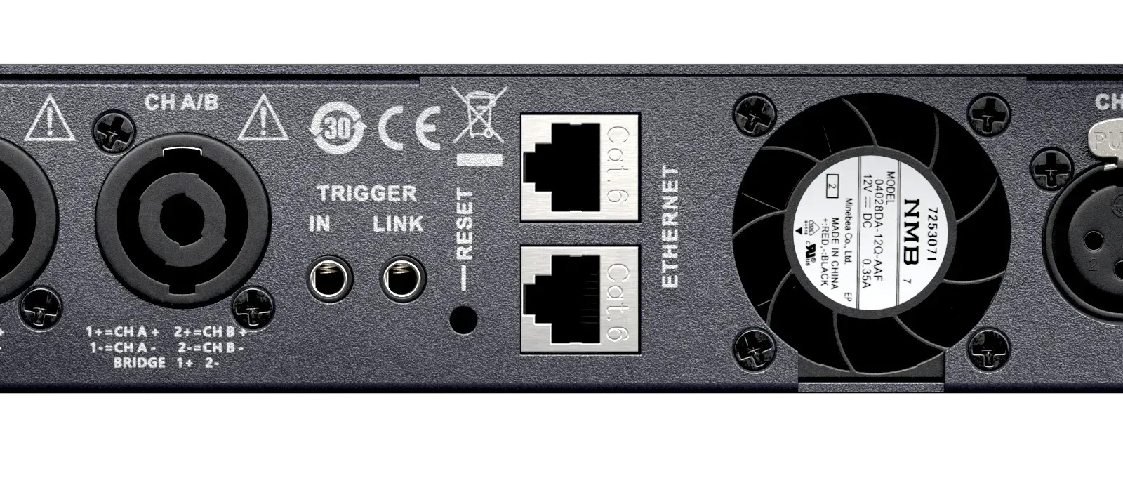

For installers, ASCENDO’s focus is not just on output, but on making that output easier to live with in a residential cinema. The DSP4-6602 is designed to deliver pro-level power without the rougher edges that can come with professional amplification in the home, adding low-noise cooling, selectable 12V trigger input logic, trigger output, configurable auto-standby and Ethernet-based multi-amplifier control.

The amplifier uses a low-impedance, high-current design, with an internal switching power supply incorporating active power factor correction and soft-switching technology. ASCENDO also notes that each amplifier includes integrated DSP, giving installers control over routing, delay, EQ, filters, level, mute, polarity and limiting functions.
According to published specifications, DSP features include input delay per channel up to 100ms, output delay up to 20ms in 0.01ms steps, 4 x 4 audio routing and mixing, eight-section input and output parametric EQ, high-pass and low-pass filters, FIR filters and configurable voltage limiting. Dante network audio functionality is also available on Dante-enabled models.
The DSP4-6602 is housed in a 19-inch rack-friendly chassis measuring 483 x 45 x 376mm and weighing 9kg. ASCENDO positions it for use either as a standalone flagship amplifier or as part of a larger rack-based immersive cinema installation. Regional pricing is expected to be confirmed shortly, and we’ll update the story as more information becomes available.
