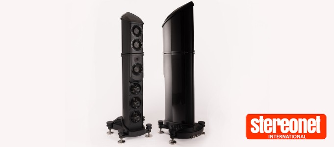

Wilson Benesch's Omnium 2.5-way floorstander follows the modular design philosophy that the South Yorkshire-based company adopted with its Odyssey Range in 2001. The high-end brand likens this approach to the Porsche 911, whereby each new design builds on the lessons of its predecessor so that it becomes "the latest evolution of a living lineage" rather than a new model.
The name Omnium also reflects this as it is Latin for "of all" and was chosen to recognise the three decades of research and development before it. However, as well as acknowledging the heritage behind it, Omnium also benefits from the next generation of materials technologies developed through a collaborative research and development project – SSUCHY. More on that, later.
WILSON BENESCH OMNIUM TECH
Wilson Benesch's Fibonacci Tweeter first landed in 2012, and the latest 1-inch iteration builds upon the Semisphere tweeter design. The Fibonacci tweeter faceplate is formed from a carbon fibre composite structure, creating a geometrically optimised waveguide tailored precisely to the unique output of the Silk-Carbon Hybrid tweeter dome, says the Sheffield company.
Wilson Benesch Omnium
With both the faceplate and motor decoupled from the rest of the tweeter chassis, we're told the tweeter not only achieves "ruler-flat frequency response" and ultrawide dispersion characteristics but also optimal frequency and timing integration with the Tactic 3.0 midrange drive unit.
The Omnium sports a trio of 7-inch Tactic 3.0 drive units (high and low bass, and mid-range), which retains the isotactic polypropylene cone, and continues to offer the optimal balance of stiffness and damping of the previous generation. The manufacturer states that this unique blend of material properties allows Wilson Benesch to maintain the crossover free, directly amplifier coupled design for the midrange drive unit while maintaining zero phase distortion. Furthermore, the new Fibonacci element results in a drive unit that produces perfect textbook roll off without any inductor, extended frequency response up to 4KHz and a flat frequency response within its operating range, boasts the company.Wilson Benesch Omnium
The principle low-frequency load of the Omnium is delivered by a series of Isobaric Drive Systems. This, we're told, reproduces an incredibly tight and controlled bass response perfectly integrated with the midrange Tactic 3.0 drive unit.
We're informed that the step-response of the three 7-inch drivers in the  Isobaric Drive System is almost identical to that of the Tactic 3.0 midrange drive units, ensuring almost perfect integration across the audio band.
Finally, the carbon fibre composite top may be striking, but its complex form is critical to the performance of the loudspeaker as, by removing flat, reflective surfaces and creating complex curved structures, sound waves striking the loudspeaker enclosure are scattered and their energy and therefore audible presence reduced.
The Omnium stands on feet hewn in-house from a single 80kg billet of aluminium apiece to create a single 38kg foot. These with the 14mm tie bolts that generate a metric ton of compressive pressure through the Omnium enclosure form the loudspeaker's foundation.
The resulting 140kg, 180 x 63cm x 28cm (HxDxW at baffle - feet measure at 59cm wide) tower has a claimed 28Hz – 30KHz +/- 2dB frequency response with sensitivity listed at 89dB and nominal impedance, 4.5 ohms.
