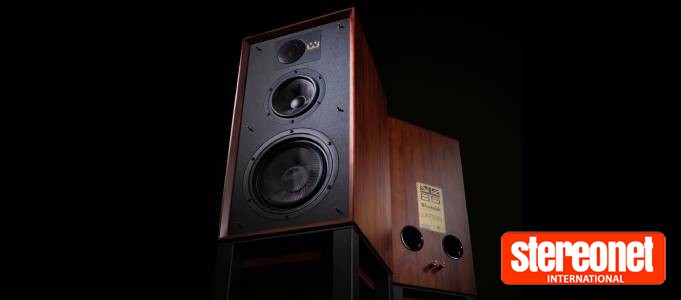

The new Linton continues the original's DNA. Not only is the new kid a three-way standmount model, but it also shares similar dimensions to the original through its wood-veneered, vintage-look cabinet.
Check out our Wharfedale Linton Review!
The Linton makes use of its wide baffle by incorporating a 200mm Kevlar-coned woofer that's mounted on a rigid, die-cast chassis. Above the woofer sits a 135mm midrange driver, also sporting a woven Kevlar cone and housed within its own internal enclosure. Finally, a 25mm fabric-dome tweeter with a high-flux ferrite magnet handles high frequencies.
Wharfedale Linton Heritage
Wharfedale says the new Linton retains the sound quality of the original but upgrades the performance in every department.
The new generation Linton also offers specially created optional speaker stands.
The rigid metal frame ensures critical damping of unwanted vibrations, whereas the wood-veneered panels at the top and bottom complement the speakers. The design even provides space to store vinyl records within the stand's structure.

  • Configuration: Three-way standmount speaker
  • Enclosure type: Bass reflex (2x rear-firing ports)
  • Bass driver: 200mm woven Kevlar cone
  • Midrange driver: 135mm woven Kevlar cone
  • Tweeter: 25mm textile dome
  • Sensitivity (2v @ 1m): 90dB
  • Nominal impedance: 6 Ohms
  • Recommended amp power: 25-200W
  • Peak SPL: 110dB
  • Frequency response (+/-3dB): 40Hz-20kHz
  • Bass extension (-6dB): 35Hz
  • Crossover frequencies: 630Hz (bass/midrange) and 2.4kHz (midrange/treble)
  • Speaker dimensions (HxWxD): 565x300x330mm
  • Stand dimensions (HxWxD): 437x300x330mm
  • Weight per speaker: 18.4kg
