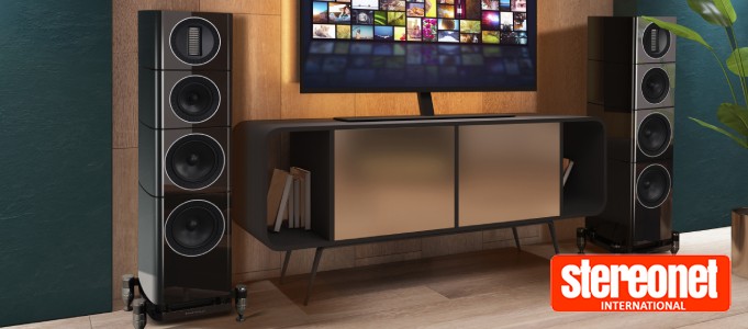

Wharfedale's new Elysian 3 takes the three-way, four-driver design of the 1188x402x432mm (HxWxD) Elysian 4 and delivers it in a more easily accommodated 1050x263x285mm (HxWxD) form factor. This works out at about 11 per cent shorter than its larger sibling but a third less wide and deep, handing it a much more compact footprint.
Wharfedale Elysian 3
Wharfedale promises the Elysian 3 "delivers the same combination of driver, crossover and cabinet engineering that makes the Elysian Series such a uniquely enticing high-end proposition". Here you will find a 27x90mm AMT treble driver combined with a 150mm midrange unit and two 180mm bass drivers, which should be capable of conveying the detail and emotion of any music you prefer through a claimed 44Hz-22kHz (+/-3dB) frequency response and 89dB sensitivity (2.83v @ 1m). Nominal impedance is stated at 4 ohms but 8 ohms compatible.
