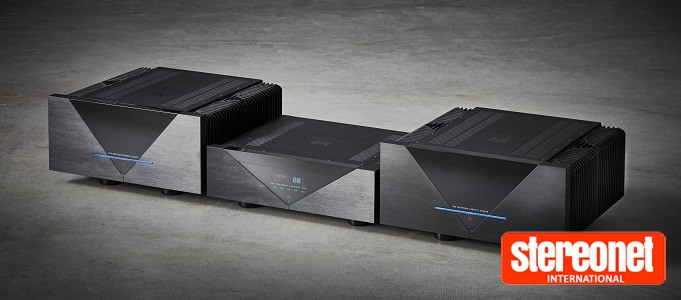

The Gryphon Essence pure Class A amplification system has been developed based on the experience acquired and lessons learned from the top-flight Gryphon Pandora preamplifier and the stereo and monoblock Mephisto power amplifiers.
The Gryphon Essence

Gryphon Audio Designs Essence Pre-amplifier
The Essence Pre-amplifier sports a dual-mono configuration and achieves the shortest possible signal path with minimal internal wiring.
Superfluous circuity such as tone controls, balance controls, headphone connections, mono switching, polarity inversion and more have been banished from the signal path. The result is reduced interchannel crosstalk and signal path colouration.
The Gryphon Essence
The Gryphon Essence pre-amplifier is a pure line pre-amp with a pair of balanced XLR inputs and three single-ended phono inputs. With no internal wiring, the only cables found are a short ground lead, display ribbons and AC power wiring mounted in a shielded channel from the rear IEC socket to the power switch to minimise 50/60 Hz interference.
