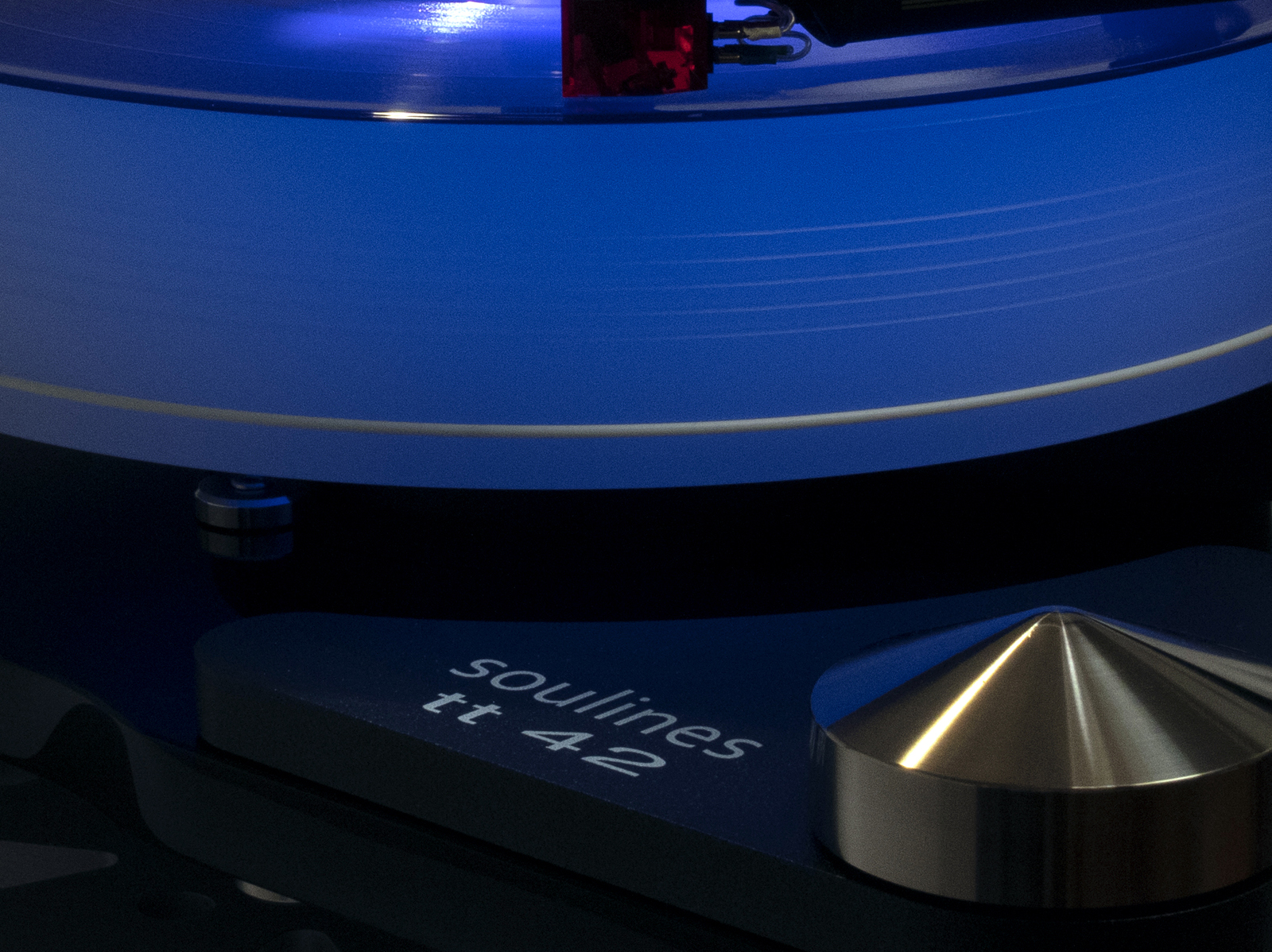

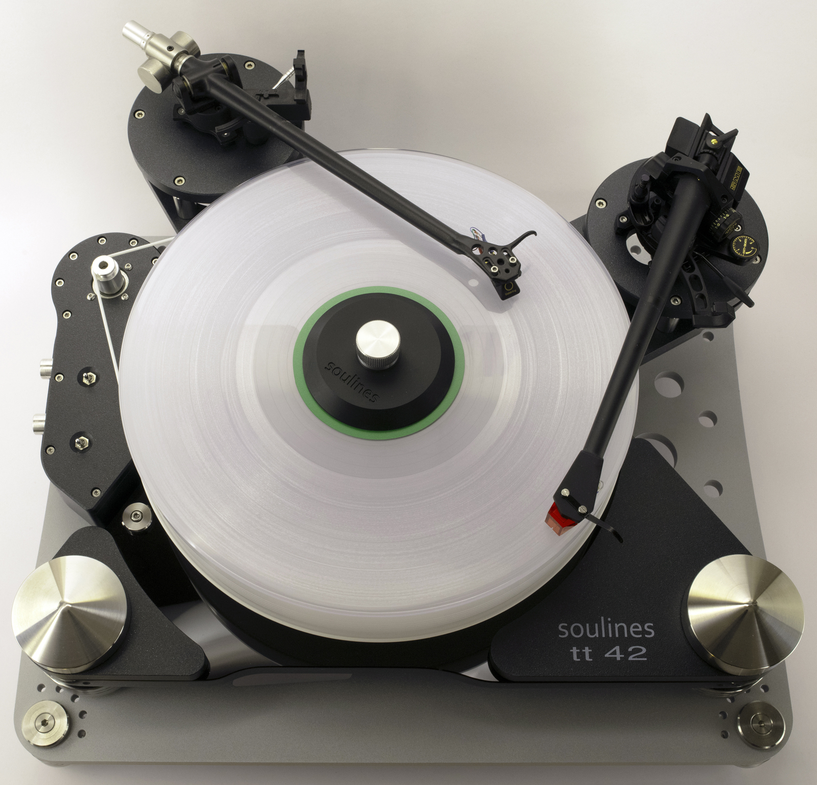

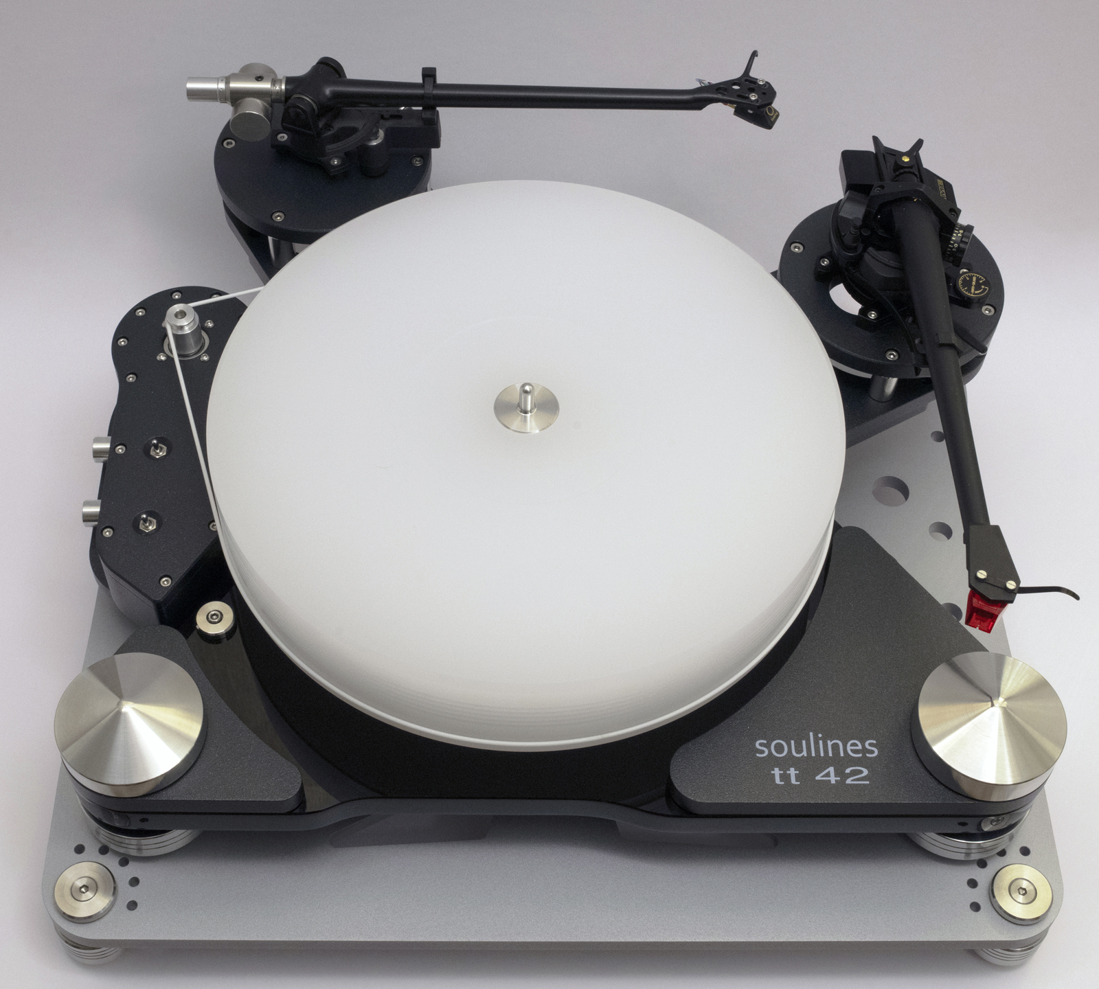

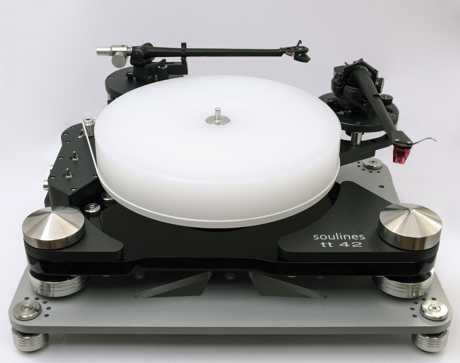

In designing the tt42, Igor tells us he once again turned to 3D-modeling software, while employing the Golden Ratio and Fibonacci sequence to attain a fully mechanically balanced system. Thus, the centre of mass of the turntable is placed onto the vertical axis of rotation of the main bearing shaft/platter. This is said to reduce the moment of inertia to the very centre of the mass.

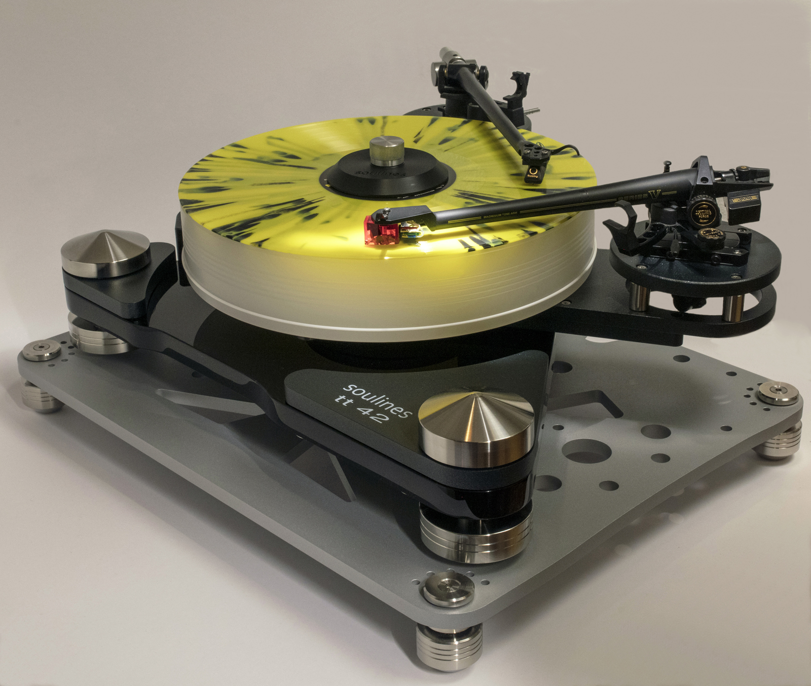

To gain uniform vibration damping across the whole frequency spectrum, Igor employed various materials, each chosen for the plinth and sub-plinth components according to their specific mechanical characteristics. All the components are precisely CNC machined and hand-finished to the highest standards.

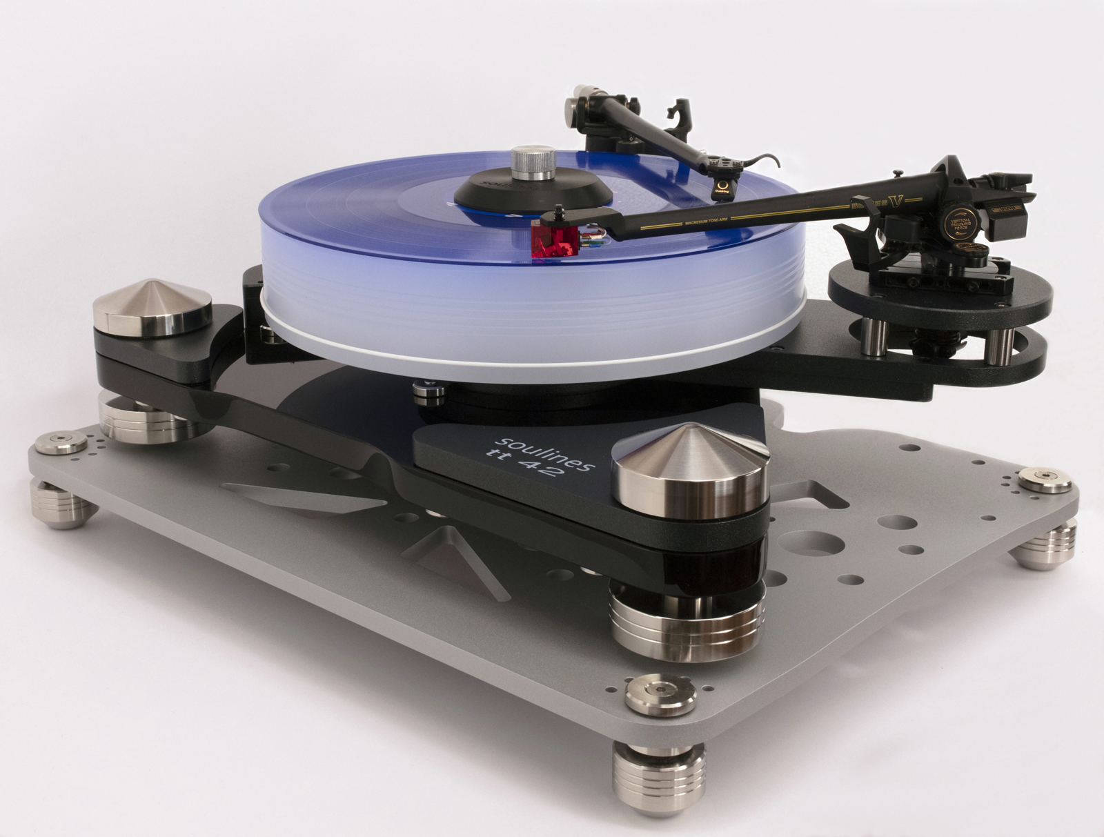

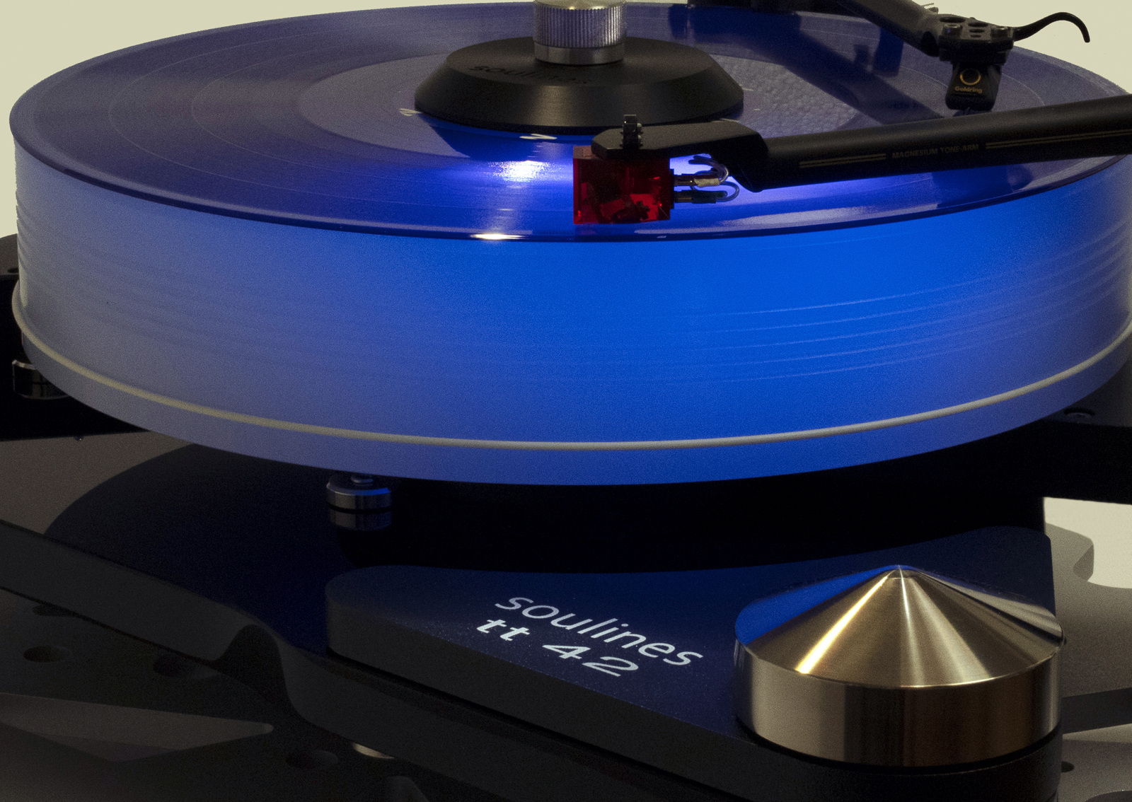

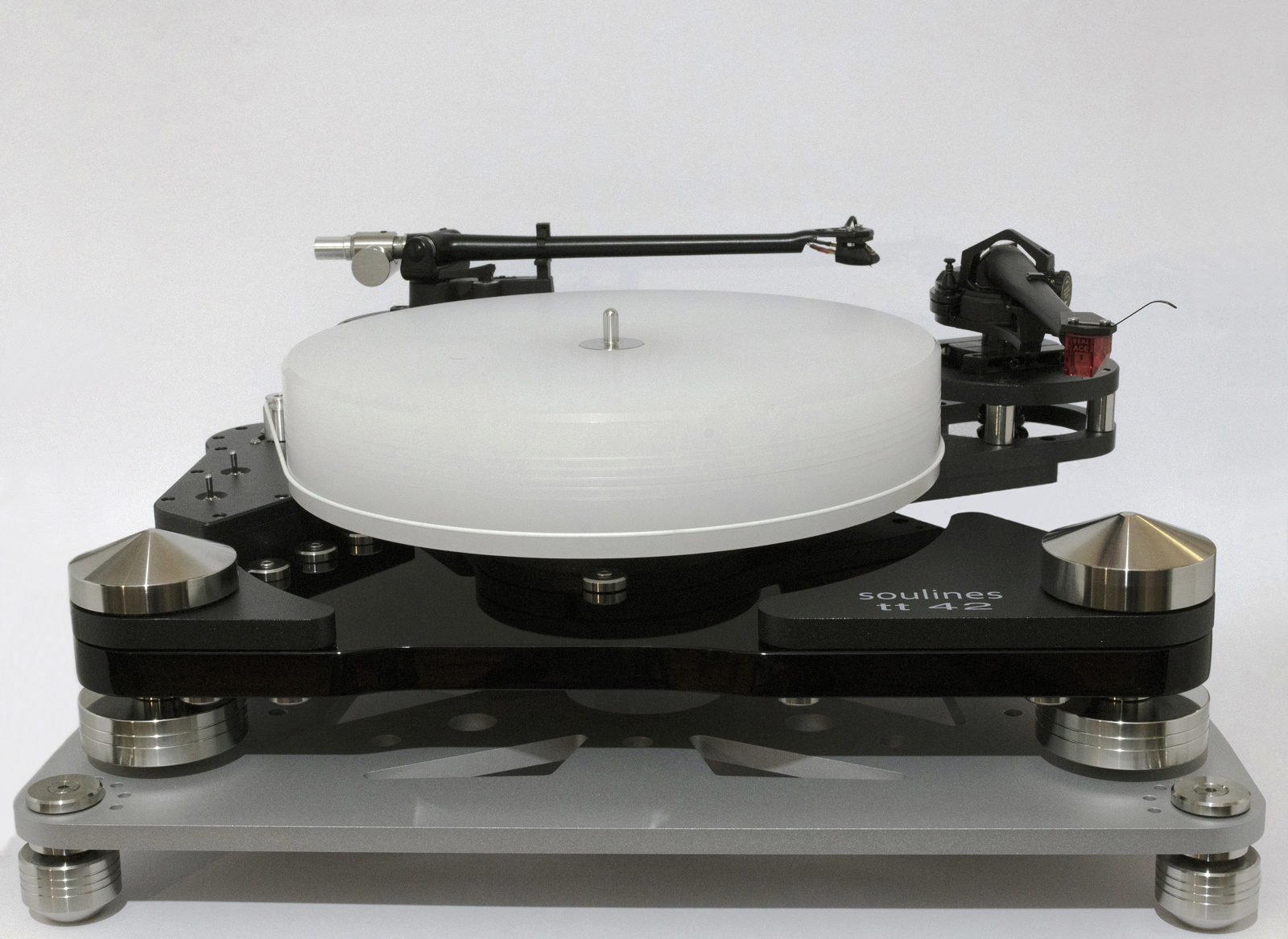

The platter is manufactured from 60mm thick acrylic, weighing 5.4kg and is machined from laminated cast Acrylic to precision accuracy. The massive aluminium sub-plinth and motor assembly are 3-point or 4-point coupled over differently sized rubber-cork washers for damping - gaining maximum control of the vibrations transfer through the complex plinth/sub-plinth/motor-pod assembly.
Both arm-pods and the main bearing assembly are tightly mounted directly onto the CNC machined aluminium sub-plinth, which is in turn 3-point coupled to the main acrylic plinth, once again utilising differently sized rubber-cork washers used for additional damping.
The inverted main bearing assembly is also CNC machined to the tightest of tolerances, with the bearing top hub machined from solid stainless steel with a brass sleeve insert and Delrin thrust pad. A polished stainless steel shaft holds the captive hardened steel ball bearing. The main bearing assembly and platter and manufactured in pairs to fit one another precisely, rather than manufactured in batches.

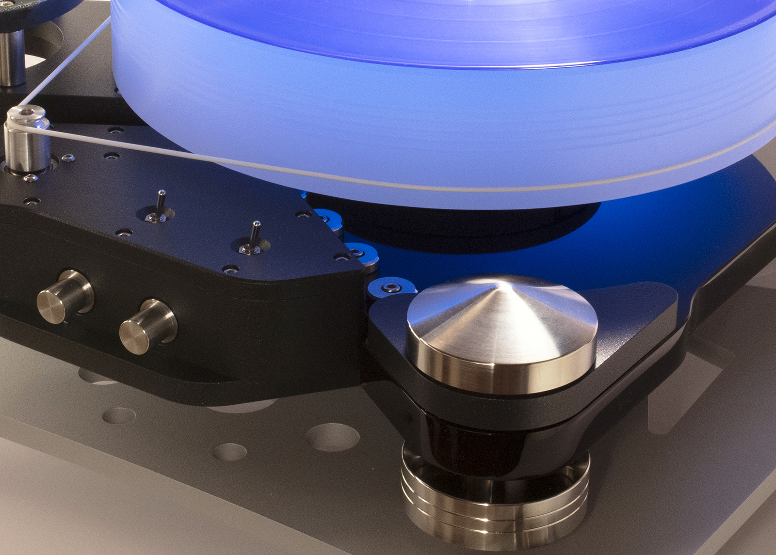

The tt42's drive mechanism utilises a powerful, high torque brushless DC motor and an integrated speed control electronic driver. The motor controller is a true analog device, says Igor, "providing constant speed and uniform rotation, which ensures perfect natural dynamics, timbre, timing and musicality of every record played". A fine speed adjustment feature is provided for both speeds 33.33rpm and 45rpm.

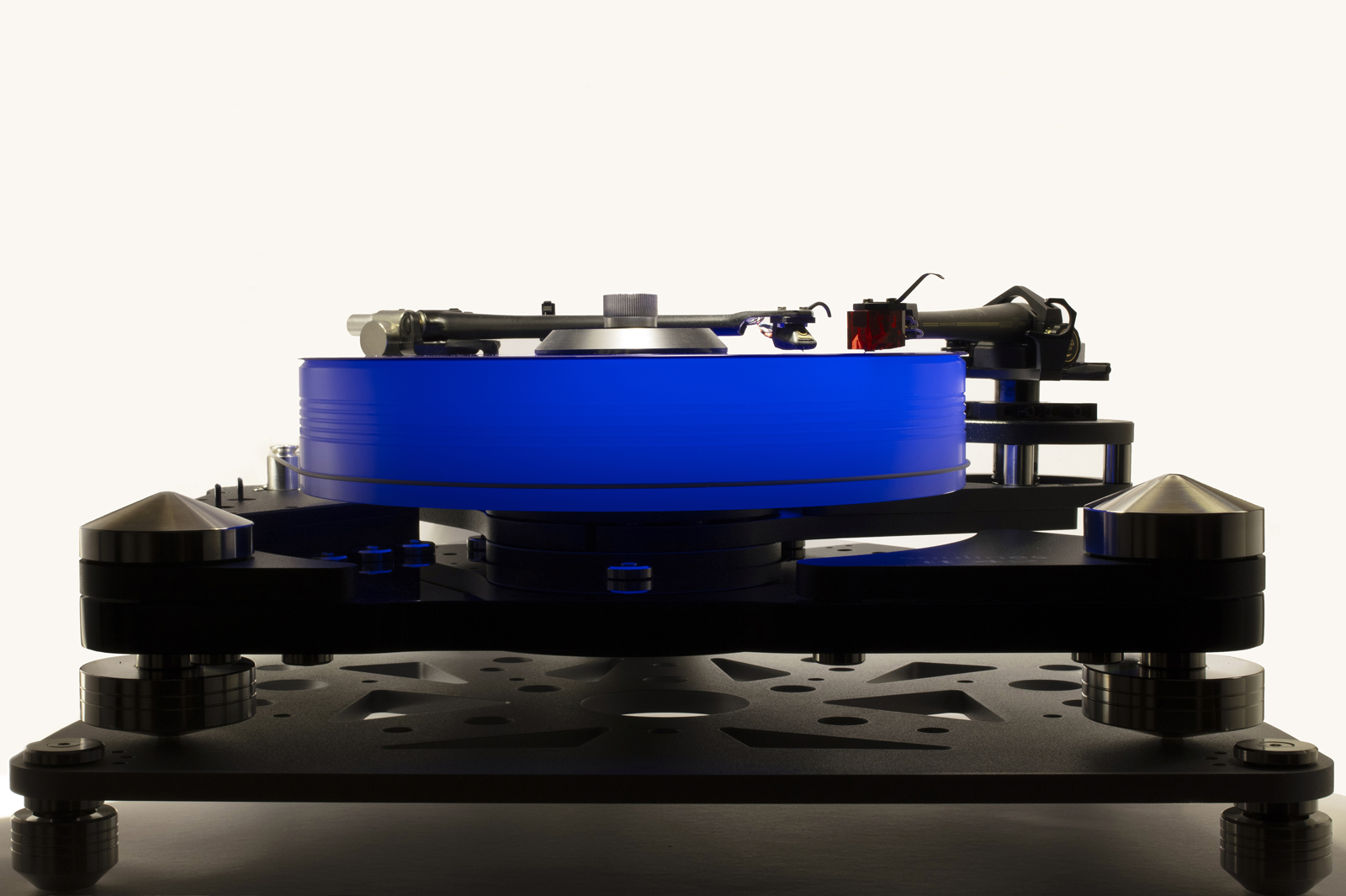

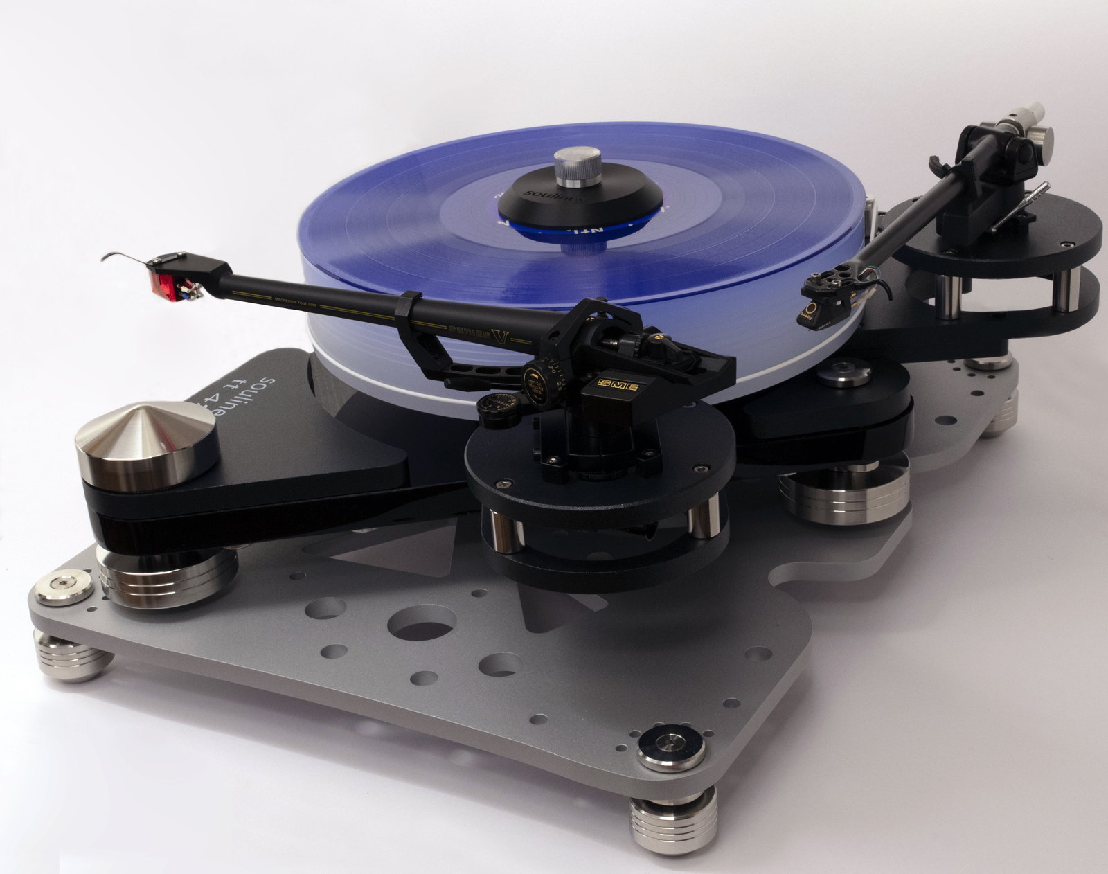

Supporting the turntable are three adjustable oversized cone feet machined from solid stainless steel - allowing precise levelling and optimum coupling to the surface that it sits on. The cone feet are coupled to aluminium pods over rubber-cork washers of different diameters. In turn, the aluminium pods are 3-point coupled to the main acrylic plinth using differently sized rubber-cork washers for damping. Igor says this complex approach means any structural vibration breakthrough (from the environment through shelf/rack/stand) is minimised.

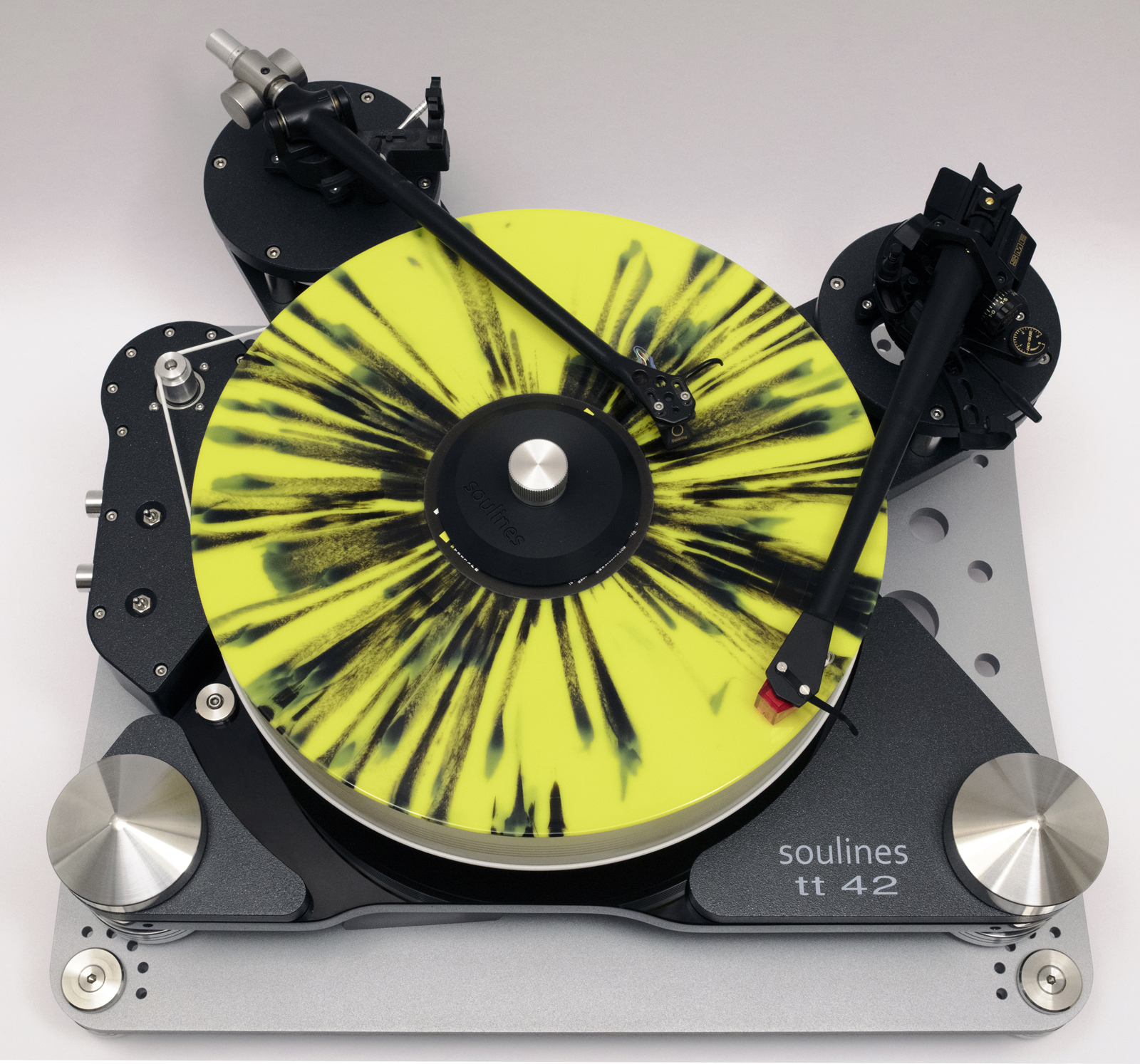

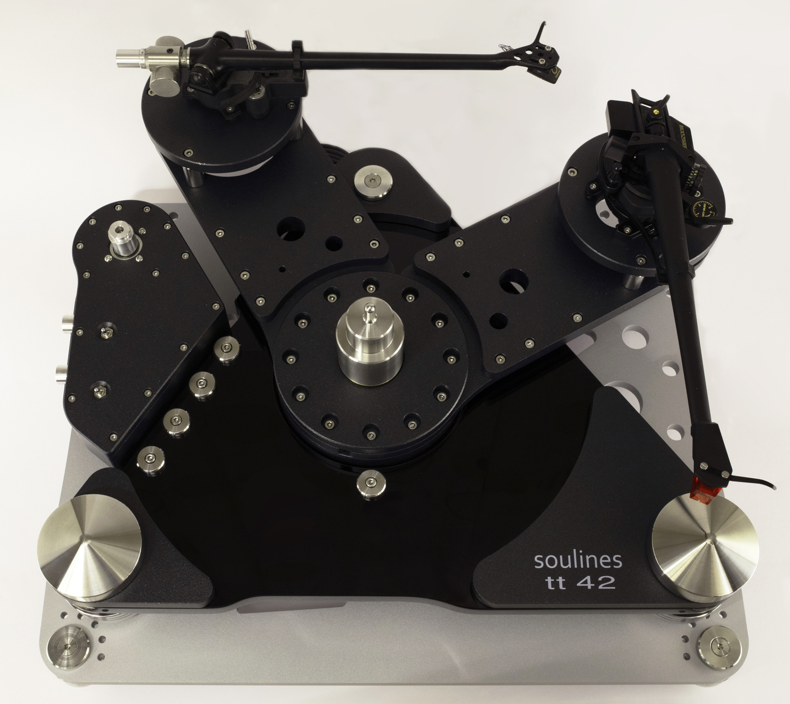

The two identical arm-pods consist of several parts: the upper part, the lower part, and the arm-board (SME x 2, Jelco/Linn/Ortofon, Rega/Origin Live/Audio Note/etc. mounting standard), which are all CNC machined from aluminium, while three sets of 4 spacers of different heights (15, 20, 25 mm) are made of stainless steel. A clever mounting system allows for easily changing the geometry for different tone-arms lengths, 9 or 12 inches.
The right arm-pod with an SME arm-board is factory fitted as standard. Mounting of the second (left) arm-pod which comes partially assembled is also said to be simple. Custom arm-boards will be available through Soulines, by request and upon sending technical drawings of the particular tonearm specific mount.
