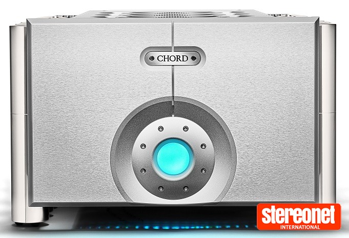

Chord Electronics ULTIMA mono power amp
Chord Electronics' proprietary amplifier technology has seen numerous refinements and updates over the past 30 years. However, ULTIMA receives John Franks' all-new circuit topology.
The new dual-feed-forward error-correction amplifier technology was first implemented on a medium scale in the Etude power amp (unveiled at High End, Munich in 2018). Realising its significant benefits, Chord Electronics started work on a replacement circuit for its range of uncompromising full-size mono amplifiers, ULTIMA being the largest, most advanced and most powerful in the portfolio.
The ULTIMA mono amplifier unit has an incredible 64 proprietary MOSFET power devices that demand the most advanced and refined drive circuitry, suitably devoid of sound-degrading components. The drive circuitry features an ultra-low-distortion, high-voltage amplifier operating at very high speed: 300 volts per microsecond technologies with advanced feed-forward and feedback compensation techniques. Additionally, it also benefits from Chord Electronics' TO3-style dual die lateral matched MOSFETs. Those transistors are continuously monitored with output stage error-correction circuitry and feature fully balanced input circuitry with DC-tracking servos and full temperature compensation.
With a name such as ULTIMA, you would expect it to be potent. Fortunately, it is with 780 watts into 8 ohms, 1,400 watts into 4 ohms and 2,500 watts into 2 ohms. ULTIMA's peak output current exceeds 500 amps, an extremely high current differentiated by the speed at which the dynamic peaks can be delivered. That list all adds up to, we're told, astonishing dynamics, fidelity and unrivalled musicality.
