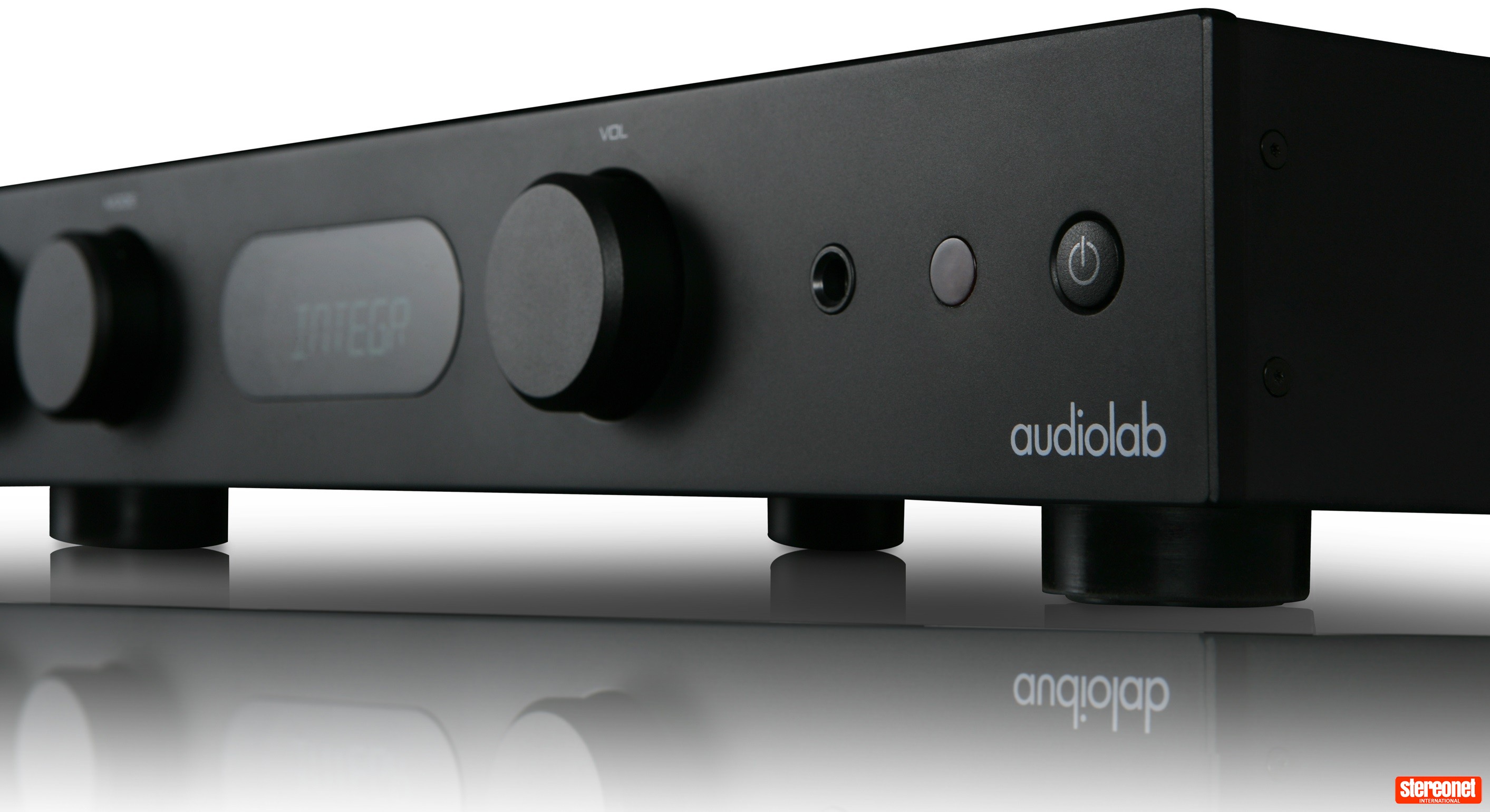

Audiolab 6000A
Audiolab 6000A
The 6000A shows its heritage with nods to the 8300A through its rotary controls and large, central OLED display. However, the 8300A costs £899, whereas the 6000A's recommended price tag is just £599. Furthermore, unlike its costlier, analogue-only sibling, the 6000A incorporates a high-quality digital to analogue converter (DAC).
