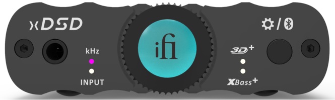

To power on the xDSD press the centre of the volume control dial for a few seconds. As soon as the lights come on, it will be in the mode you last had it in - either wired or wireless (Bluetooth). Holding the power button in for longer still will switch between those modes - in theory. One day I accidentally switched over to Bluetooth mode, and while my love for Girls Aloud was being outed, I frantically attempted to get it back to wired without any joy. Eventually, all was as it should be, but it didn't appear that straightforward at the time.
iFi xDSD red dial
Similarly, holding in the settings button during powering on will switch the line-out mode on or off. Line-out mode fixes the output to a standard 2V and sets the volume LED in the centre of the dial to white.  When using the xDSD for regular headphone listening, the hub glows with different colours at different volume levels. The colours range through blue-magenta-cyan-green-yellow-red as volume increases. There is also a colour-coded LED indicator for sample rates.
Additionally, there are status LEDs for 3D+, XBass, and charging. However, in such a compact device this could be confusing for some users. That said, I do wonder how many users will be bothered about the sample rate indicators, especially as the xDSD will most likely be in the velvet carry pouch.
The 3D mode and X-Bass mode provides a gentle widening of the soundstage and a mild bass boost, respectively.
