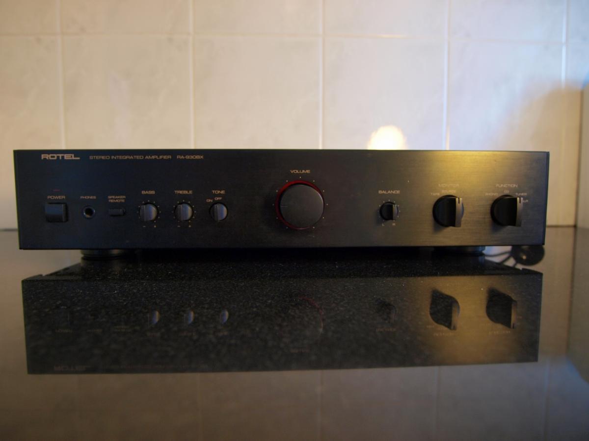

After selling my big Akai I put this little Rotel integrated that I have owned since new back into my system. I noticed some crackling on the tone controls and also the input selector, so a little bit of Deoxit was required.
Classic 90s face

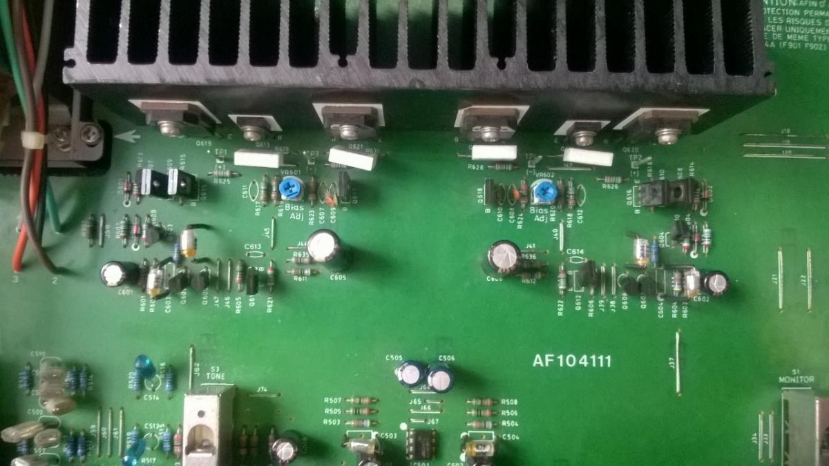

Lid off, and look at all that room to move!
I didn't check the bias because I don't have a multimeter at this time, but it is easy enough: TP1 (+), TP3(-) then the well labelled bias adjust to 4mV. Repeat for TP4(-) and TP2(+) and done.

Nice large spacing, made it much easier to get the straw into the pots
post-139427-0-82417000-1453010888_thumb.
Came up a treat and the small amount of static is now gone.
