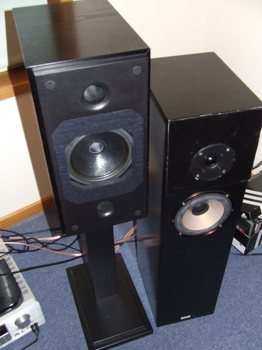

Homemade floorstanding speakers.
- Bass driver Sony Quick Edge Woofer.
- Tweeter Vifa BC25TG18-04 with cardboard flush mounts. But eventually I will get the tweeters flush mounted into the baffle.
- 18mm MDF.
- Satin black and grey paint which I did myself. But might repaint them high gloss black after the tweeters are flush mounted.
- Tuned to 45hz, rear ported.
- Internal foam on all walls.
- Ultra thick internal wiring.
- Great sounding speakers that can play very deep. Nice warm mids and good highs, good imaging. Can go down below 30hz. The intention was to create something average that could go deep but very pleased with the mids, highs and imaging. Excellent for powerful sounding music.
- No crossover, the capacitor attached to the woofer which filters out the highs on the tweeter. I tried a crossover once but removed it.

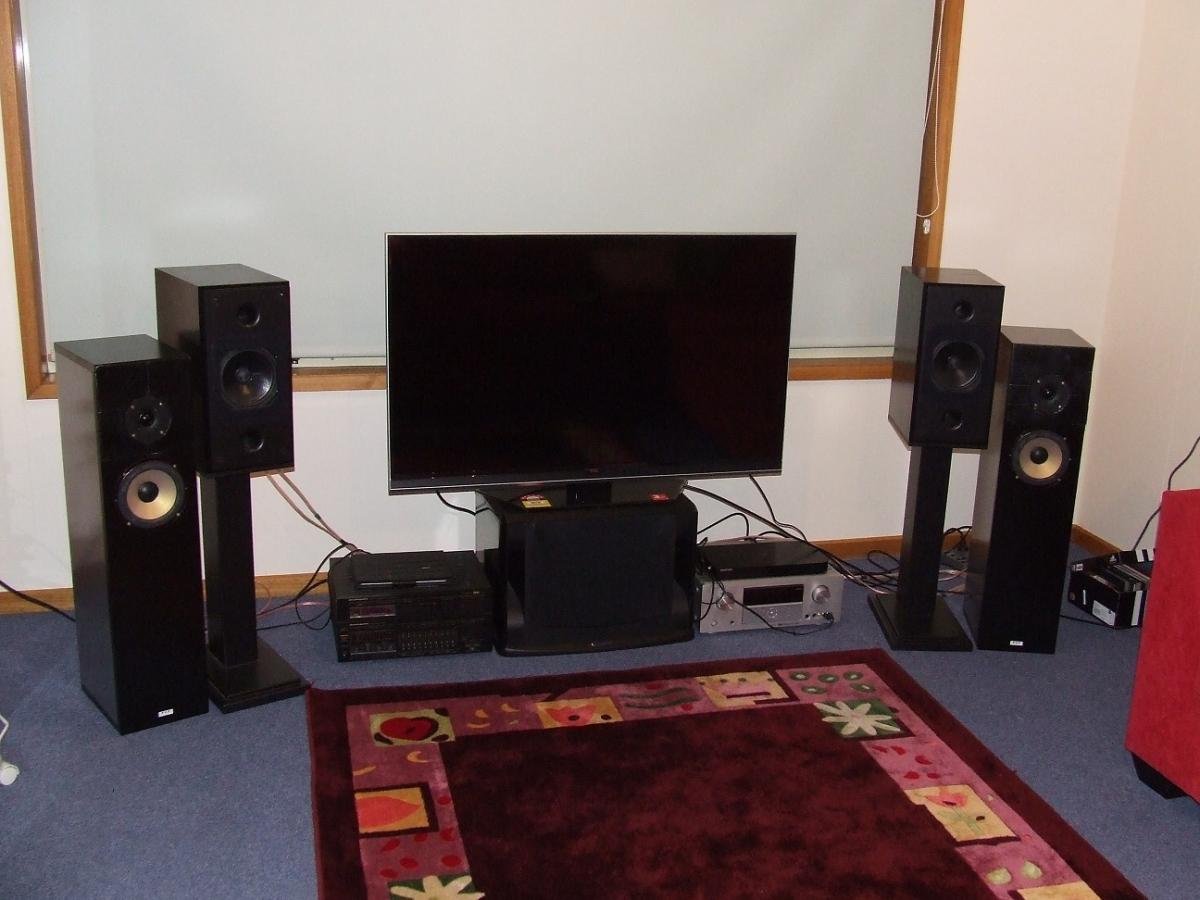

post-107081-0-97593300-1436541088_thumb.
Grilles on.

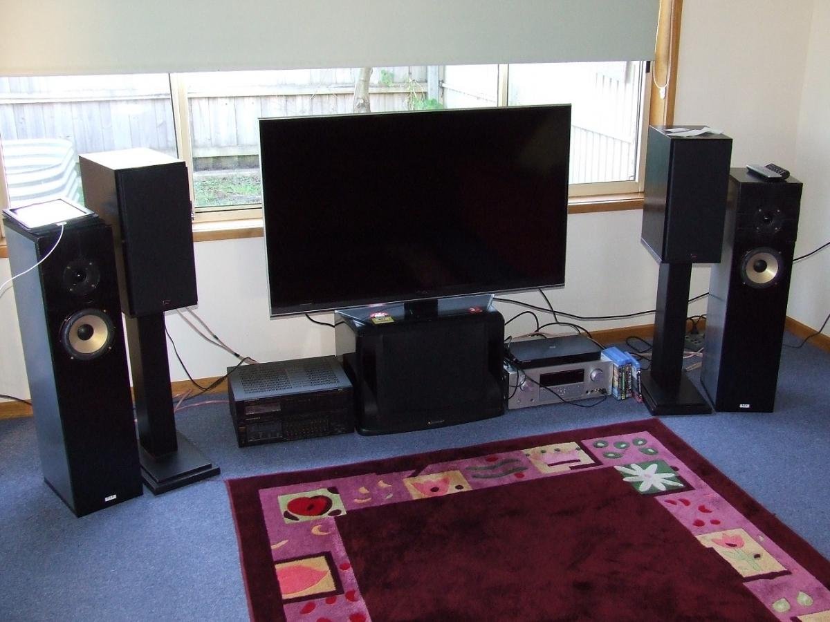

post-107081-0-29835100-1436541105_thumb.
Grilles off.
post-107081-0-08859600-1436541116_thumb.
Closeup of the speakers.
