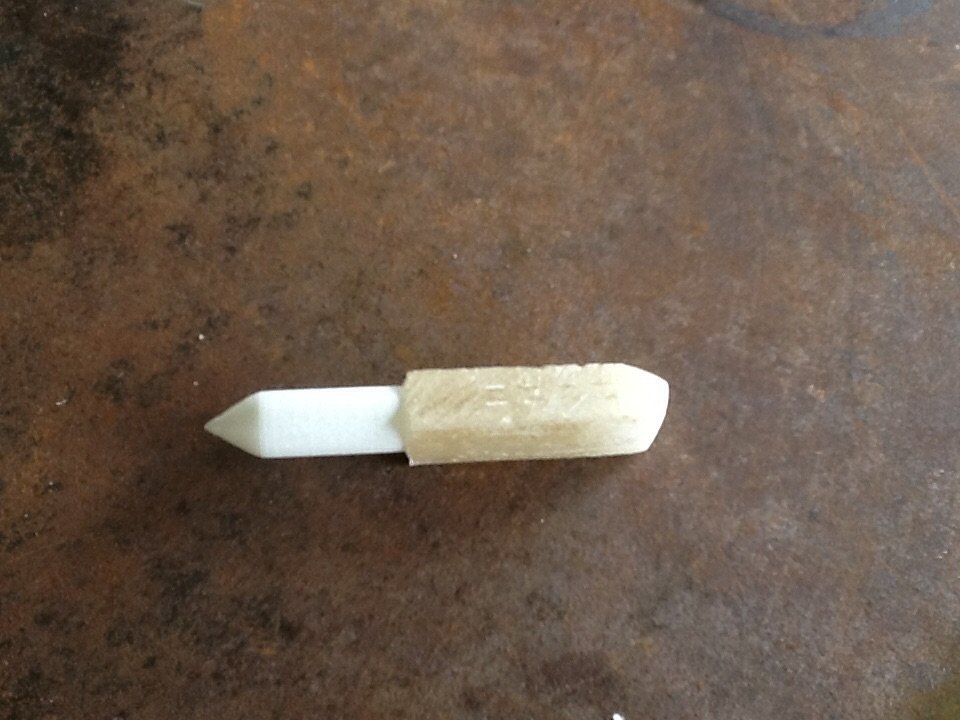

Ok, time to sharpen the chalk and get to work.

You sharpen chalk in the lathe? Nice! :-)
Yep :lol:
