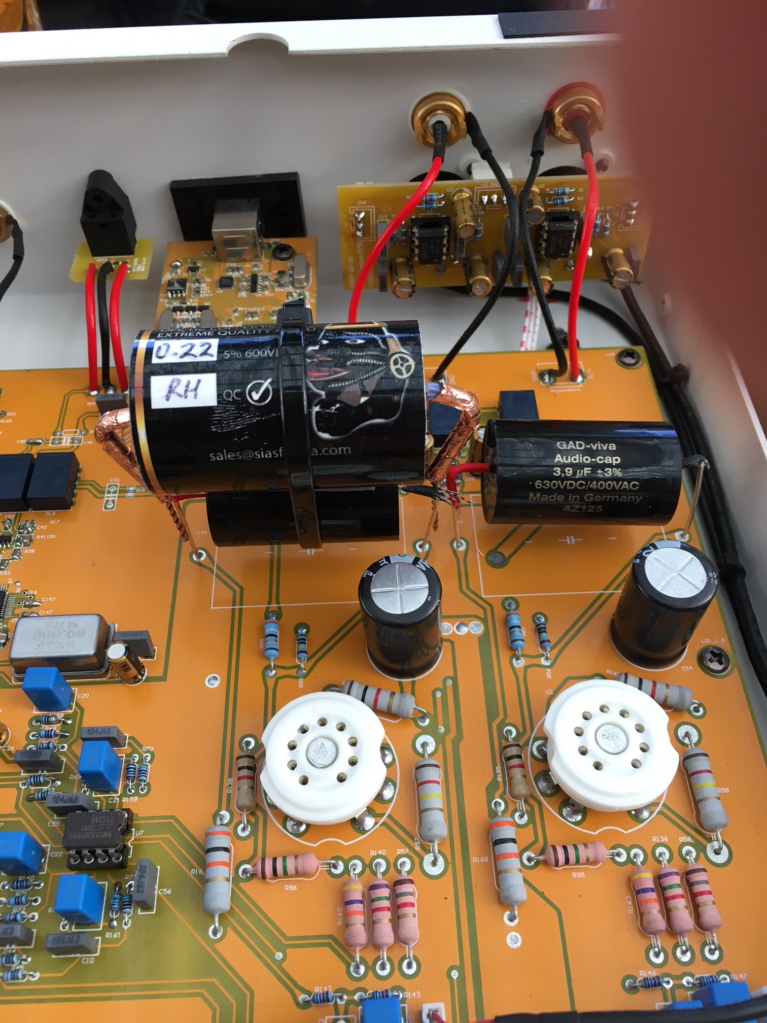

muznuts Posted August 13, 2017 Share Posted August 13, 2017 quick add to this thread, my lm502 has only had 1 mod up until yesterday which was 2x telefunken smooth plate tubes yesterday i did my very first bit of electrical DIY work, basic, basic stuff for most but new for me so i had detailed custom written instructions from the supplier of the parts 1. different tubes, NOS Radiotron 12BH7 and 6X4 rectifier, bit of an experiment as the telefunken are very nice 2. i soldered new caps onto existing, piggyback style, 4 in total, the 2 bigger black ones pictured and 2 smaller white (power) ones, excuse the tech. jargon i understand caps need burn-in time like everything else but first impressions are very positive indeed, if its gets better from here then i will be mighty happy, potentially a massive return for little investment 4 Link to comment Share on other sites More sharing options...

Red MacKay Posted August 13, 2017 Share Posted August 13, 2017 I am curious - what brand are the seasfodna rebranded caps? Are they Duelands? But why put your own reseller sticker all over them and make them look like yours.... Kind of crass and BS. 1 Link to comment Share on other sites More sharing options...
muznuts Posted August 13, 2017 Share Posted August 13, 2017 8 hours ago, Red MacKay said: I am curious - what brand are the seasfodna rebranded caps? Are they Duelands? But why put your own reseller sticker all over them and make them look like yours.... Kind of crass and BS. Not Duelands, not rebranded anything, they are Sias Fodna own brand sorry i dont know much about them but i will find out more and post if you like? i know they have been in development for years and these first production ones are very new for the guys involved, so i guess some final testing going on i trust the guy i know 100% with anything electronic so when he said put them in your dac let me know what you think.... i did Link to comment Share on other sites More sharing options...

Bronal Posted February 3, 2023 Share Posted February 3, 2023 Does anyone have a complete list of the capacitor upgrades for the LM-502CA? In particular, I'm having trouble sourcing replacements for the large capacitors. They are 3.9uF 630VDC/400VAC. I'd like to use Mundorfs, but the nearest match I can get is 3.9uF 600VDC/410VAC. Does this matter? Link to comment Share on other sites More sharing options...
muon* Posted February 3, 2023 Share Posted February 3, 2023 37 minutes ago, Bronal said: Does anyone have a complete list of the capacitor upgrades for the LM-502CA? In particular, I'm having trouble sourcing replacements for the large capacitors. They are 3.9uF 630VDC/400VAC. I'd like to use Mundorfs, but the nearest match I can get is 3.9uF 600VDC/410VAC. Does this matter? 600VDC/410VAC should be fine, I doubt they will see anywhere near that voltage as output caps following a tube buffer stage. If they are the ones in question. Link to comment Share on other sites More sharing options...
Cloth Ears Posted February 3, 2023 Share Posted February 3, 2023 48 minutes ago, Bronal said: Does anyone have a complete list of the capacitor upgrades for the LM-502CA? In particular, I'm having trouble sourcing replacements for the large capacitors. They are 3.9uF 630VDC/400VAC. I'd like to use Mundorfs, but the nearest match I can get is 3.9uF 600VDC/410VAC. Does this matter? 5 minutes ago, muon* said: 600VDC/410VAC should be fine, I doubt they will see anywhere near that voltage as output caps following a tube buffer stage. If they are the ones in question. Who will be doing the replacement of the caps? Link to comment Share on other sites More sharing options...
