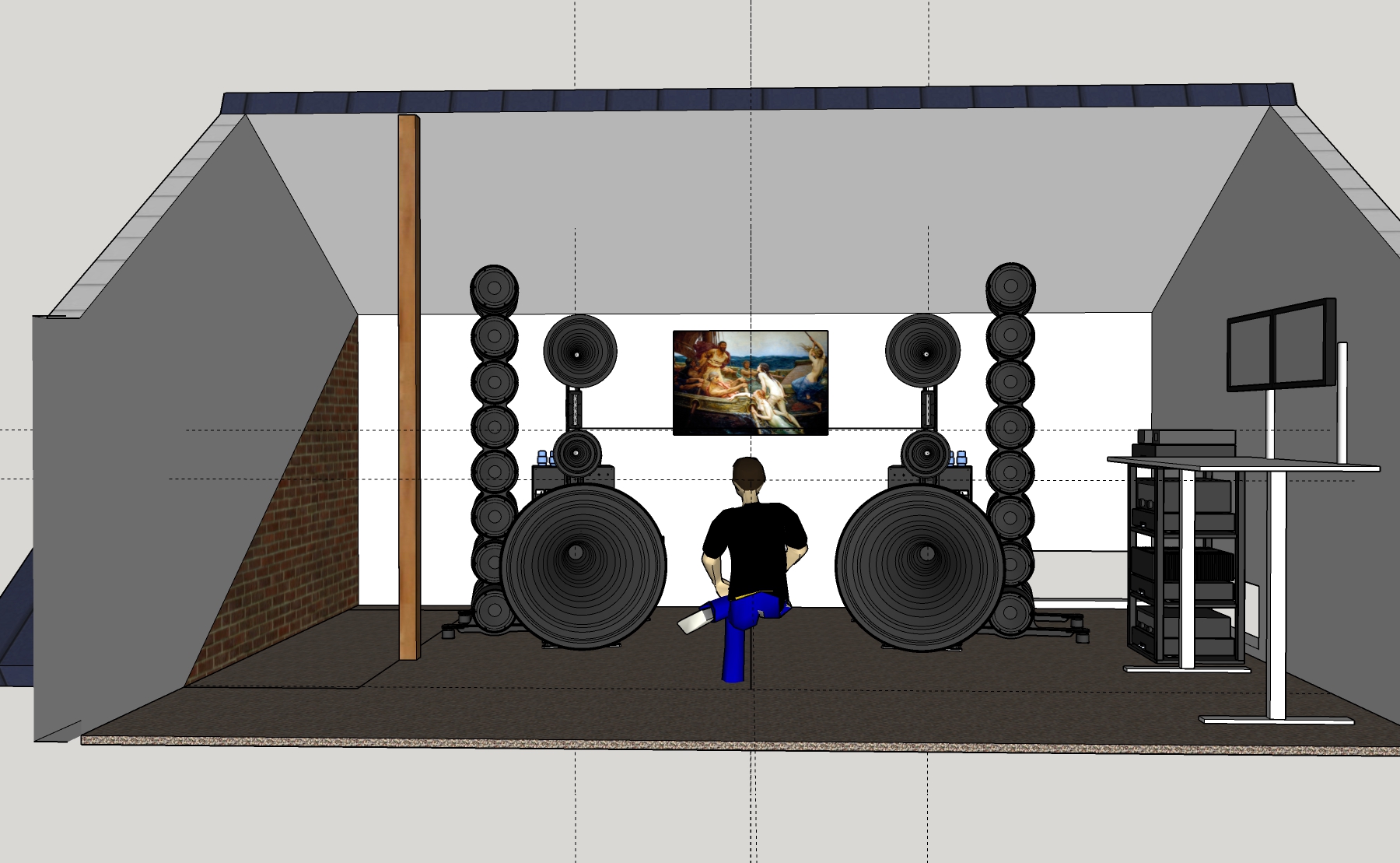

Time to think about a midbass channel circa 40/50Hz to 100Hz/140Hz.  The more I think about this the more I not only want it but the more it is likely required.
I've got room mode problems at 40Hz, 51Hz, 55Hz, 117Hz and 139Hz.  The higher two I should be able to allay with further room treatment but the lower few are more difficult and may not be able to be solved with bass traps.  The best option I see is a midbass channel runing from the lower modes up to the lower knee of the upperbass horn which may or may not consequentially be tuned higher to suit.
At hand I have three pair of Vitavox 15" alnico magnet, paper cone drivers that are either brand new or remagnetised/reconed: 2 new K15/40; two older K15/40; two older AK150.  The AK150 are Fs = 35Hz and K15/40 are Fs= 45Hz.  These are magnificent sounding drivers and have been used in everything from bass horns to sealed and vented speakers.  One of my old pair were previously used for PA as guitar speakers.  They aren't the best candidates for a sealed box but I do intend to try them that way myself.
@davewantsmooreand I have been chatting/ranting privately about all kinds of things midbass and bass in general and one of the things that came up, not necessarily in regards to my playback, was open baffle midbass.  I don't know too much about it to be honest having never been enamoured with any open baffle system I have heard and therefore never bothered to follow it up in any non-cursory way, but technically at least it may be a good fit here due to its directionality which may be very useful in terms of spraying less bass energy into places it does not need to be.  I've got no clue if these Vitavox drivers are any sort of prospect for OB midbass, nor if OB Midbass could really be a useful solution for my playback, but I think it is worth investigating.
Immediate intention, though, is to play with some sealed midbass and knock up some rough and ready mdf boxes and see what sort of in-room response I can get from the 15"ers.  It could be a close-run thing as to whether I have enough volume from a single driver to match the Bass Cannons and Upperbass Horns, but I can easily throw up a second or third driver to accommodate.
There are three potential locations for the midbass channel.  First, the room as it is right now...
Midbass Option #1...a single driver on top of the horn stack...
Midbass option #2...a single or pair of drivers inside the stack at floor level...
Midbass Option #3...a single or pair or trio of drivers hooked on the outside of the horn stack...
I could even split a pair with each in any two of the three locations, which could be the best method to even out the room bass response.  There is some flexibility there for midbass at different heights and in different parts of the room.  For example, a trio could look like this...
In terms of open baffle midbass, according to my cursory knowledge I think that Option #1 may be most suitable, but I don't know enough.  I'll have to do some reading to figure some of this stuff out.
The DSET amplifiers have a spare channel ready and waiting for midbass.

Well, I've done some quick room mode/speaker position calcs and from what I can tell the most useful midbass position (in terms of mitigation of the effects of room modes) is on top of the horn stack where it has the potential to really help the 51Hz and 55Hz modes in particular.  On the floor between the horns is also useful, particularly when paired with absorption on the side walls.  These 51Hz/55Hz modes can be attenuated using only bass absorption on the side walls, but midbass channel position looks to be able to do a fair bit of the heavy lifting by itself.
I also had a look at the big 40Hz mode and it may just be treatable with bass traps (VPR's) on the front wall in addition to the big soft and fluffy trap and windows already at the back of the room, so I am a little less worried about that one now, although I will have to build VPR's that work at 40Hz.
Ceiling treatment looks like it will only be needed for above 120Hz or so which is doable.

I do understand this perspective but the lowest amplifier channel has been specialised for the 1 ohm load that the Bass Cannons present.  It will still be great for midbass duties but then I doubt I would be able to find a sub speaker solution to suit the next amplifier channel which I can rewire for an 8 ohm or 16 ohm load but still only have 8 watts.  Overall, it might be easier to investigate the midbass channel with the Vitavox woofers because they should have the frequency range necessary to also work with the problem room modes.
It might be a dead end, but this was knocked up in a couple of hours after work this afternoon...
It is as rough as guts but should be good for assessing the potential of a midbass channel.  The second cabinet has been cut...I just need to glue it up in the morning.
This looks quite small.
The small box, coupled with the strong motor is going to give you a very sloping response through your intended passband  (ie. no bass) .... just something to be aware of if you're doing a listening test with no correction.
