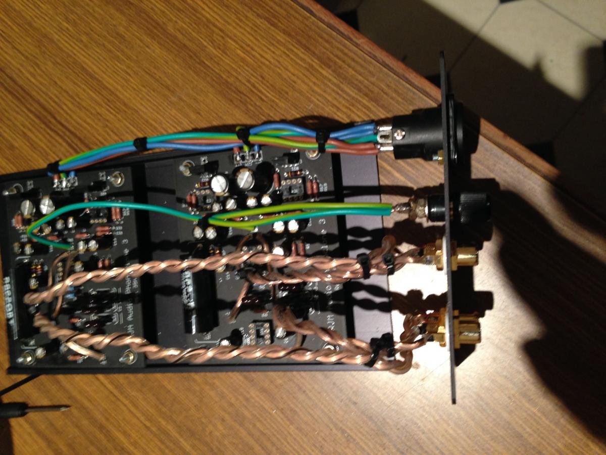

bassman Posted February 17, 2015 Author Posted February 17, 2015 Been very slack here is a up date on project . Power supply parts should arrive soon to finish the build . 1

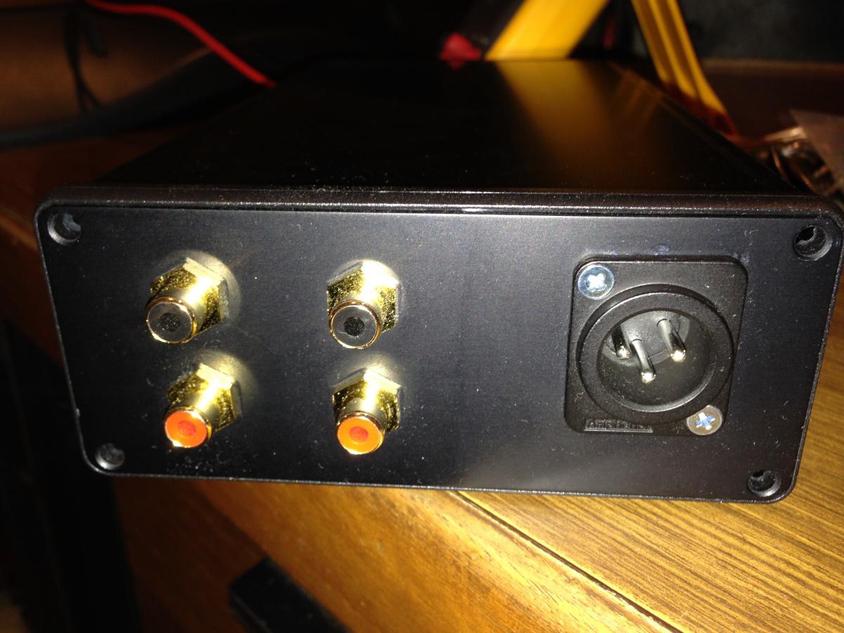

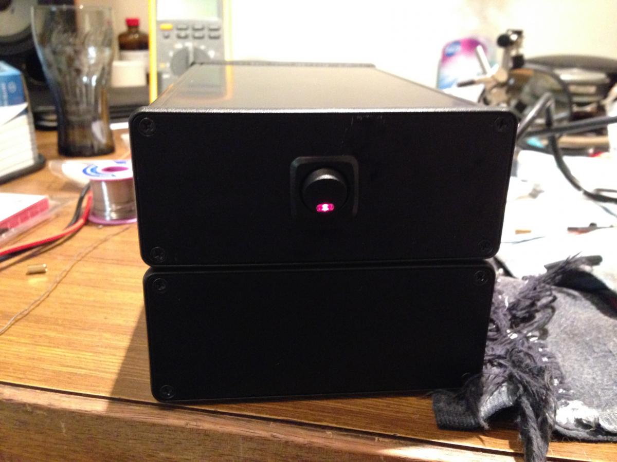

bassman Posted March 2, 2015 Author Posted March 2, 2015 Phono clone finished . Power supply next just waiting on case to put together . 2
bassman Posted March 5, 2015 Author Posted March 5, 2015 So how does it sound ? WOW it's awsome huge soundstage, deep bass, smooth extended top end, dead quiet, better then any inbuilt phono stage I own . I wonder how it compares with other high end or diy stages ? Peter 2
