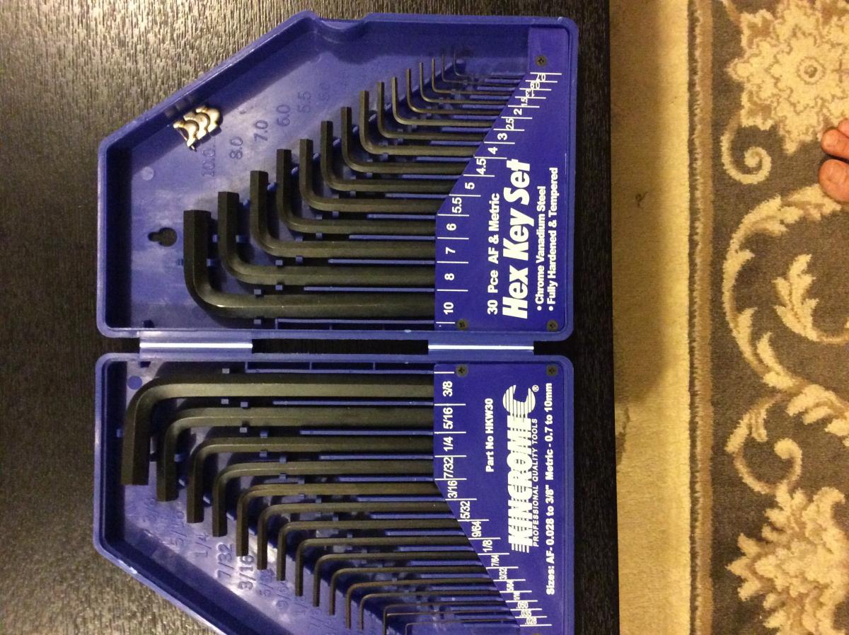

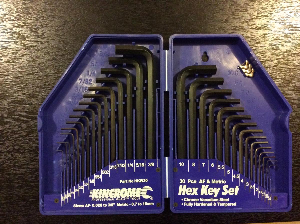

In my line of work I have to use Allen screws all day long and the smaller sizes are rubbish because they strip out far too easily. Torx are far superior because it is almost impossible for them to strip. I have never stripped one yet. I wish they were used more.
There are couple of reasons Allen keys strip,
Over tightened with locktite,
Or the they are crappy set that aren't made to spec so they round themselves out. The above kincrome set is work issued and I have never stripped one with this set no matter how tiny it is.

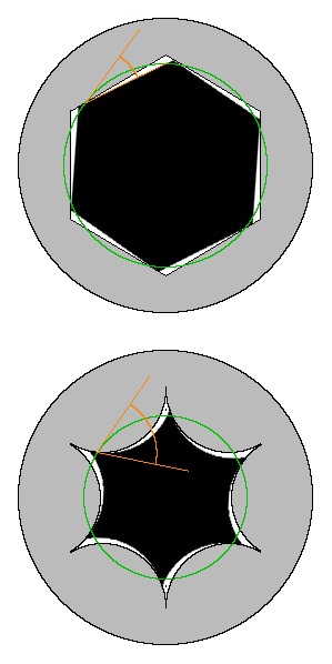

This is the difference between an Allen key hex and a Torx hex
They are definitely Allen key hex type screws.
I even had to get a second opinion from a good friend (who is employed in the metal trade industry)because I thought my eyesight was failing me!

Where are you in Victoria, I have all the Allen keys you need. There are Allen keys and there are the cheap crap but this set just about covers everything.
