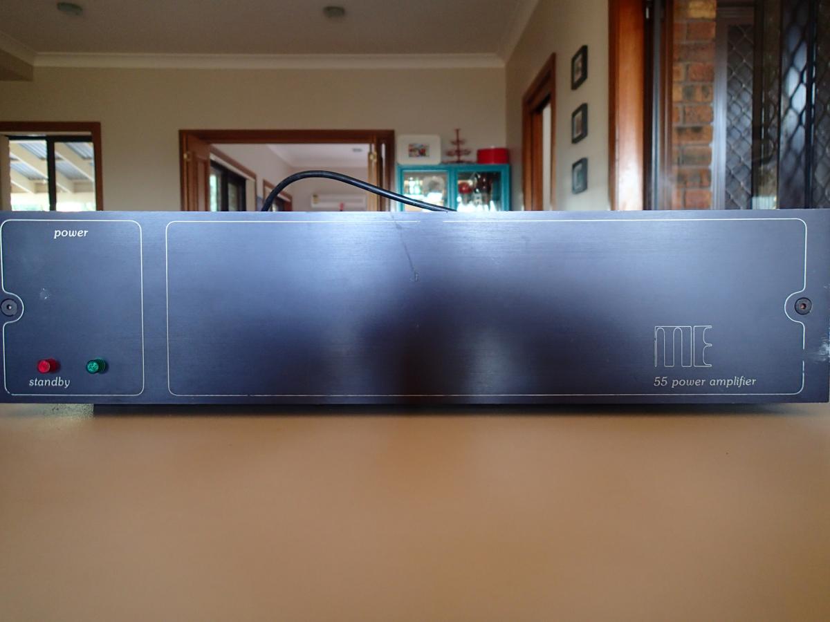

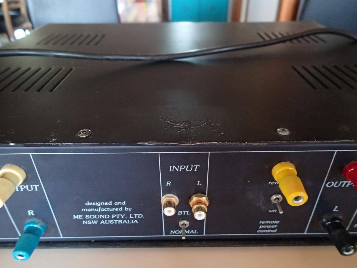

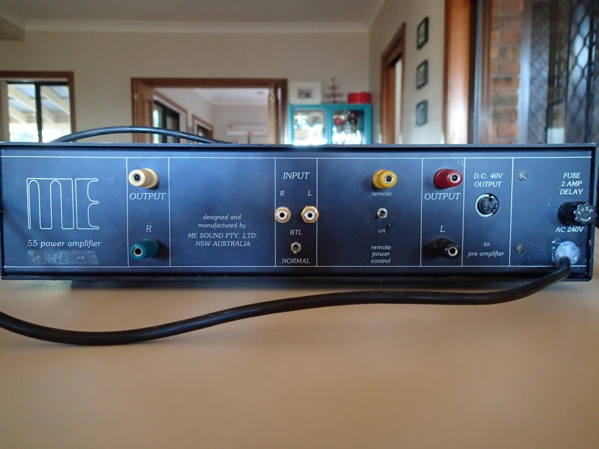

Item Condition: A few scratches and dings toward the back of the chassis and one on the faceplate, as shown in the photos

Extra Info: Amplifier has had its input impedance raised to enable it to be used with most pre-amps, the out-of-phase output stage reversed to improve imaging and bias corrected. Work carried out by  ME qualified tech (forum member Zaph)
