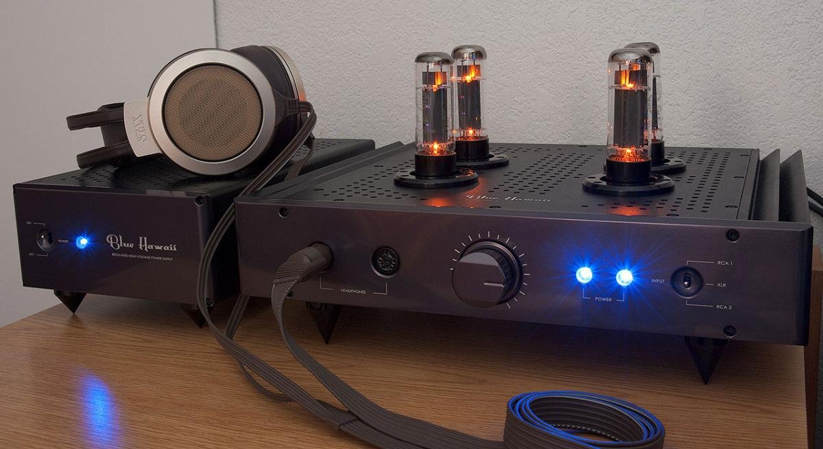

Guest yamaha_man Posted March 18, 2014 Posted March 18, 2014 I always had the opposite problem, my phones never sounded as good as my system. I had AKG-702's and AT W-5000's, a decent system blows phones away.
Guest kab Posted March 18, 2014 Posted March 18, 2014 I always had the opposite problem, my phones never sounded as good as my system. I had AKG-702's and AT W-5000's, a decent system blows phones away. Would like to try this pair.
Guest yamaha_man Posted March 18, 2014 Posted March 18, 2014 I heard a set of cans and an amp at the hifi show in Melbourne, it came close to the sound I'm accustomed to. I enquired about the price, 20k was the answer, for that price I was more inclined to listen to the Sasha's I had at the time.
