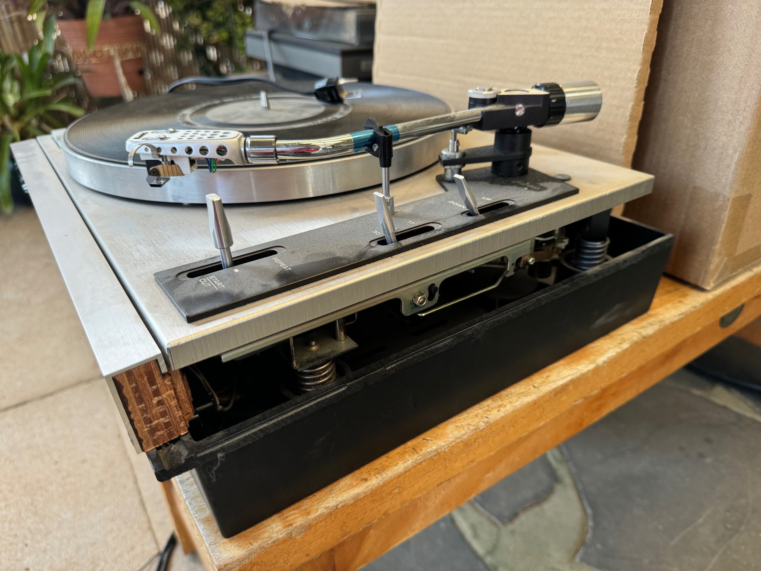

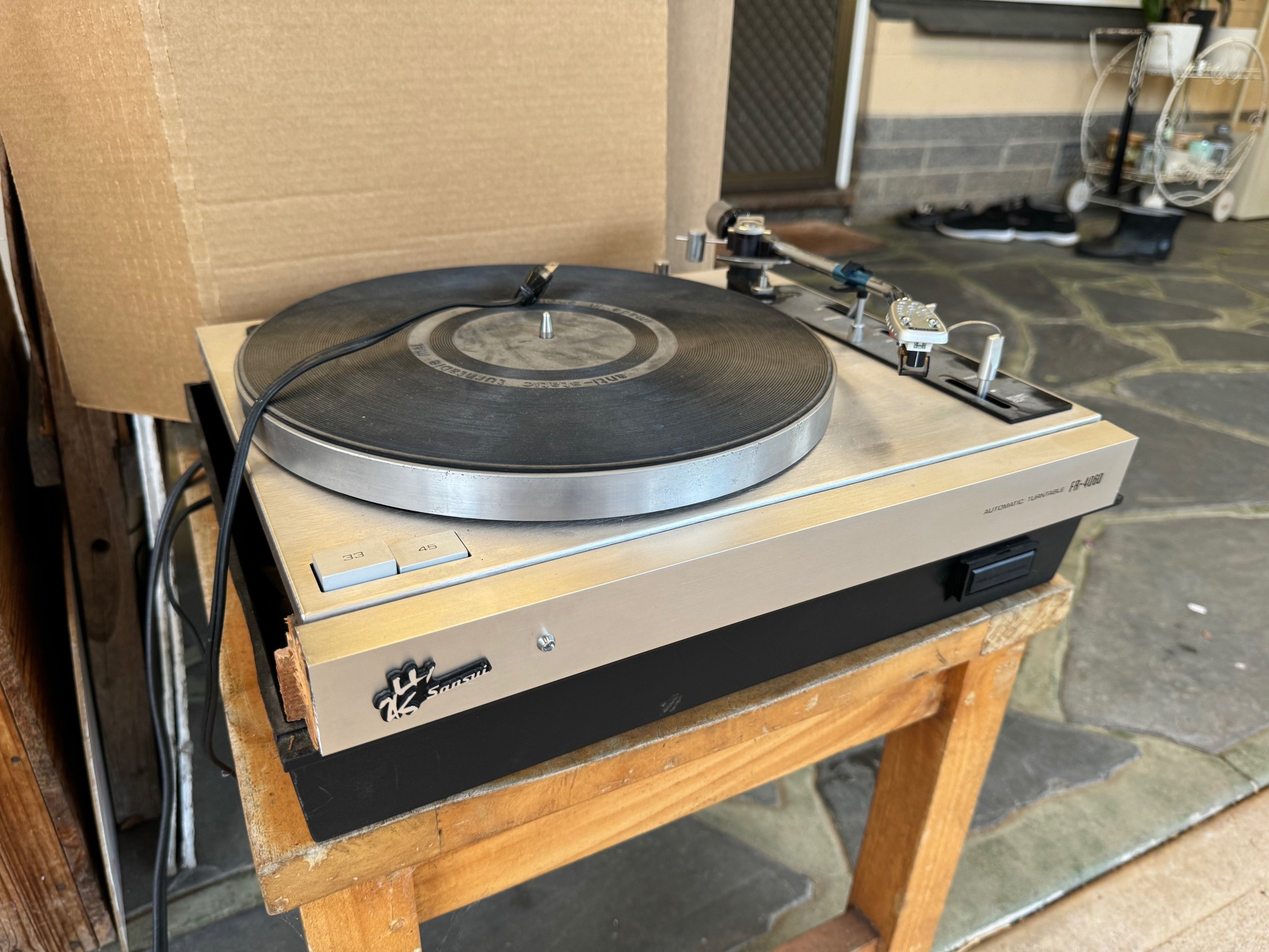

I picked up this turntable a few months ago in a sorry state, but the price was right so I couldn’t leave it behind.
It needed a new belt and some cleaning/lubrication but has come up nicely so far.
Sadly the original owner had butchered this one by crudely cutting off the wood plinth surround/facia/frame. I guess to fit inside a cabinet?
I’m looking at recreating the missing frame. I’d like it to be close-enough in dimensions to the original that if I am ever to source a donor dust cover, it will sit nicely.
So with that said, if anyone here has one of these units and is willing to take some measurements I would remain forever grateful.

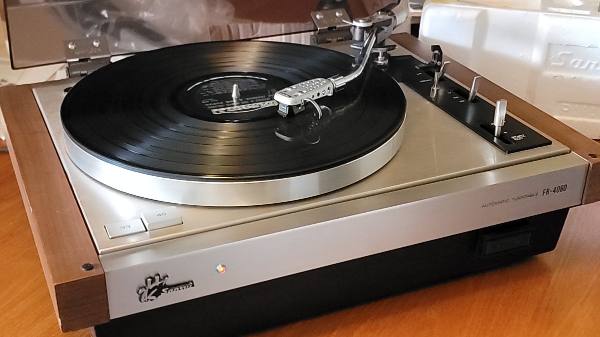

Here’s what it’s supposed to look like:

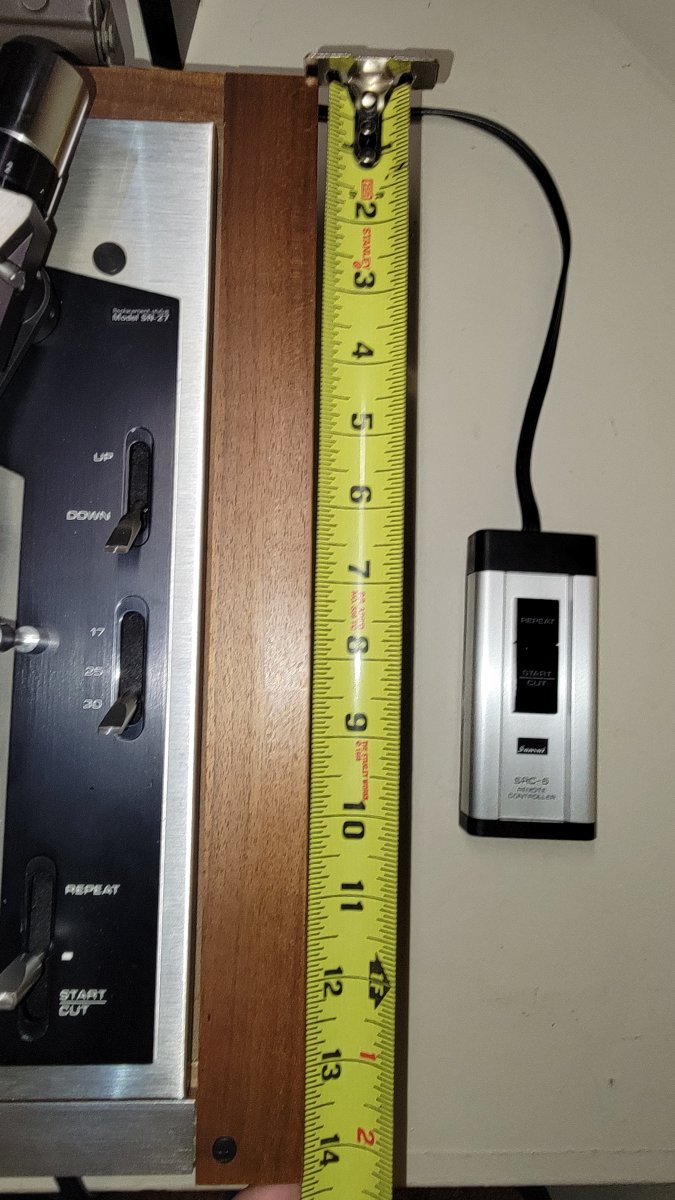

I just joined this platform but I've run across your post before. I also have a FR-4060 which came from an online auction last summer and was lucky enough to also get just about everything else that may have come with the Sansui back in the 70's (including the wired remote)
Let me know if you are still looking for info

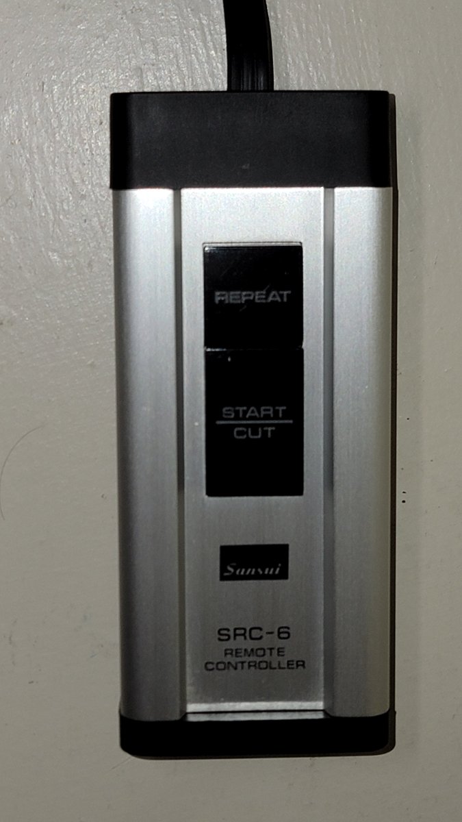

The remote is wired and it operates the automatic functions of the turntable electronically. I can cue, cut, and repeat using only the remote.
I use the remote controller to cue the records which I find helpful due to the FR-4060 floating on springs within the chassis. The platform can be springy! I'll take a video and post the remote controller in action.

The SRC-6 remote controller has a 3 meter long cable which is long enough to use from virtually any spot inside of a 1970's sized living room!
Attached are a couple photos
