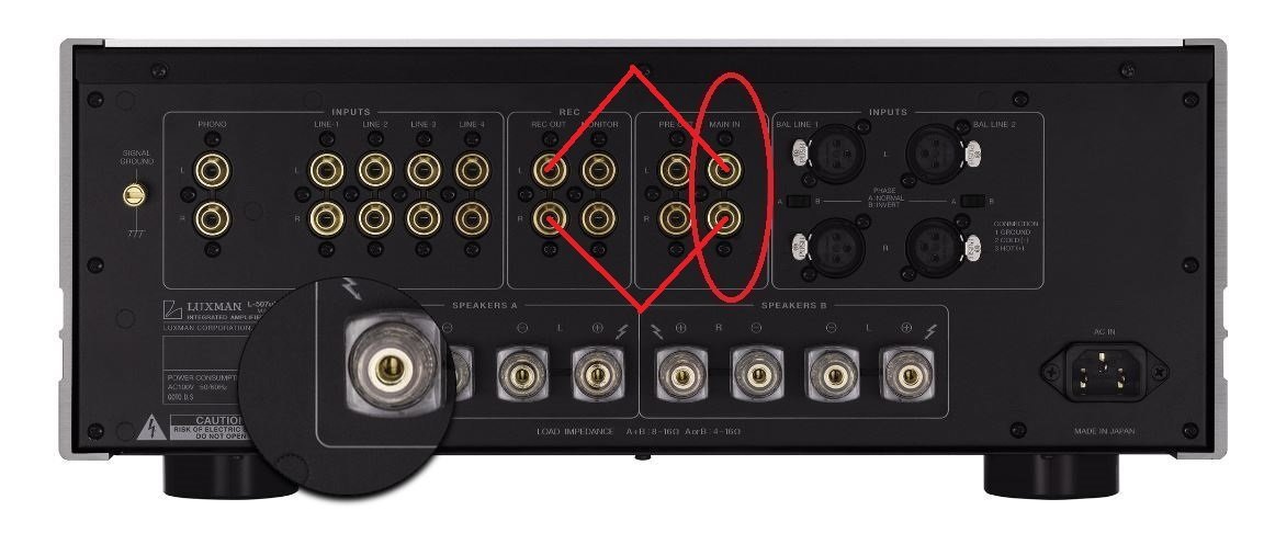

georgehifi Posted February 18 Posted February 18 (edited) On 16/02/2025 at 1:45 PM, craig.g said: 1 of my amps has a feature where you can trim input gain I looked at both your Esoteric and Luxman they only have active preamp volume controls. Only the Esoteric has power amp inputs but no passive level trim controls for the poweramp section. What I would try with your source/s that have digital domain volume control, is to feed the L&R output of them into the Luxman's "poweramp inputs" (attached circled in red) and use the sources volume control, just make sure the sources volume is at 0 when you turn it all on. NB: The golden rule going direct is switch source on first and Esoteric on last. And opposite when turning off. Cheers George Edited February 18 by georgehifi

georgehifi Posted February 18 Posted February 18 (edited) If you find that sounds the best (which it should), I think you can do this to keep multiple sources switching also as it by-passes the active preamp and volume control. (someone can correct this if I'm wrong as I'm not an integrated user with all the tape in/out/monitoring switching) Take the tape outputs to the poweramp inputs with a pair of short rca's, then you can use all your Lux switchable source inputs if they have volume controls on them. Cheers George Edited February 18 by georgehifi
