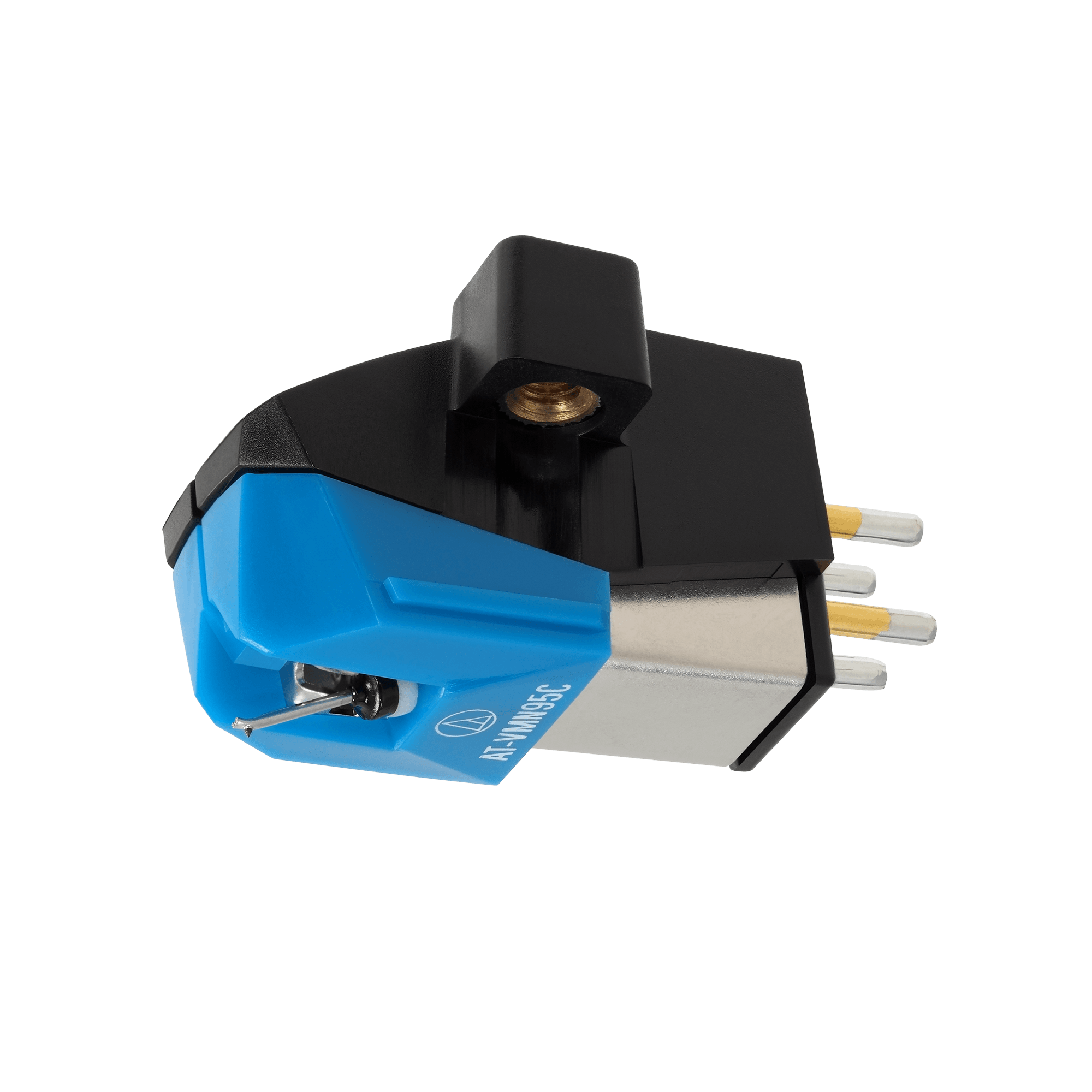

Darryl Posted February 13 Posted February 13 Maybe something with a conical stylus which won't be as sensitive to set up as some others. With the Audio Technica range you can always upgrade the stylus later on, maybe for a birthday present? https://www.audio-technica.com/en-au/at-vm95c 3
